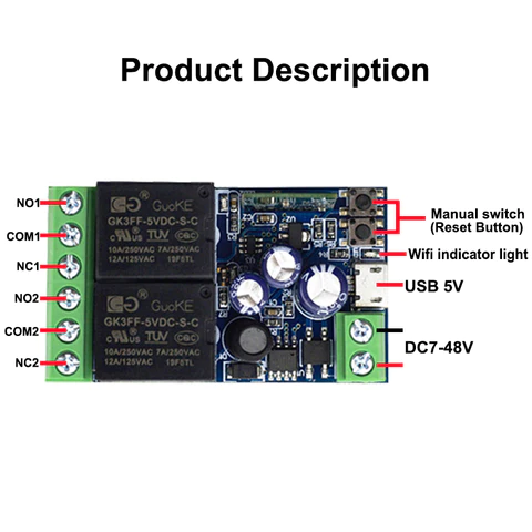

    QIACHIP KR0548-2CH-W (SM-028_V1.3 BL602L20)
    There are even more results here, it's a bit easier to find this product under "KR0548-2CH-W". Even on the Qihip website:
    [BL602] IoT relay series on BL602, SM-028_V1.3, KR0548-2CH-W, KR05-1CH
    Other portal:
    Photo of what it looks like in reality, from the user:
    Roles of individual pins (for use with OpenBeken):
    Btn(1) -> GPIO_20 (B)
    Rel(1) -> GPIO_21 (C)
    Btn(2) -> GPIO_4 (A)
    Rel(2) -> GPIO_17 (17)
    WifiLED_n -> GPIO_14 (G)
