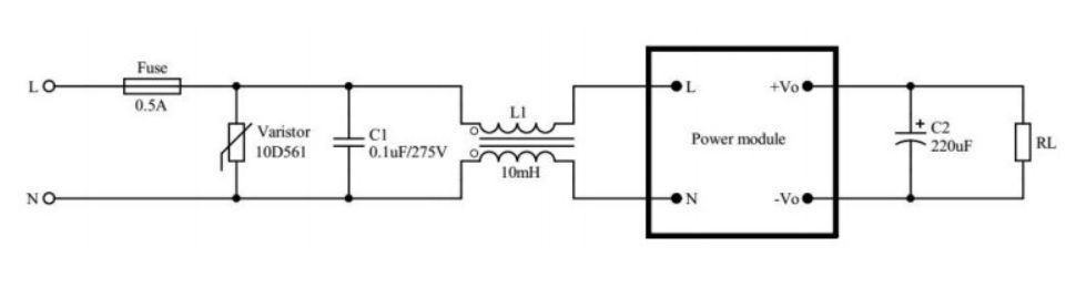

    mtbchn wrote:
    Of course, I assume that in both cases I add a pair of filter capacitors at the input.
    If I do, it's ceramic, against interference. Adding electrolytic capacitors is pointless.
    Can you elaborate on the omission of electrolytic capacitors? I was planning to use a pair of 220 uF and 100 nF at the HLK-PM output. I took the following application diagram as a reference:
    Connection diagram with fuse, varistor, capacitor, inductor, and power module
    And one more question. If I had a bare ESP8266, I would use at least one 100 nF capacitor as close as possible to the uC power supply leg. Here I have a D1 Mini board available, so is there therefore any point in adding this capacitor at the 3.3 V goldpin of the Wemos?
