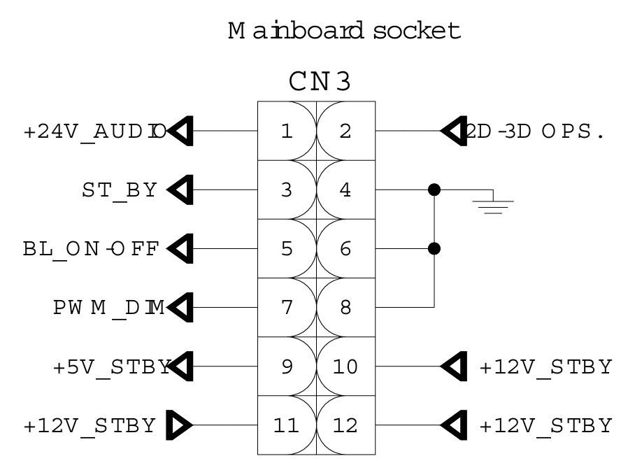

    Hello, I need help with a Starlight 43DM7500 with a HK.T.RT2861V09 mainboard, BOE HV430QUB-H11 tcon/screen, and a Megmeet MP5055‐85V700 PSU. The issue is that the PSU is faulty and someone has unsuccessfully tried to repair it. There are burn marks near one mosfet on the primary side; on the same place on the back of the board, there is some SMD component removed. Also, three diodes in the secondary are short. Basically, rendering it hopeless for repair. So now, I am stuck between two options. One is to provide the mainboard with 12 volts and 5 volts on the respective wires with a computer PSU (no 24 volts) and powering the backlights separately. The other option is to use a Vestel combo board - 17IPS72 and 17MB130P for a 43', 4K panel but LGDisplay, not BOE. Which one is better, are both safe, and are there any other options I have not considered? Thanks in advance! @ElektrodaBot
    AI: Can you post clear photos or the pinout/labels of the MP5055-85V700 PSU connectors, especially the wires going to the HK.T.RT2861V09 mainboard and backlight connector? Need to know if there are STB/PS_ON/BL_ON/DIM/PWM signals and the exact 5V/12V rails.
    Here are the connectors: 1: V12, V12, GND, GND, GND, V5, V5, STB, PS-ON, V5, V5, GND, GND. 2: GND, GND, V24, V24. 3: GND, GND, ADJ, BK. And the LED connector too, but that one can be disregarded.
    AI: Do you have the exact panel settings/firmware or donor TV model for the Vestel 17MB130P + 17IPS72 set, and can you confirm the BOE HV430QUB-H11 interface type/pinout matches the LGDisplay panel it came from?
    I believe it does match the pinout; the panel for the Vestel board originally is VES43QNDL-2D-N11.

    Your original PSU is not just a “12 V supply”. From the connector labels you posted it provides:
    ConnectorSignalsFunction
    1V12, GND, V5, STB, PS-ONMainboard supply/control
    2GND, V24Likely 24 V rail, usually audio amplifier supply on this class of TV
    3GND, ADJ, BKBacklight dimming and backlight enable control
    LED connectorLED outputHigh-voltage constant-current LED drive
    So the original supply performs four jobs: standby/main low-voltage supply, 12 V logic/panel supply, 24 V audio supply, and constant-current LED backlight drive.
    Given the primary-side burning, missing SMD part, and multiple shorted secondary diodes, I agree that repairing this exact PSU is probably not economical unless you have a donor board or full schematic. More importantly, before installing any replacement supply, check that the mainboard, panel/T-CON and LED strips are not shorted, otherwise the replacement can fail immediately.
    Direct answer to the question
    Best option: find an exact or very close replacement for the original Megmeet MP5055-85V700, or a donor PSU from the same chassis/TV family.
    Second-best option: transplant the Vestel set, i.e. 17IPS72 + 17MB130P, but only after confirming the BOE panel interface, panel voltage, firmware/profile and LED current.
    Worst option for permanent use: powering the original HK.T.RT2861V09 from a PC ATX PSU and using a separate LED driver. It is acceptable for a bench test, but I would not recommend it as a closed-case permanent repair unless rebuilt with proper fusing, isolation, standby sequencing, mechanical mounting and a correctly rated constant-current LED driver.
    So, between your two proposed options: the Vestel transplant is the better and safer permanent solution, but it has a real risk of panel firmware/backlight mismatch. The ATX PSU solution is simpler for testing the original mainboard but is the least professional and least safe as a final repair.

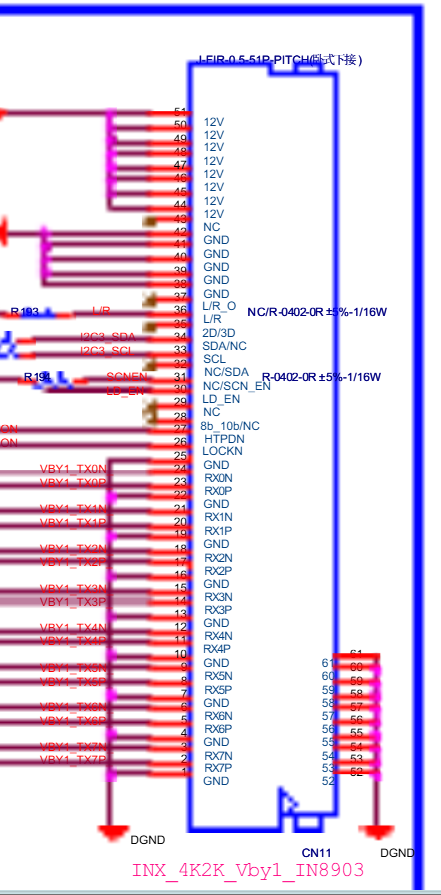

    2. Option 2: Vestel 17IPS72 + 17MB130P transplant
    This is a cleaner hardware solution because the 17IPS72 already provides the TV-style PSU rails and integrated LED driver, and the 17MB130P is a complete TV mainboard. The 17IPS72 is commonly used with 43-inch Vestel UHD sets and is listed with 17MB130/17MB130P and VES430QNDL-type panels. (piese-servicelcd.ro)
    However, this option has two serious compatibility areas: panel interface/firmware and backlight current.

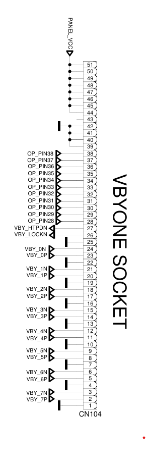

    Panel interface
    The BOE HV430QUB-H11 is listed as a 43-inch panel using V-by-One, 8 lanes. (revo.tech) Closely related BOE HV430QUB variants are commonly 51-pin, 12 V V-by-One panels, but you should not assume pinout identity without checking the actual H11 datasheet or measuring the panel cable/power pins. (panelook.com)
    The donor Vestel panel code VES43QNDL-2D-N11 / VES430QNDL-2D-N11 is a 43-inch UHD Vestel panel code, but that does not automatically mean it is electrically identical to your BOE panel. Vestel uses many panel profiles under the same board family, and firmware/profile matching is important on 17MB130 boards. (elektroda.com)
    Before connecting the BOE panel to the Vestel mainboard, verify:
    - V-by-One connector pin count.
    - Pin 1 orientation.
    - Panel supply voltage: should be 12 V, not 5 V.
    - 12 V pins and GND pins are in the same positions.
    - No 12 V pin from the Vestel cable lands on a signal pin of the BOE panel.
    - Lane count and cable type are compatible.
    - T-CON fuse on the BOE panel is not shorted.
    A V-by-One connector can physically fit and still be wrong enough to damage the T-CON.

    asenikonomov301 wrote:
    https://obrazki.elektroda.pl/4477611800_1785419058.png https://obrazki.elektroda.pl/2499250700_1785419058.png
    So, I do not have access to a lab power supply, but I do have a universal power adapter ...
    Direct answer
    The pictures are good enough for a preliminary connector comparison. From what can be read, the critical V-by-One high-speed section matches very well, and the 12 V panel supply area also appears to match. This means the Vestel 17MB130P swap is not a blind gamble anymore; electrically, the panel connector looks broadly compatible.
    However, there is one important caution:
    > The lower V-by-One lanes and the main 12 V/GND pins appear compatible, but the option/control pins around pins 28–38 need checking carefully, especially pin 38, because in your Realtek/Innolux connector drawing pin 38 appears to be GND, while in the Vestel drawing it seems to be marked as an option pin, OP_PIN38.
    That mismatch is not necessarily fatal, but I would not ignore it. If pin 38 on the BOE T-Con side is really hard-grounded and the Vestel board drives OP_PIN38 high, you could be shorting a GPIO/output line to ground. Usually that would not kill the panel, but it could stress or damage the mainboard output.
    So: yes, the Vestel swap is worth continuing, but do not connect it until you verify pin 1 orientation, power pins, grounds and the pin 38 situation with a multimeter.
    Connector comparison from the pictures
    Assuming the first picture is the Vestel 17MB130P CN104 V-by-One connector, and the second picture is the HK.T.RT2861V09 / Innolux-type connector, the comparison looks like this:
    Pin areaHK.T.RT2861V09 / Innolux drawingVestel 17MB130P drawingComment
    51–4412 VPANEL_VCCAppears compatible. Verify that Vestel really has 12 V here.
    43NClikely NC / unusedNot critical if truly NC.
    42–39GNDGND areaAppears compatible.
    38GND in your Realtek/Innolux drawingOP_PIN38 in Vestel drawingPotential mismatch. Check this carefully.
    37–28L/R, 2D/3D, SDA/SCL, LD_EN, 8b/10b etc.OP_PIN37…OP_PIN28Electrically low-speed option/control pins. May require correct panel profile.
    27HTPDNVBY_HTPDNCompatible.
    26LOCKNVBY_LOCKNCompatible.
    25GNDGNDCompatible.
    24–23RX0N/RX0PVBY_0N/VBY_0PCompatible.
    22GNDGNDCompatible.
    21–20RX1N/RX1PVBY_1N/VBY_1PCompatible.
    19GNDGNDCompatible.
    18–17RX2N/RX2PVBY_2N/VBY_2PCompatible.
    16GNDGNDCompatible.
    15–14RX3N/RX3PVBY_3N/VBY_3PCompatible.
    13GNDGNDCompatible.
    12–11RX4N/RX4PVBY_4N/VBY_4PCompatible.
    10GNDGNDCompatible.
    9–8RX5N/RX5PVBY_5N/VBY_5PCompatible.
    7GNDGNDCompatible.
    6–5RX6N/RX6PVBY_6N/VBY_6PCompatible.
    4GNDGNDCompatible.
    3–2RX7N/RX7PVBY_7N/VBY_7PCompatible.
    1GNDGNDCompatible.
    The most encouraging part is that the V-by-One lane order and polarity appear to match:
    - pin 24 = RX0N / VBY_0N,
    - pin 23 = RX0P / VBY_0P,
    - pin 21 = RX1N,
    - pin 20 = RX1P,
    - and so on down to lane 7.
    That is very good. If the lane order or polarity were different, the board would probably not lock to the T-Con.
    The main problem area: pins 28–38
    The Vestel board labels pins 28–38 as generic OP_PINxx lines. That usually means they are configurable panel option pins controlled by the firmware/panel profile.
    On the Realtek/Innolux connector, those same pins are named more explicitly:
    PinRealtek/Innolux function
    38GND
    37L/R_O
    36L/R
    352D/3D
    34SDA / NC
    33SCL
    32NC / SDA
    31NC / SCN_EN
    30LD_EN
    29NC
    288b_10b / NC
    This means the Vestel board may be able to configure those pins correctly depending on the panel profile. That is probably why the same 17MB130P hardware can be used with several different 43-inch UHD panels.

    2. Possible electrical issue at pin 38
    Pin 38 is more important because your Realtek/Innolux drawing shows it as GND, whereas the Vestel drawing appears to show OP_PIN38.
    Before connecting the panel, do this:
    1. With the BOE panel/T-Con unpowered, measure continuity from pin 38 of the panel connector to chassis/T-Con ground.
    2. If pin 38 is hard-grounded, then measure pin 38 on the Vestel board with the panel disconnected.
    3. Power the Vestel board without the panel connected and measure DC voltage on pin 38 relative to ground.
    4. If Vestel pin 38 stays at 0 V or is clearly ground, no problem.
    5. If Vestel pin 38 outputs 3.3 V, isolate pin 38 in the FFC cable.
    The simplest safe workaround is to cover conductor 38 on the FFC with a tiny strip of Kapton tape, or otherwise prevent pin 38 from contacting the Vestel connector. Since the panel has many other ground pins, losing one additional ground at pin 38 should not normally matter.
    Very important: check cable orientation
    Even if the schematic pinouts match, the physical cable can still destroy the panel if it is mirrored.
    You must verify:
    - pin 1 on Vestel CN104 goes to pin 1 on the T-Con,
    - pin 51 goes to pin 51,
    - the FFC contact side is correct,
    - you are not using a reversed cable where pin 1 becomes pin 51.
    This is critical. If the cable is reversed, the 12 V pins at 44–51 could land on ground or signal pins. That can instantly kill the T-Con or the mainboard panel power switch.
    Do not rely only on the cable shape. Check with a multimeter in continuity mode.

    Power it and check whether the board starts normally. Then measure at CN104:
    Pin groupExpected
    44–5112 V when panel power is enabled
    39–42GND
    1, 4, 7, 10, 13, 16, 19, 22, 25GND
    26LOCKN line, usually logic-level feedback
    27HTPDN line
    28–38option/control pins, usually 0 V or 3.3 V depending firmware
    If the board outputs 5 V instead of 12 V on the panel VCC pins, stop. Your BOE T-Con expects 12 V according to the connector drawing.

    Step 3: Resolve pin 38
    If BOE pin 38 is ground and Vestel pin 38 is a driven OP output, isolate pin 38.
    This is a small modification and is much safer than hoping the GPIO survives being shorted to ground.

    The Vestel 17MB130P panel connector is close enough to your BOE/Innolux-type V-by-One connector that I would proceed with the swap.
    But I would proceed in this order:
    1. Verify FFC orientation: pin 1 to pin 1.
    2. Verify 12 V pins: 44–51.
    3. Verify grounds.
    4. Investigate pin 38.
    5. Power the Vestel board without the panel and measure CN104.
    6. Connect the panel only after the measurements are correct.
    7. Treat backlight compatibility separately.

    - The V-by-One data lanes match very well.
    - The 12 V supply area appears compatible.
    - Pins 28–38 are the uncertain area.
    - Pin 38 is the only pin that looks potentially concerning from the drawings.
    - Your 12 V/2 A and 5 V/1 A adapters are usable for limited testing, but they are not a replacement for a protected lab supply.
    - For the Vestel swap, test the 17MB130P + 17IPS72 first without the panel, measure CN104, then connect the BOE panel only after confirming pinout and cable orientation.

    > The Samsung donor panel/T-Con HV430QUB-F70 appears to use a different 51-pin V-by-One pin assignment from the connector layout you previously showed for the Starlight BOE/HK.T.RT2861V09 “Innolux-type” connection.
    That means: do not connect the Samsung V-by-One cable directly to your Starlight BOE HV430QUB-H11 T-Con until the pinout is mapped.
    The Samsung donor set is real and consistent with your description: parts listings show a Samsung AU709x 43-inch set using mainboard BN96-43051E, T-Con HV430QUBF70, power supply 3IN1_KANT_SU2E_TPV_43, and panel/display TPT430WR-QUBF70.K. (lcd-onderdelen.nl) The BOE HV430QUB-F70 itself is a 43-inch UHD BOE cell with V-by-One 8-lane, 51-pin, 12 V interface, and your HV430QUB-H11 is also listed as a BOE 43-inch UHD panel with V-by-One 8-lane and 12 V VCC, so the video format family is promising. (panelook.com)
    But the connector pinout is the problem, not the general panel family.
    Direct answer
    Is the Samsung option better?
    Electrically/software-wise: potentially yes
    The Samsung mainboard was already configured to drive a BOE HV430QUB-F70/TPT430WR-QUBF70.K panel, so the chance of compatible timing, V-by-One format, color depth and firmware profile is probably better than with the Vestel board originally intended for a VES/LG Display-type configuration.
    Physically/pinout-wise: not directly
    The published HV430QUB-F70 pinout places:
    - 12 V VDD on pins 1–8
    - HTPDN on pin 25
    - LOCKN on pin 26
    - V-by-One lanes on pins 28–50
    The Starlight/HK.T.RT2861V09 “Innolux” connector you previously showed places:
    - GND at pin 1
    - V-by-One lanes on pins 2–24
    - LOCKN on pin 26
    - HTPDN on pin 27
    - 12 V on pins 44–51
    So a straight cable connection could put 12 V onto ground or signal pins. That can destroy the T-Con or the Samsung mainboard.
    Therefore my initial verdict is:

    2. The dangerous part: F70 pinout versus your H11 connector
    The HV430QUB-F70 datasheet gives the 51-pin input connector assignment. The important part is this:
    HV430QUB-F70 pinFunction
    1–8VDD, +12 V
    10–14GND
    18SDA
    19SCL
    25HTPDN
    26LOCKN
    28/29V-by-One lane 0 N/P
    31/32V-by-One lane 1 N/P
    34/35V-by-One lane 2 N/P
    37/38V-by-One lane 3 N/P
    40/41V-by-One lane 4 N/P
    43/44V-by-One lane 5 N/P
    46/47V-by-One lane 6 N/P
    49/50V-by-One lane 7 N/P
    51GND
    This is from the BOE HV430QUB-F70 specification. (panelook.com)
    Your previously posted Starlight/Realtek “Innolux” connector drawing is essentially the opposite style:
    Starlight/H11 connector areaFunction
    1GND
    2–24V-by-One lanes
    25GND
    26LOCKN
    27HTPDN
    39–42GND
    43NC
    44–5112 V
    So, although both are “51-pin V-by-One 8-lane 12 V”, they are not the same pinout.
    This is very important. “V-by-One 51-pin” is not enough. There are multiple connector conventions.
    Consequence: direct Samsung-to-H11 cable is unsafe
    If the Samsung mainboard output follows the HV430QUB-F70 convention, then a direct connection to your HV430QUB-H11 T-Con could do something like this:
    Samsung/F70 signalDirectly lands on H11-style pinResult
    12 V on pins 1–8GND/V-by-One areaPossible short or signal damage
    V-by-One lanes on pins 28–50option/GND/12 V areaNo valid image, possible damage
    HTPDN pin 25H11 pin 25 GNDWrong hot-plug signal
    LOCKN pin 26H11 pin 26 LOCKNThis one happens to match
    12 V absent from H11 pins 44–51H11 T-Con may not power correctlyNo operation

    Possible Samsung-to-H11 adapter concept
    If we later decide to pursue the Samsung board, you would need to map the Samsung/F70 nets to the H11-style T-Con pins.
    A conceptual mapping would look approximately like this:
    FunctionSamsung/F70 sideH11/Starlight side
    +12 Vpins 1–8pins 44–51
    GNDpins 10–14, 24, 27, 30, 33, 36, 39, 42, 45, 48, 51pins 1, 4, 7, 10, 13, 16, 19, 22, 25, 38–42
    HTPDNpin 25pin 27
    LOCKNpin 26pin 26
    RX0Npin 28pin 24
    RX0Ppin 29pin 23
    RX1Npin 31pin 21
    RX1Ppin 32pin 20
    RX2Npin 34pin 18
    RX2Ppin 35pin 17
    RX3Npin 37pin 15
    RX3Ppin 38pin 14
    RX4Npin 40pin 12
    RX4Ppin 41pin 11
    RX5Npin 43pin 9
    RX5Ppin 44pin 8
    RX6Npin 46pin 6
    RX6Ppin 47pin 5
    RX7Npin 49pin 3
    RX7Ppin 50pin 2
    SDApin 18probably pin 34 or 32, depending H11 T-Con variant
    SCLpin 19pin 33
    This is not yet a final wiring instruction. It is the logical net conversion based on the documents. Before making any cable, we must confirm:
    1. Samsung mainboard connector pin numbering.
    2. Whether the Samsung FFC is straight or reversed.
    3. Pin 1 orientation on both boards.
    4. The exact H11 T-Con input pinout from the actual board/manual.
    5. Whether SDA/SCL are used or optional.
    6. Whether any option pins need defined pull-ups/pull-downs.

    - confirm GND pins,
    - do not connect the H11 T-Con yet.
    4. Compare with H11 T-Con fuse
    On the Starlight H11 T-Con:
    - confirm which input pins go to the T-Con fuse,
    - these should correspond to its 12 V supply,
    - compare against your earlier manual drawing.

    > Keep the Samsung donor parts. They are valuable and may give the best final repair, but do not plug the Samsung panel cable into the Starlight BOE H11 T-Con directly.
    The Samsung option is promising because it is a BOE 43-inch UHD donor, but the F70 datasheet strongly suggests a different 51-pin pinout from your H11-style connector. That is a serious electrical mismatch.
    If you can provide photos or a typed pinout of the Samsung mainboard/T-Con connector, we can build a proper comparison table and decide whether:
    1. a clean adapter cable is feasible,
    2. the Samsung T-Con can be safely reused,
    3. the Samsung PSU can be used as a power/backlight donor for the original HK board,
    4. or whether the Vestel route remains more practical.
    Brief summary
    - Samsung donor: very promising, but not plug-and-play.
    - The Samsung panel family is closer to your BOE panel than the Vestel/LG route.
    - However, HV430QUB-F70 uses a different 51-pin V-by-One pinout from the H11/Innolux-style connector you previously showed.
    - Direct connection may destroy the T-Con/mainboard.
    - Next step: map Samsung 51-pin connector, cable orientation, 12 V pins, GND pins, HTPDN/LOCKN and V-by-One lanes before any live connection.
  • 17IPS72 PSU investigated with original mainboard

    The attached 17IPS72 CN3 pinout is very useful. It also shows one important correction: do not use a generic 17IPS72 pinout blindly. In your diagram, pin 2 is not +24 V, and pins 4, 6 and 8 are grounds, not duplicate control pins.
    Correct interpretation of your 17IPS72 CN3 connector
    From your drawing:
    17IPS72 CN3 pinSignalComment
    1+24V_AUDIOAudio amplifier supply
    22D-3D OPS.Leave unconnected for now
    3ST_BYPSU enable / standby control input
    4GNDGround
    5BL_ON-OFFBacklight enable input
    6GNDGround
    7PWM_DIMBacklight dimming input
    8GNDGround
    9+5V_STBY5 V standby output, if populated and capable
    10+12V_STBY12 V standby output
    11+12V_STBY12 V standby output
    12+12V_STBY12 V standby output
    This connector can provide almost everything the HK.T.RT2861V09 needs:
    - 5 V standby/main logic supply,
    - 12 V logic/panel supply,
    - 24 V audio supply,
    - PSU ON control,
    - backlight ON control,
    - PWM/ADJ dimming control.
    So electrically this is a much cleaner idea than using a PC PSU.
    Proposed connection map: 17IPS72 to HK.T.RT2861V09

    Important correction about the 17IPS72 CN3 pinout
    Be careful here:
    PinDo not assumeCorrect according to your drawing
    2+24 V2D-3D OPS, leave open
    4Control signalGND
    6second BL_ONGND
    8second PWM_DIMGND
    This matters because if someone follows a different 17IPS72 variant pinout and treats pins 5/6 as duplicated BL_ON or 7/8 as duplicated PWM, they would short those signals to ground.
    Use your actual board drawing and verify with a meter.

    Practical verdict
    Yes, using the 17IPS72 with the original HK.T.RT2861V09 is now the most sensible route.
    It is better than:
    - the Samsung donor,
    - the full 17MB130P transplant,
    - a PC ATX PSU conversion.
    The only real concerns are:
    1. whether the 17IPS72 +5V_STBY output is present and strong enough,
    2. whether HK V12 should be always-on or switched by PS-ON,
    3. correct interpretation of HK STB versus PS-ON,
    4. LED backlight connector/current compatibility.
    If those are handled properly, this can become a clean and safe repair.
    Brief summary
    - Use HK PS-ON → 17IPS72 CN3 pin 3 ST_BY.
    - Use HK BK → CN3 pin 5 BL_ON-OFF.
    - Use HK ADJ → CN3 pin 7 PWM_DIM.
    - Use CN3 pin 9 +5V_STBY → HK V5, but verify current capability.
    - Use CN3 pins 10/11/12 +12V_STBY → HK V12, preferably switched by PS-ON for final repair.
    - Use CN3 pin 1 +24V_AUDIO → HK V24, but connect later.
    - Leave CN3 pin 2 2D-3D OPS unconnected.
    - Leave HK STB unconnected initially.
    - Do not connect the backlight until the LED connector and current are verified.
    If you can provide a clear photo of the 17IPS72 LED connector area and LED driver section, especially the IC marking and current-sense resistors, the backlight-current part can be checked much more precisely.
The discussion concerns a Starlight 43DM7500 TV with a HK.T.RT2861V09 mainboard, BOE HV430QUB-H11 panel/T-CON, and a Megmeet MP5055-85V700 power supply that is considered beyond economical repair due to primary-side burn damage, a missing SMD part, and shorted secondary diodes. The original PSU appears to provide multiple functions: 12 V and 5 V supply, standby/control signals, a 24 V rail, and LED backlight drive. Two replacement paths are evaluated: feeding the mainboard with 12 V and 5 V from a PC ATX PSU while powering the backlight separately, or transplanting a Vestel 17IPS72 + 17MB130P combo board intended for a 43-inch 4K panel. After checking for shorts on the mainboard and confirming the T-CON fuse is intact, the Vestel option is considered more plausible, but still dependent on correct panel profile/PQ data and compatibility between BOE and LG Display panel variants.
