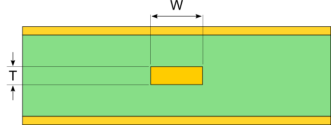

Introduction
Based on the charts found in IPC-2221, this tool calculates the width of an internal trace necessary to carry the specified current. Also calculated are the trace's temperature, resistance, voltage drop, and power dissipation.
Description
This tool, based on the formulas and graphs contained in the standard document [1], calculates the thickness of a copper printed circuit board trace required to conduct a given current, keeping the temperature increase of the trace itself below the specified input value. By providing additional input parameters (ambient temperature and trace length), it is possible to calculate the trace total temperature, resistance, voltage drop and power dissipation (power loss). Trace Width calculation First, calculate the area according to the following formula:
A = (I / (k * TRISEb))1/c                                     (I)
Then, calculate the trace width:
W = A / (T * 1.378 [mils/oz/ft2])                 (II)
Where:
A is the cross-section area [mils2], I is the maximum current [A], TRISE is the maximum desired temperature rise [°C], W is the trace width [mils], T is the trace thickness [oz/ft2], k, b and c are constants. According to IPC-2221A Par. 6.2 (“Conductive Material Requirements”), their values for inner layers are as follows: k = 0.024 b = 0.44 c = 0.725,
Equation (II) is based on a curve fit to the charts provided in [1] (par. 6.2, Figure B and Figure C).
