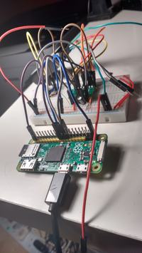

Hello colleagues.
For one projector I needed several ADC and DAC channels but unfortunately I didn't find any hat that would combine it, so I decided to make my own.
I used AD5592
The first approach was like this:
then soldered on the prototype board:
In my makerspace some people got interested in it, so I decided to make a plate:
This DIP chip is simply an optional quad op amp in a voltage follower configuration for four of the eight ports.
I also added (more as a marketing gimmick) a field for prototyping.
And release http://kck.st/2kCToFY on Kickstarter as such a tiny product, without even believing in success. But in 3 days, I was able to do 100%.

This is what it looks like from the code side (the notes in red have a marketing purpose, of course):
Just for fun, you can turn on the 5V system power supply (risking theoretically burning the raspberry), but at least it worked for me - giving me the option to measure and DAC up to 5V. But rather, I'll break it out of the plate for customers just in case.
A small self-test video below. I connected the pins like this:
And this was the result (please rewind to the end of the movie about 33 seconds, because it's an advertising film).
