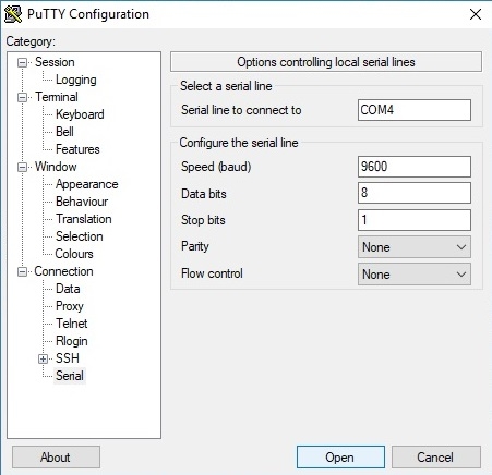

In the device manager in Windows, we have two new COM ports - in this case COM 4 and COM5. The first port must be selected - COM4. When selecting the COM5 port, no connection with the Bluetooth module will be established.
Run the "PuTTY" program and in the "SESION" category, change the connection type to "SERIAL", enter "COM4" in "SERIAL LINE" and enter 9600 in the "SPEED" window. In the "SAVED SESSIONS" place, enter the name of your choice and press " SAVE ".
The next time we connect, we will be able to load our saved settings by selecting them and pressing "LOAD".
Now we go to the CONNECTION / SERIAL category and here we set our COM port.
Now click the "OPEN" button.
From now on, everything we enter in the terminal window will be sent wirelessly to the HC-05 module and will be sent back from it (thanks to the shorting of the Rx line with the Tx) wirelessly to the computer and it will appear in our terminal window.

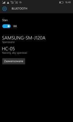

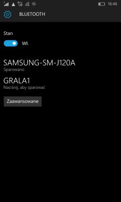

Thanks to AT commands support, we can e.g. change the module name, baud rate or e.g. pairing password.
We can get to the command handling in two ways by sending the signal to the PIO11 pin high - 3.3V. In our adapter, we have a button at our disposal which, when pressed, gives high status to pin PIO11, i.e. pin 34 of the HC-05 module.
The first way is to press the button while the module has been and is still powered. Then the baud rate should be 9600bps, unless we changed it before.
The second way is to press the button and then apply the power. With this method, the transmission speed is 38400bps and does not depend in any way on what was previously set.
In both methods, remember that when using AT commands on pin 34, the state of the high state all the time, i.e. you have to keep the button on the adapter pressed all the time. Releasing the button may result in a lack of correct responses to entering commands.
Only uppercase letters should be used when using AT commands.
Below is shown changing the name of the module by entering the command AT + NAME = GRALA1
After correctly entering the AT command, the module should respond with the text "OK".
