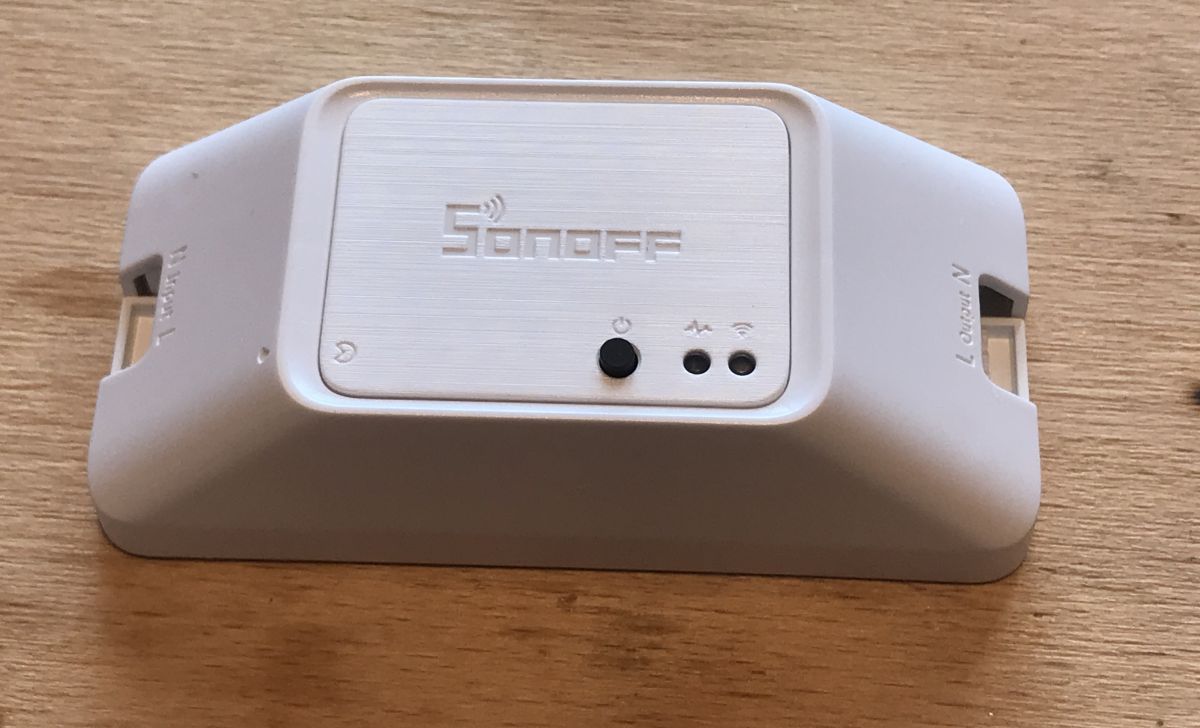

The product has two LEDs, one indicating pairing status the other operating status:
The housing is solid and double-layered, in addition, the screw terminals are far inside the housing, this I can already call a big plus:
The red LED indicates On/Off status:
A short press of the button toggles the relay, a long press turns on pairing with the hub.

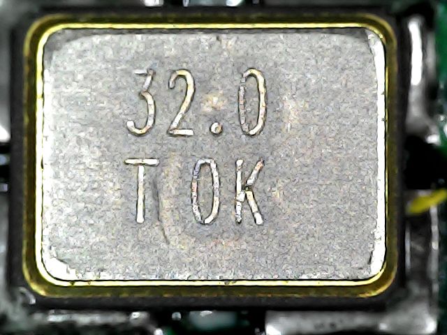

Around it we see a 32MHz clock generator (or resonator):
