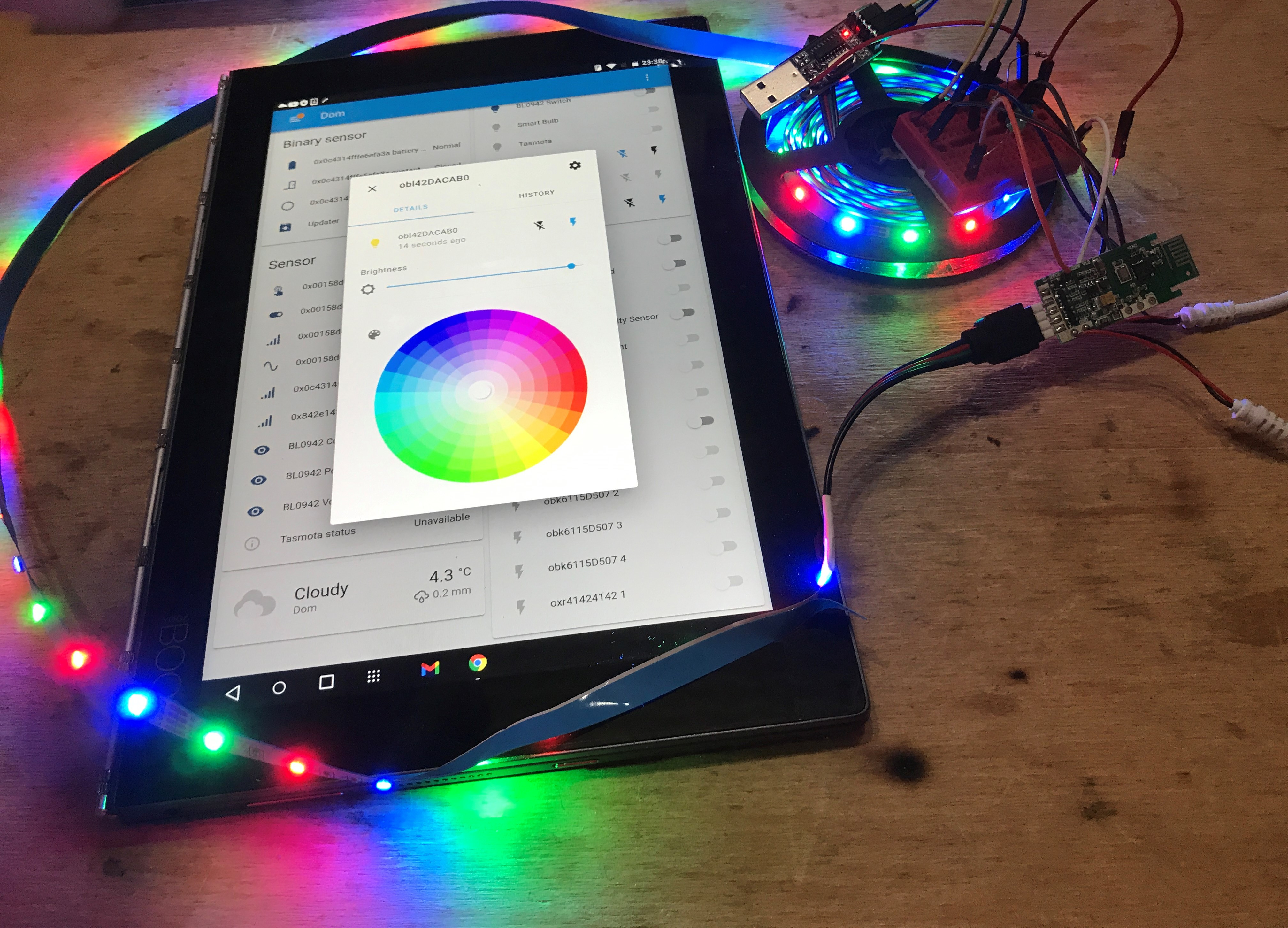

I will present here my Tasmota replacement designed for the BL602 platform by Bouffalo Lab, offering, among others. the ability to pair our device with Home Assistant via MQTT. I will show here how you can easily upload the batch to the BL602 using a simple USB to UART converter, and I will also describe the SDK compilation process for people who would like to program this platform on their own. In addition, I will present two interesting demos from SDK BL602.

It served as a testing ground for me RGB LED strip with IR remote control and WiFi - MWIR-RGB Magic Home Pro .

After restarting the device, an open Access Point with a name like OpenBL602_1A1B2C3D4E5 should appear:
Screenshot of the Wi-Fi network menu on a Windows computer.
We connect to it and open the page with the address 192.168.4.1. We configure it just like Tasmota (we give the directions for our WiFi, we set the roles of pins, we give the directions for MQTT ...
For this particular RGB LED strip, the roles of the pins are as follows:
Screenshot of OpenBL602 interface with a channel configuration form.
In the current version, my firmware does not support the IR remote that has this bar.
For the user - pairing with Home Assistant
There is a "Generate Home Assistant Config" option in the OpenBL602 panel, but it is not always enough. In the case of the RGB controller, this option "doesn't know" that you need to combine three PWMs into one color controller.
For this reason, I recommend taking only the device name from it, e.g. obl42DACAB0 and inserting it manually into this template:
Code: YAML
We save it in configuration.yaml. If we have several lights, we put the light prefix with a colon once.
After restarting Home Assistant, we can control the bar:
Tablet with an app for controlling RGB LEDs and an LED strip on a table. Tablet with an app for controlling the colors of LED lights connected to a microcontroller. Tablet with an app for controlling LED colors, showing a color and brightness selection window. Cables and a red-lit LED strip are connected nearby. Tablet with a lighting control application, LED strip, and electronic components.
The current version has a drawback - after restarting Home Assistant does not read the current value of brightness and color. This will be replenished, but it does not affect the control of this bar.
