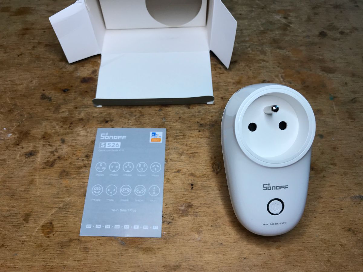

I myself bought it seemingly in China, but with shipping from the Czech Republic when it was on promotion:
. Set:
Instructions:

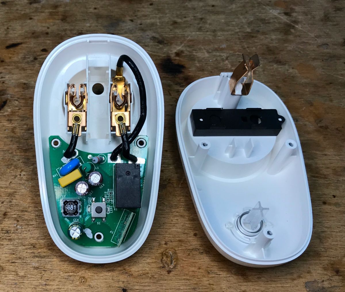

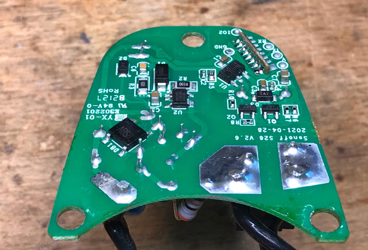

Interior of Sonoff S26
The chassis is held together by only three screws. No hooks.

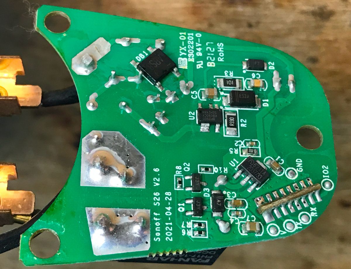

PCB is not screwed down:

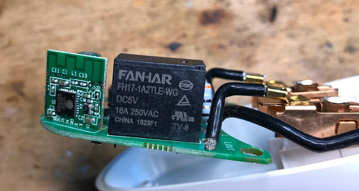

There's even a varistor on the input to protect against surges and some kind of capacitor against interference, not bad.

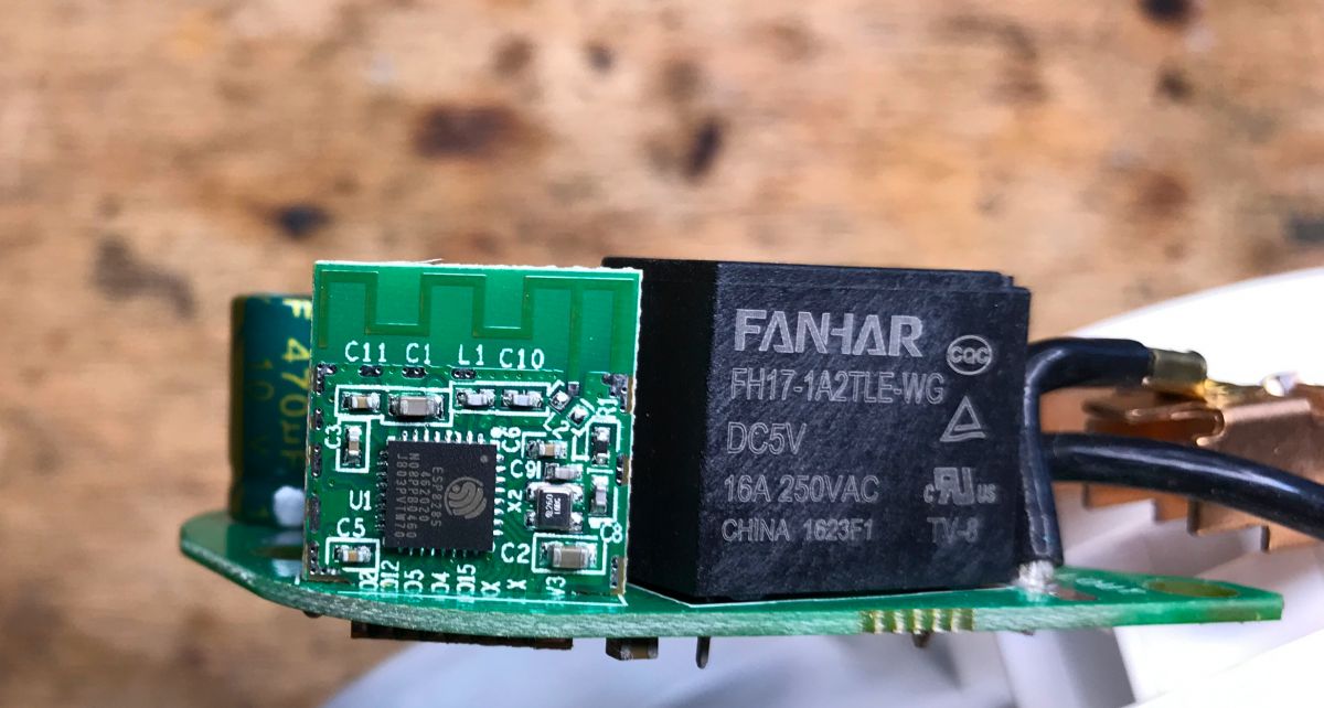

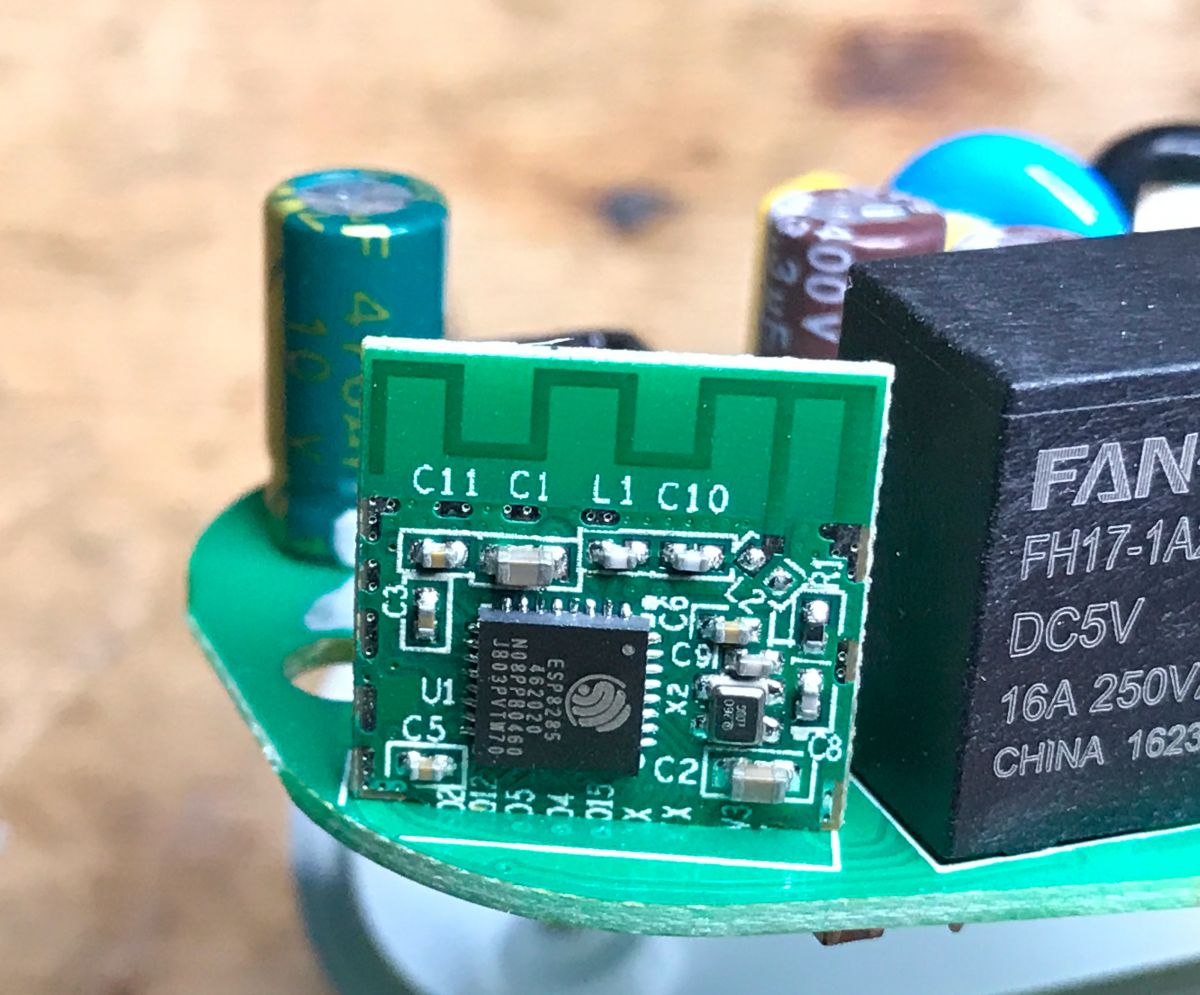

Transmitter and WiFi module:
Inside standard, rectifier bridge, inverter controller...

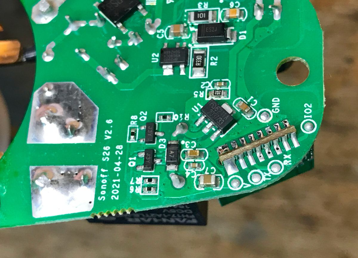

The inverter is made on BP2905:
Sonoff S26 V2.6 2021-04-28, this is the new version.
On the secondary side, there are two transistors controlling the relay and, as usual, a 3.3V LDO regulator powering the ESP.
Programming pads (but with IO2 instead of IO0?)

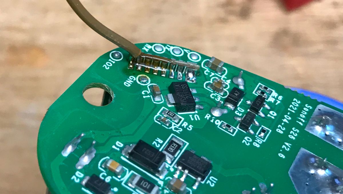

Changing the ESP8266 firmware Apparently all signals output to the pads are there, But if you look closely, there is an IO2 on the pad and not an IO0. For this reason, I derived IO0 directly from the WiFi module:
How did I know that IO0 was there? The pins are signed on the WiFi module itself, you can see it if you look closely.
Other than that, RX, TX, 3.3V power supply and ground are standard:

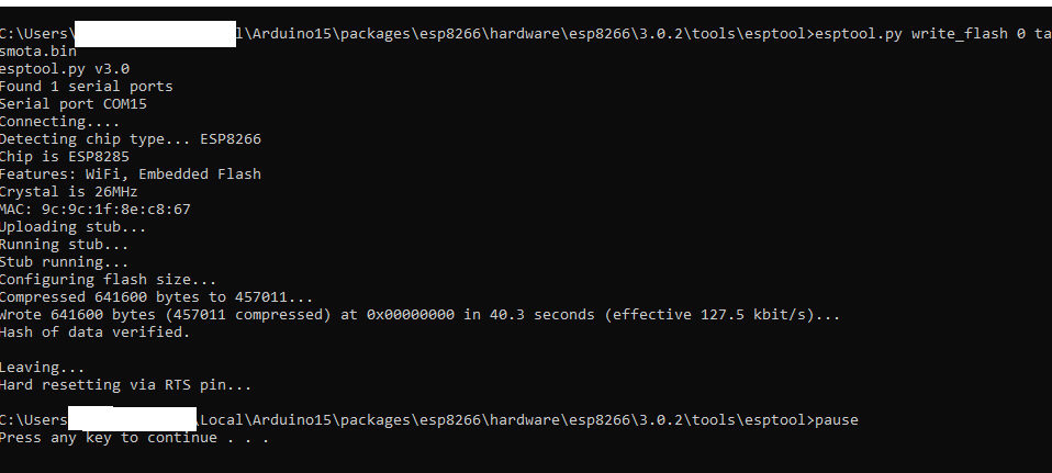

I uploaded the upload via esptool; the ESP was already in a programmable state after power connection thanks to IO0 being connected to ground beforehand:

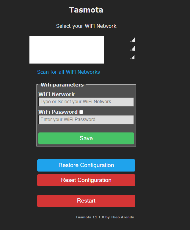

All done, you can configure Tasmota:
Template:
{"NAME":"Sonoff S26","GPIO":[17,255,255,255,0,0,0,0,21,56,0,0,0],"FLAG":0,"BASE":8}
