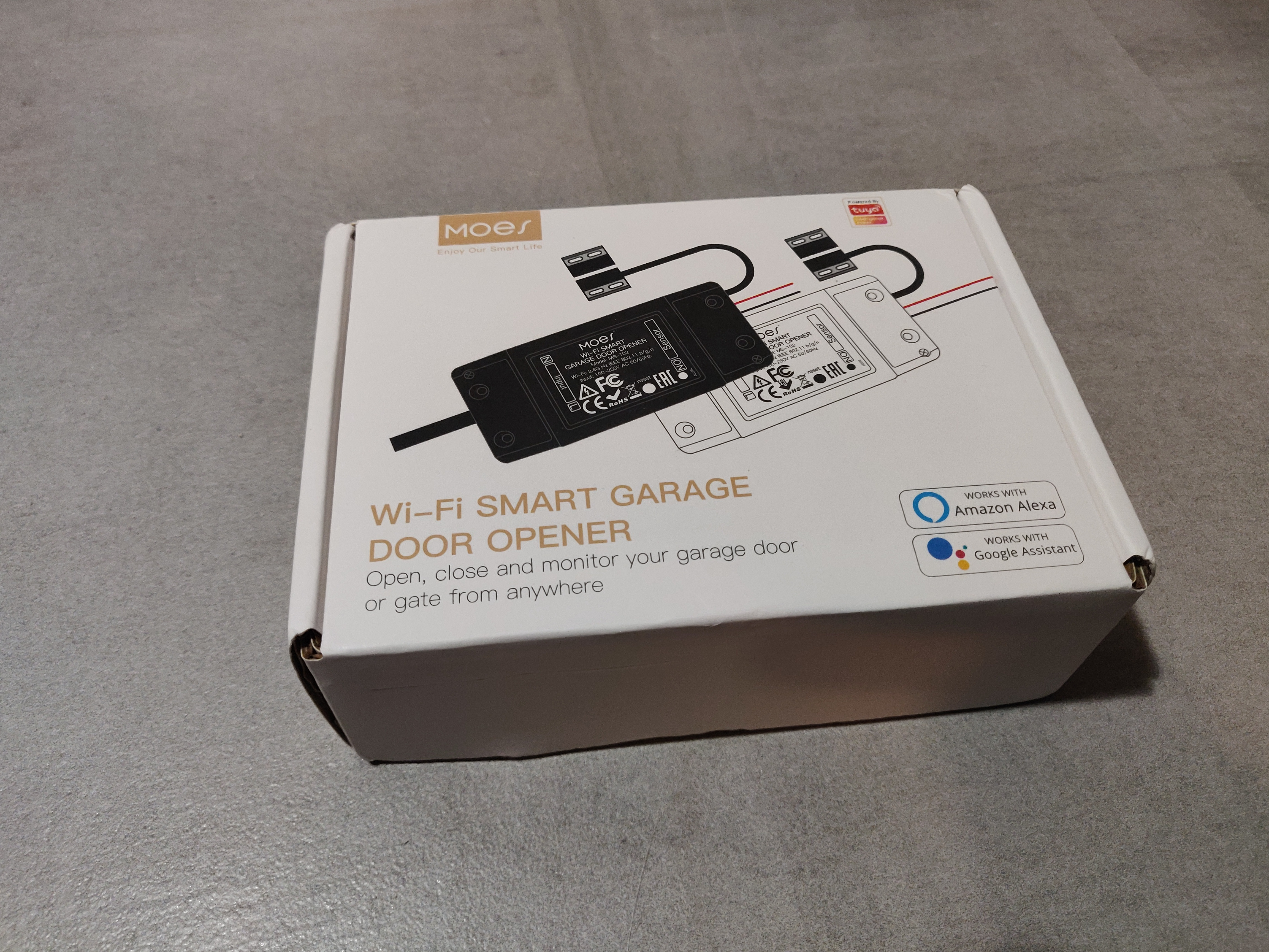

This is a teardown for a cheap garage door controller device bought on Aliexpress. It has a BK7231T / WB2S chip.
It requires soldering to flash OpenBK.
Box of Moes Wi-Fi garage door opener. Box containing a cheap garage door controller purchased from Aliexpress.
Info Summary:
Model/SKU from Box: MS-102
Model/Revision from the Board: HG041-20211220
Chip: BK7231T / WB2S
Rated Voltage: 90V-250V
Relays Qty: 1
Binary sensor: 1
Buttons: 1
MCU/Firmware Version: unknown
