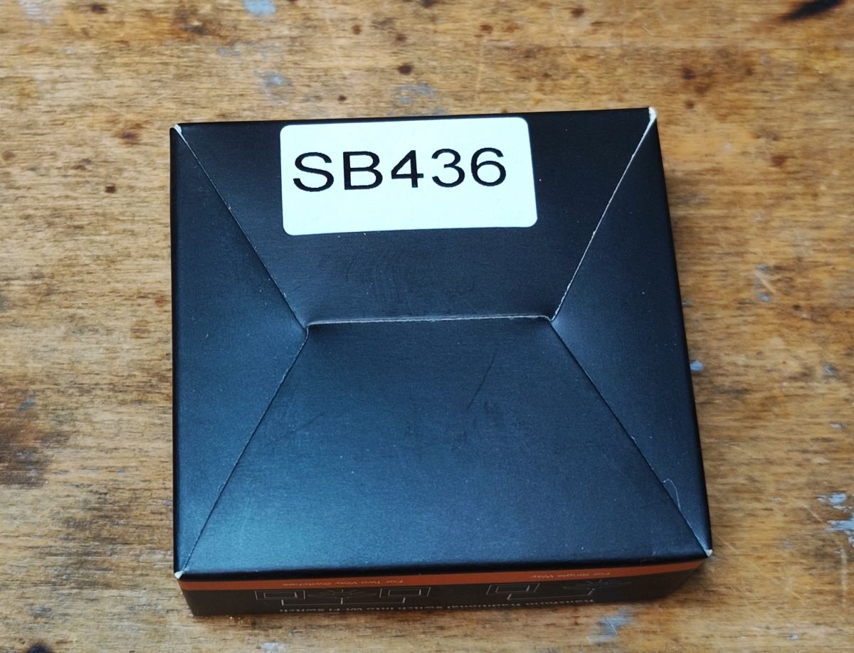

QS-WIFI-S03 Wi-Fi switch module and its packaging with instruction manual. Today we are reworking another WiFi-controlled relay so that it works fully locally, without the manufacturer's servers. The product shown here can be purchased in our country for around PLN40. It appears under the name QS-WIFI-S03, also sometimes called SB436.
Black box labeled SB436 on a wooden background. Box of the Wi-Fi Switch Module QS-WIFI-S03 on a wooden background. Box of WiFi relay QS-WIFI-S03 labeled SB436

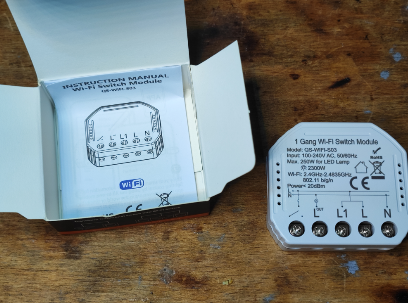

Instruction manual and wiring diagram (to be consulted yourself):
Instruction manual for the QS-WIFI-S03 Wi-Fi switch module on a wooden surface. Installation instructions and wiring diagram for the QS-WIFI-S03 WiFi relay.
Normally it is for use with the Tuya app, but here I focus on changing the firmware.

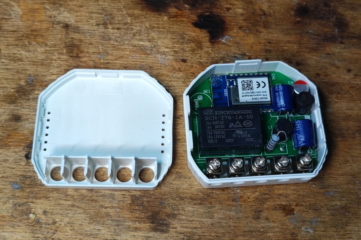

Interior of QS-WIFI-S03 Undo the cover:
Open interior of the QS-WIFI-S03 module showing electronic components.

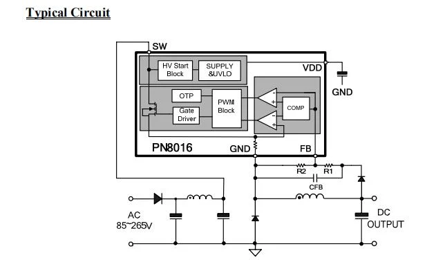

Inside classically - a relay, here an SCH-T76-1A-5S, some fuse resistor and probably a non-isolated step-down converter.
I wonder what happens in place of BE1 - a buzzer?
Typical application circuit diagram of PN8016 chip. PN8016 generates 5V, separately then further we have LDO 3.3V powering the WiFi module.

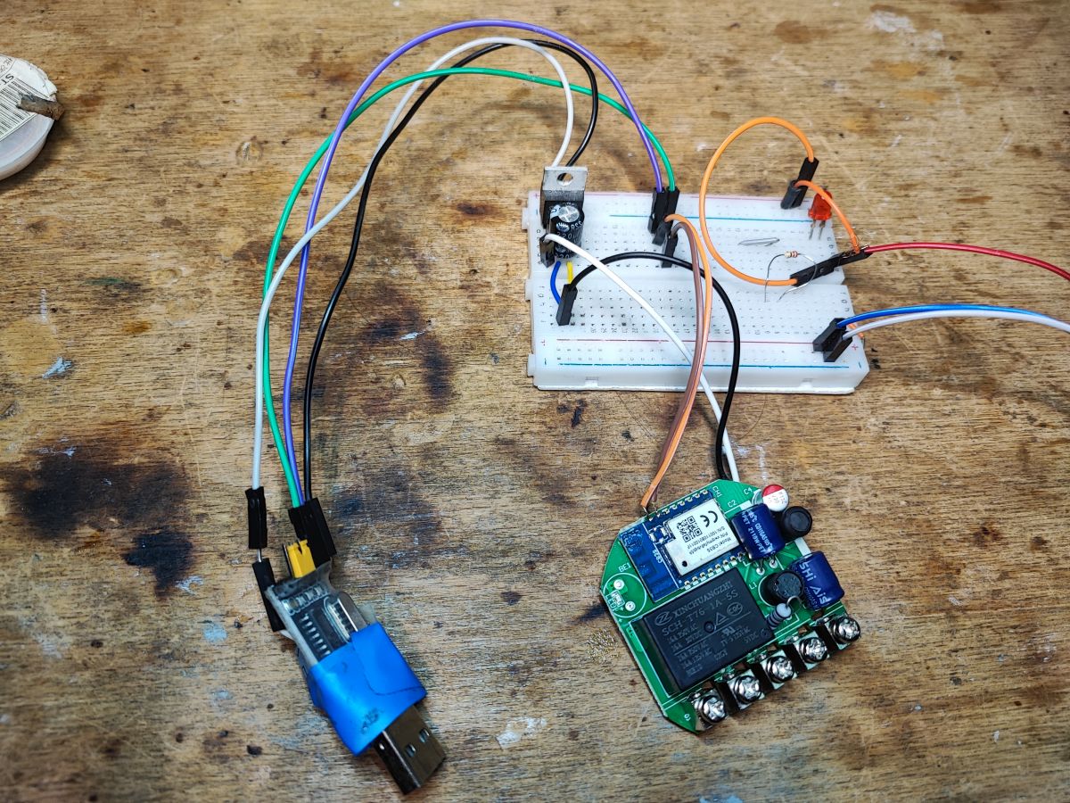

According to our flasher's instructions:

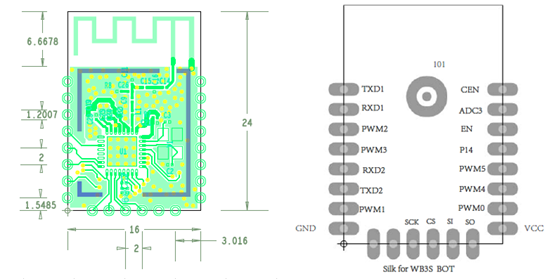

We need a USB to UART converter and four cables:
Diagrams of the CB3S WiFi module with pin labels.

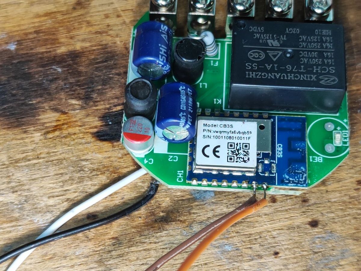

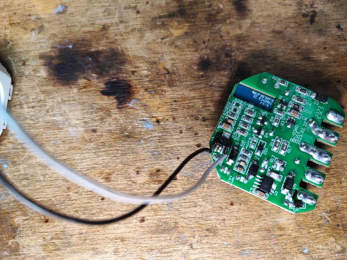

We solder the power supply, RX and TX.
First the power supply:
QS-WIFI-S03 relay circuit board with connected wires on a wooden background.
Then the RX and TX:
Interior of QS-WIFI-S03 module with electronic circuits on a wooden background
The whole circuit:
QS-WIFI-S03 relay programming setup with USB to UART converter and breadboard.
