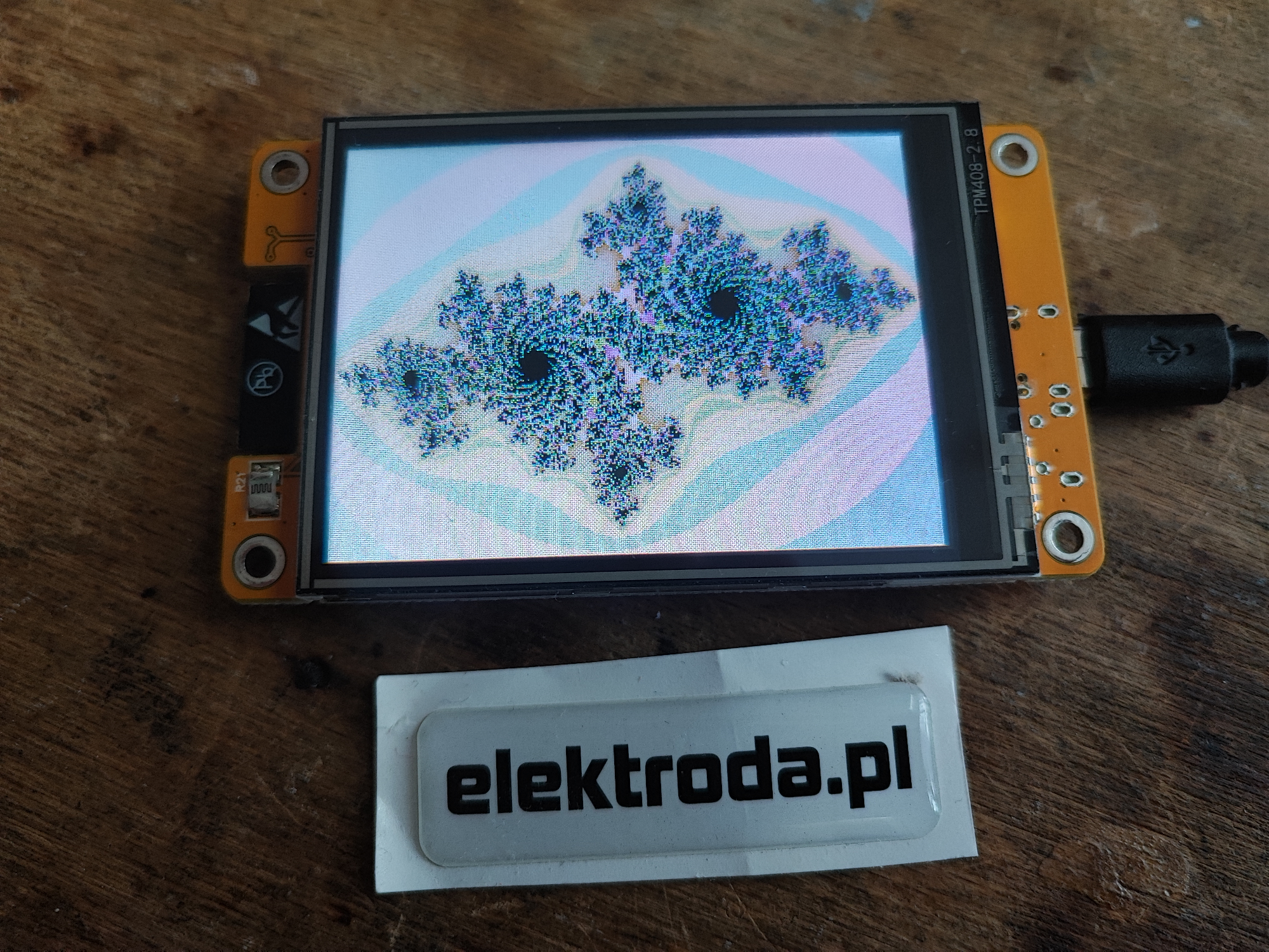

Julia's Fractal and drawing speed .
We've already gained some knowledge about drawing itself, now how about something more advanced. Let's see how a fractal will look on this display. What a fractal is - I won't discuss that here, but in a nutshell, a little calculation can give surprising results:
Code: C / C++
I implement the drawing in two loops, that is, for each pixel.
The result, however, is not the most interesting:
ESP32-2432S028R display showing a Julia set fractal .
The film nicely shows that the whole thing, however, is quite slow to calculate and draw:
It would probably be possible to optimise this, e.g. by creating a graphic to a bitmap and then calling the display of that bitmap once....
