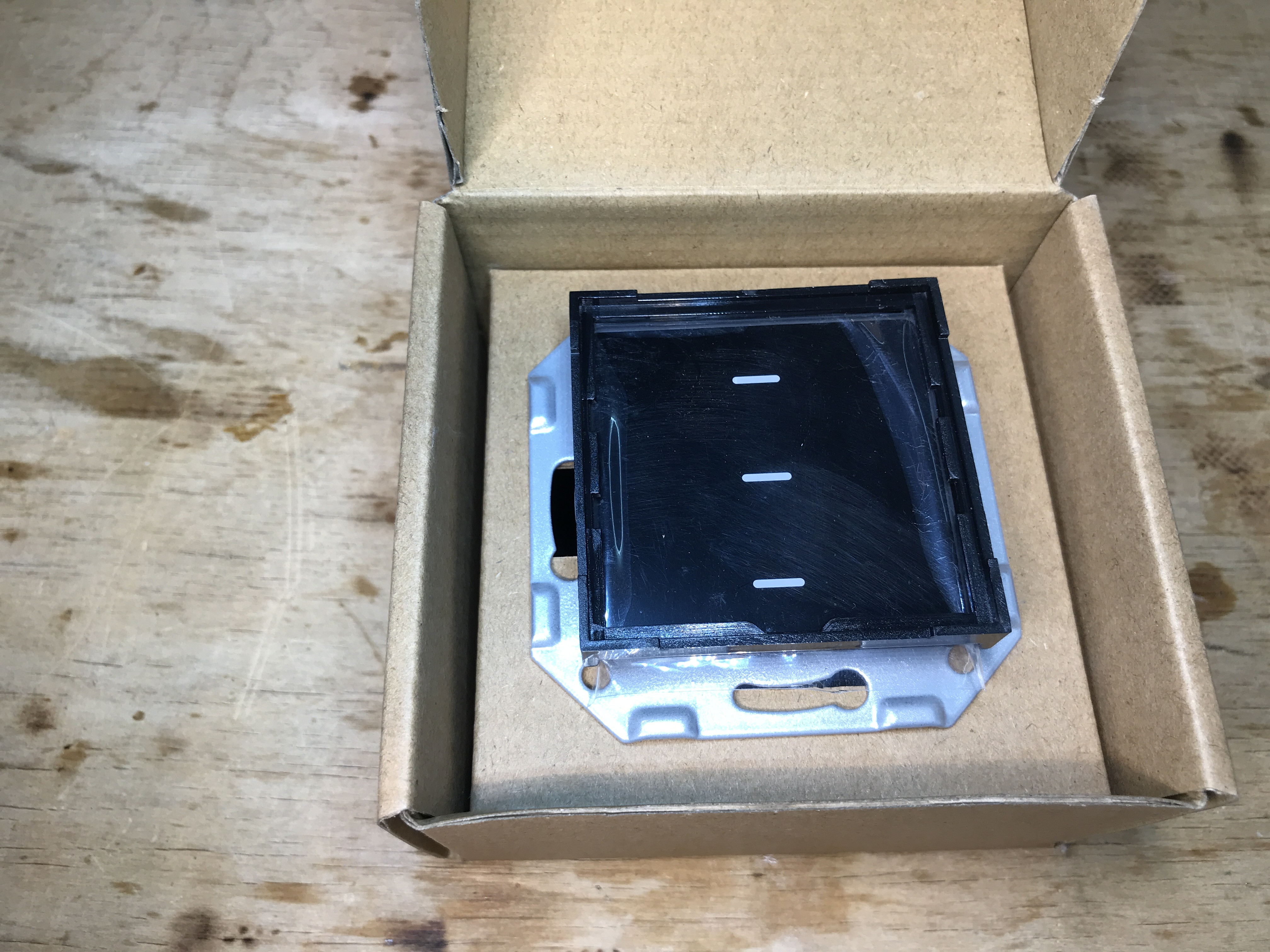

Triple light switch Avatto N-TS10-EU-B3 in a cardboard box. .
Today I am presenting a firmware change and connection to Home Assistant for another product in the Avatto series. This time it will be a triple light switch based on CB3S. The situation here will be similar to the white single model - I will need to detect the GPIO configuration using the tool GPIODoctor .

Interior N-TS10-EU-B3 .
The product is worth comparing with its brother version, the single, white, Avatto N-TS10-W1 which I have already described.
Avatto triple light switch circuit board with mounting elements and CB3S module visible. .

There are four LEDs inside - one per relay and an additional LED from WiFi/steaming status:
View of the interior of the triple wall switch N-TS10-EU-B3 with blue LED lights and circuit components on the PCB. A circuit board with visible blue LEDs and text on the surface.

This time my Flasher did not import the Tuya JSON configuration correctly.
Here are the manually specified GPIO roles:
P6 - Rel 1
P8 - Rel 2
P9 - Rel 3
P26 - Green LED
P7 - Btn 1
P10 - Btn 2
P24 - Btn 3
The LEDs are together with the relays on the same pins.
