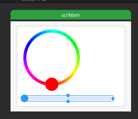

Step 1 - the UI itself .
The whole project is very attractive and beginner-friendly. We have the necessary components ready - even the colour selection widget is already in LVGL, which by the way you can read about in their documentation:

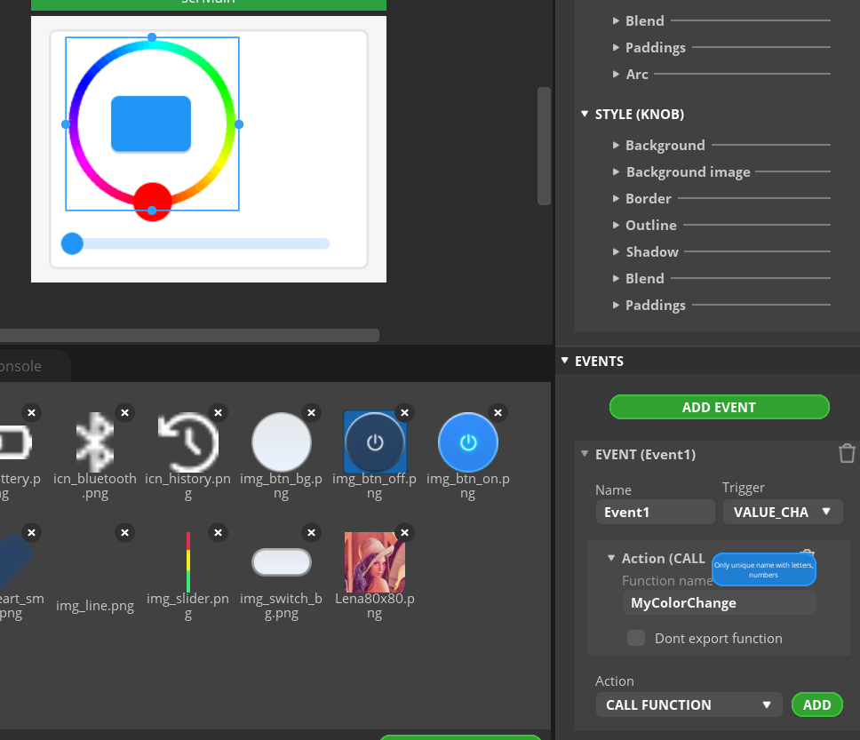

https://docs.lvgl.io/7.11/widgets/cpicker.html

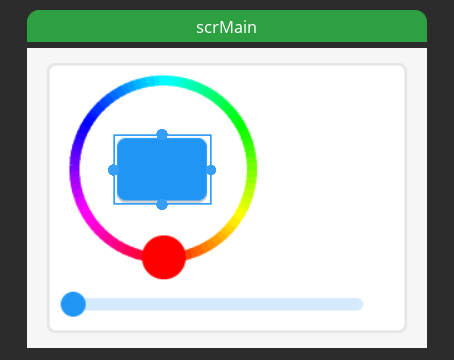

In addition, a slider to control the brightness level and maybe an on/off button of some kind is useful.
We add objects in SquareLine Studio:

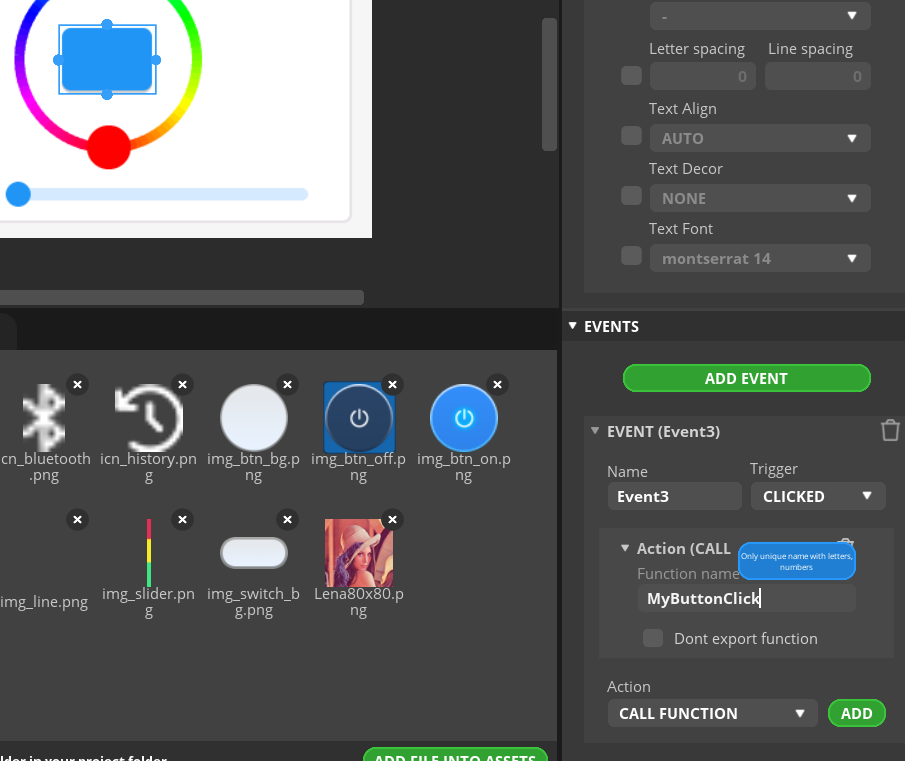

As in the previous section, we also add events:
Now it's time to implement the events, i.e. button press, slider move and colour selection separately.
So far without sending data to the lamp.
Button - colour change when pressed (lamp state is either on or off):

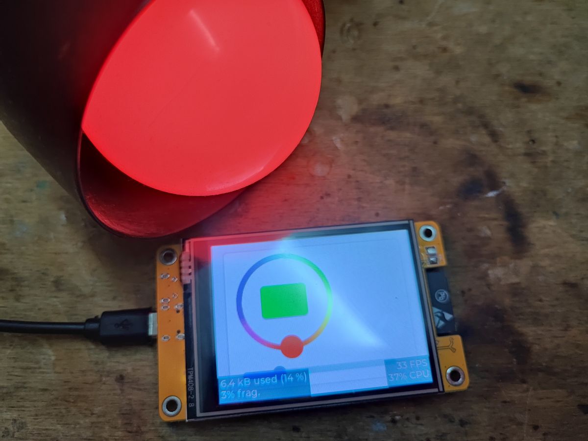

Colour selection - here you need to swap the colour from the packed 16 bit mode to something closer to us, RGB in a more convenient form:
Code: C / C++
The result:
[ 7382][I][main.cpp:39] MyColorChange(): Selected color: R=248, G=76, B=0
[ 9884][I][main.cpp:39] MyColorChange(): Selected color: R=128, G=252, B=0
[ 10375][I][main.cpp:39] MyColorChange(): Selected color: R=8, G=252, B=0

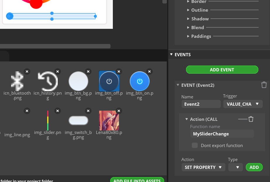

And then there's the slider, which for now just displays the change in the log:
Code: C / C++
Result:
[ 17024][I][main.cpp:19] MySliderChange(): Selected brightness=55
[ 17084][I][main.cpp:19] MySliderChange(): Selected brightness=54
[ 19754][I][main.cpp:19] MySliderChange(): Selected brightness=91

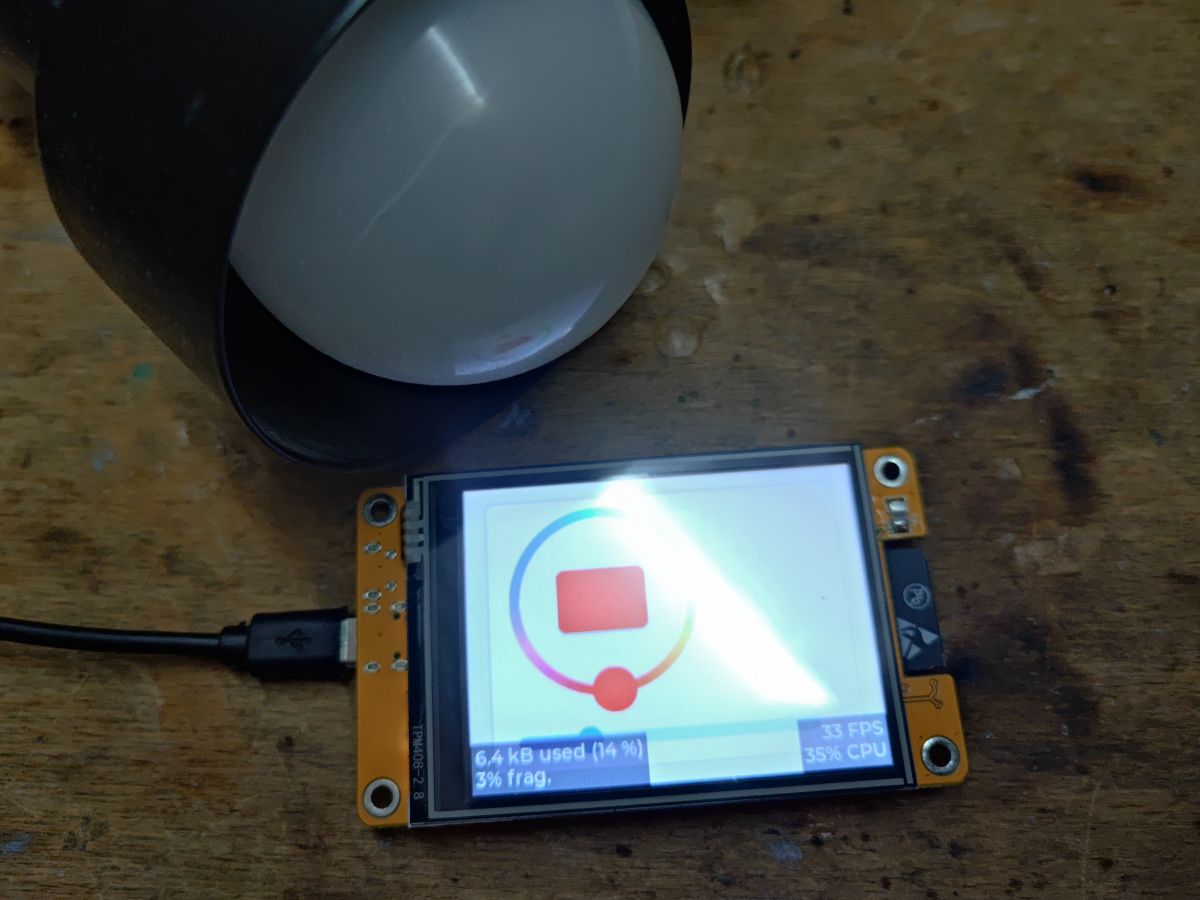

We check, everything works:

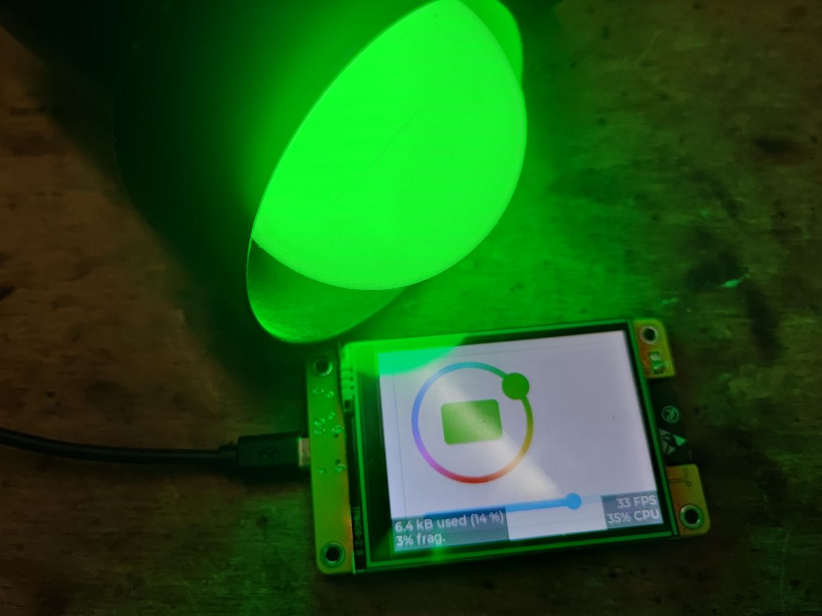

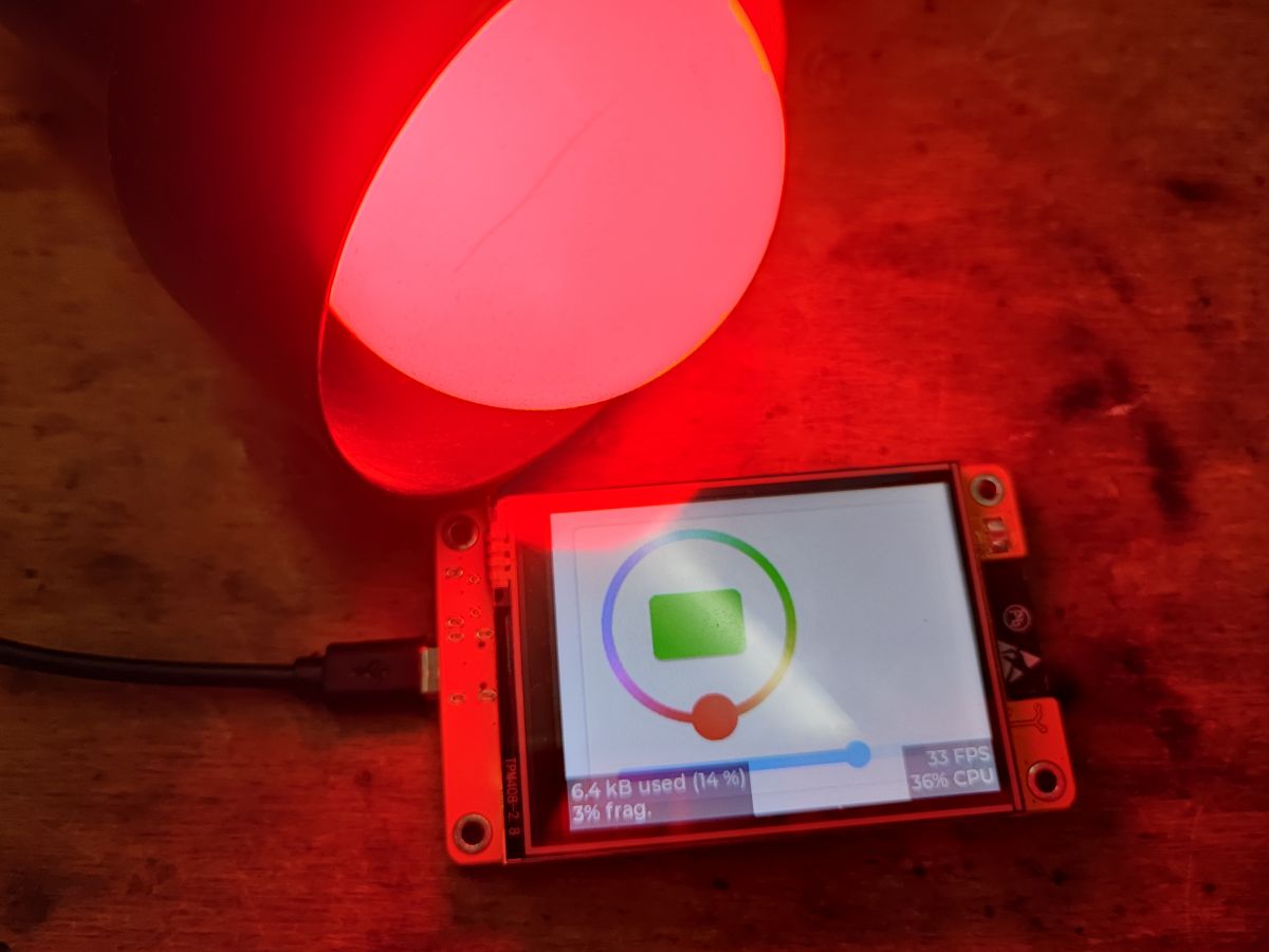

Final test on video:
The video shows control of the lamp from its native OBK panel and from the touchscreen display control programme developed here. The communication is two-way, although the states refresh with some small delay. The video shows that, for example, when I move the brightness level bar on the OBK panel, it also moves itself on the touch display.
Summary .
Our program works, the lamp can be controlled, and we got a taste of the basics of linking the user interface to web actions and were again exposed to the JSON format. By the way, we can appreciate LVGL again, because the colour selection widget was for like.

Parse the HSBColor string into three integers, convert HSB to RGB, and feed the result into the LVGL color wheel. The thread uses sscanf(hsbColor, "%d,%d,%d", ...) on values like 224,95,96, calls a helper HSBtoRGB(...), and then updates the widget with SetColorFromBytes(red, green, blue). That helper builds an lv_color_t with LV_COLOR_MAKE and calls lv_colorwheel_set_rgb. This keeps the touchscreen color selector visually aligned with the lamp’s actual external state. [#21214560]
What would be a better architecture for this project: creating a new FreeRTOS task for every command or using one worker thread with a queue?
One worker thread with a queue would be the better long-term architecture. The author says the current design creates a new task for each command only because it is a short demo. A single worker thread would perform all network operations and collect pending commands from a queue, which reduces repeated task creation overhead and centralizes error handling. The current model works, but the proposed worker design is cleaner for frequent slider moves, repeated polling, and future feature growth. [#21214560]
