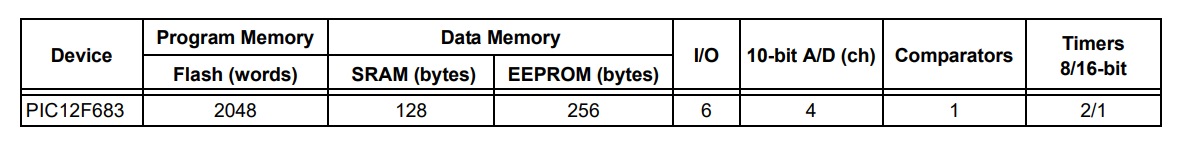

Parts used .
In summary, to project I will use:

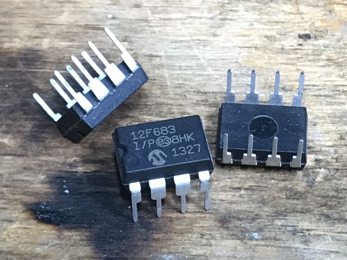

- PIC12F683 in DIP08 enclosure - main microcontroller
Three PIC12F683 microcontrollers on a wooden surface. .
Specification table for PIC12F683 device

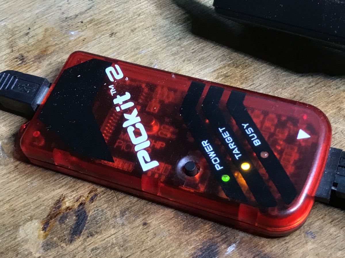

- PICKIT2 for PIC programming (or any other programmer that can handle it)
PICKIT 2 programmer interface with active LED indicators. .

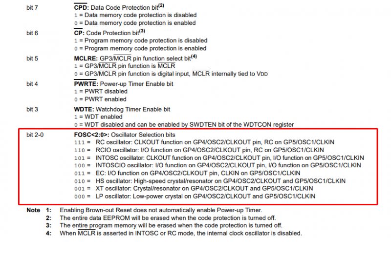

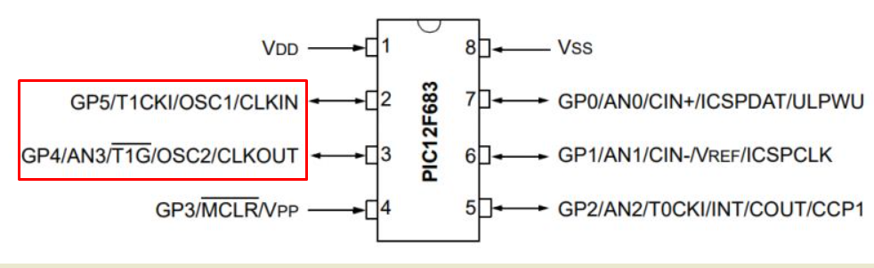

Here, however, I have made a minor correction as I noticed that the 'clock' pins do not flash along with the others:
Pin connection diagram for the PIC12F683 microcontroller in a DIP8 package .

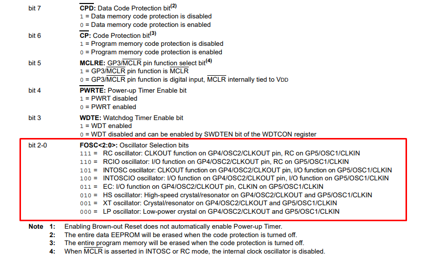

You have to search for what is wrong. Type "CLKIN" into the search engine in the catalogue note and browse the results:
Oscillator configuration table for a PIC microcontroller. .
The Config register (configuration word) defines the role of these pins. We want to set both of them in GPIO mode, so we add the CONFIG register setting to the internal oscillator without CLKOUT:

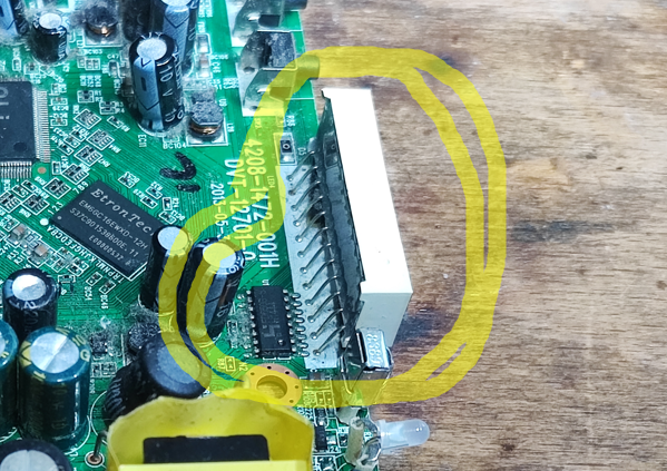

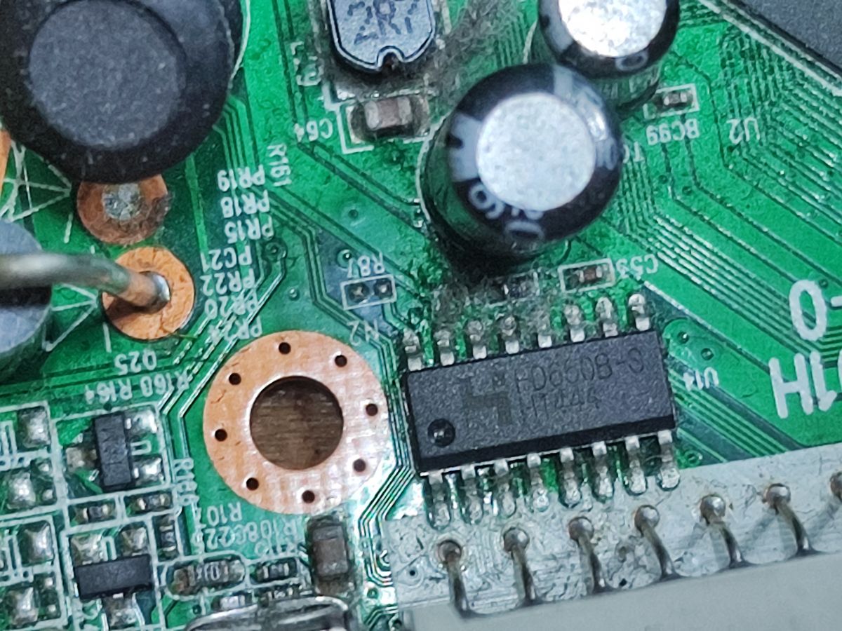

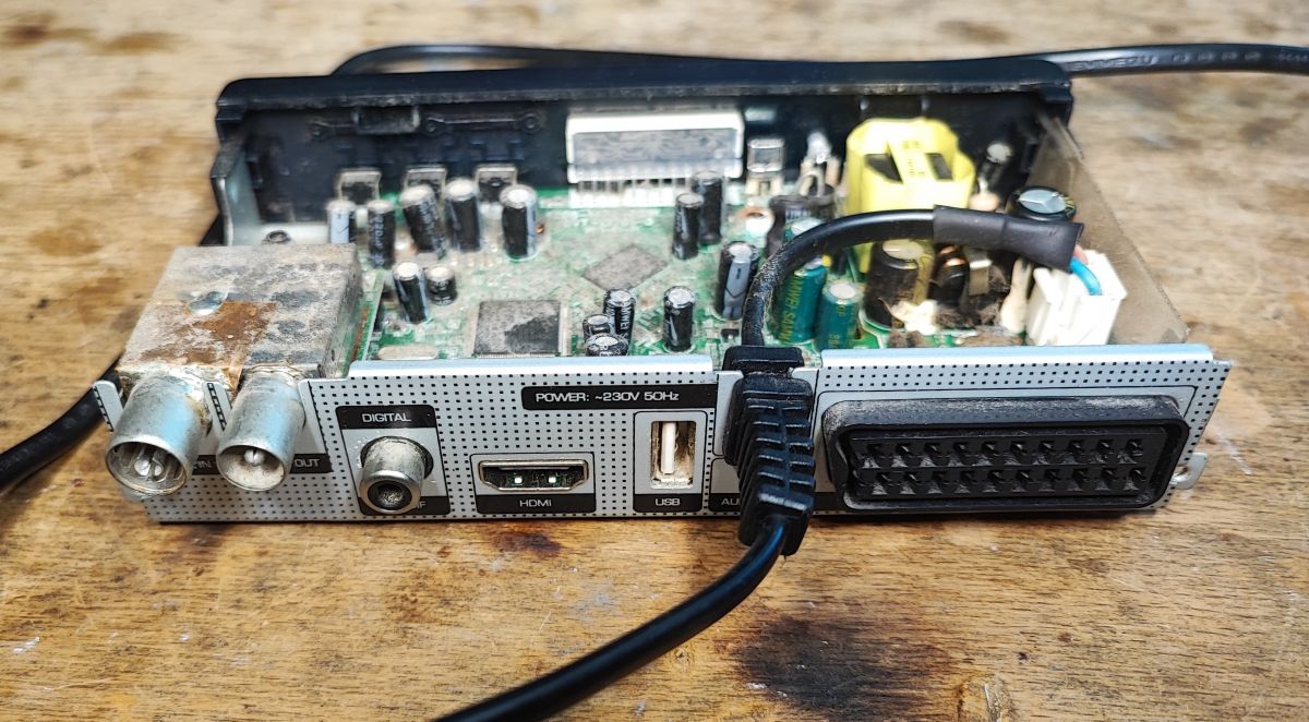

Step 2: Getting the display .

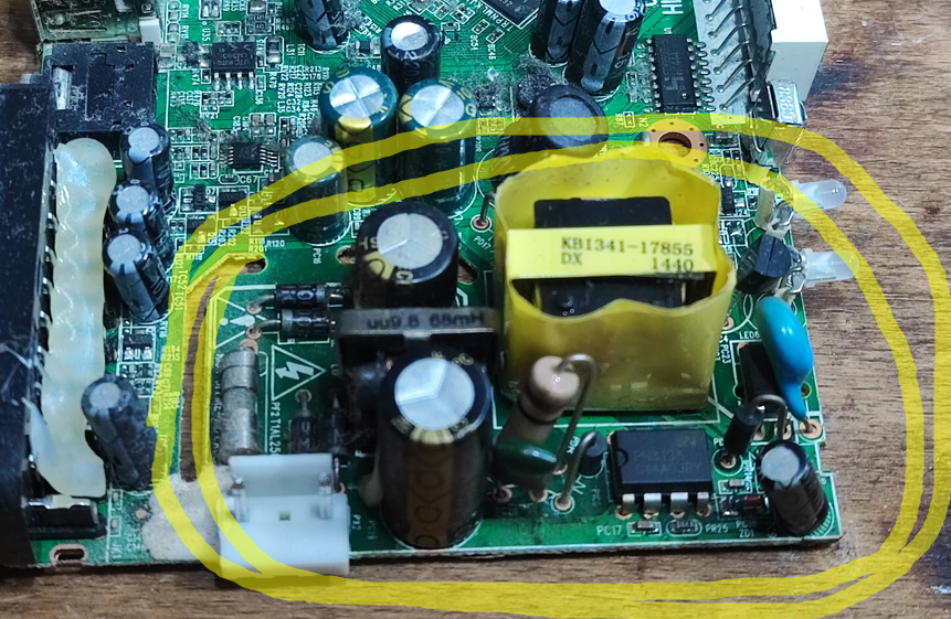

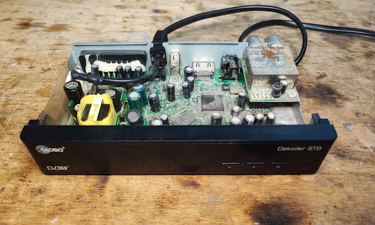

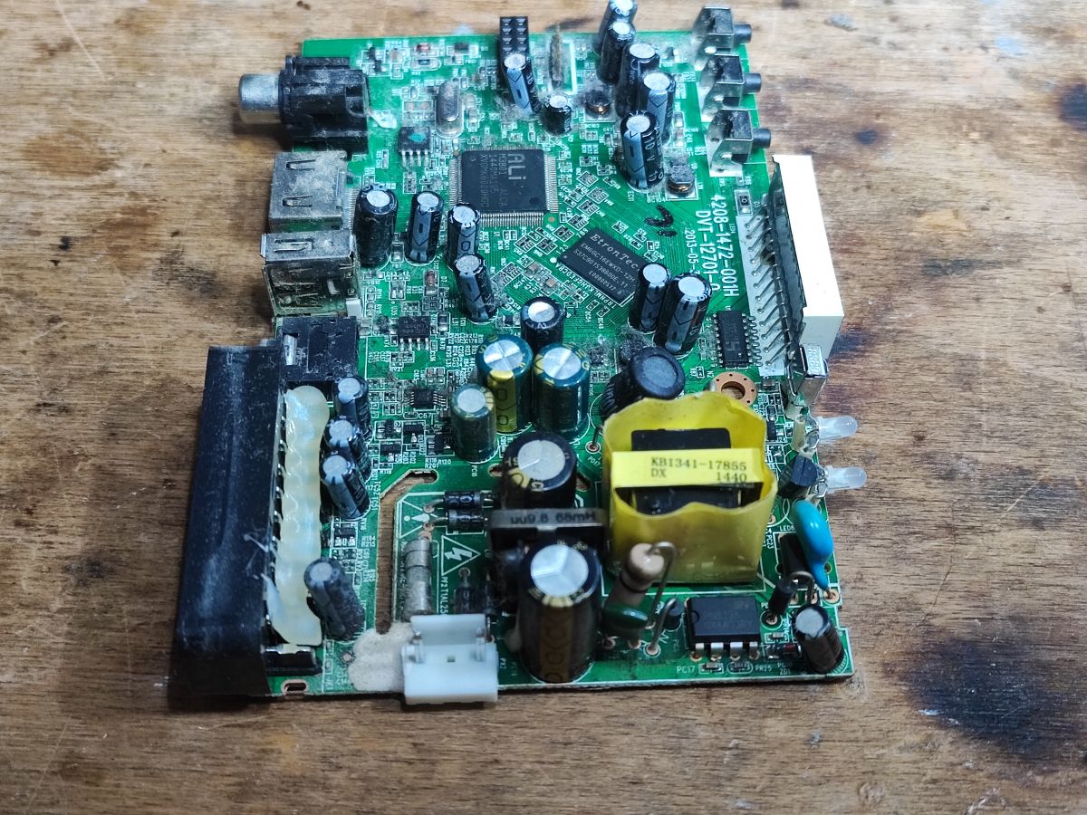

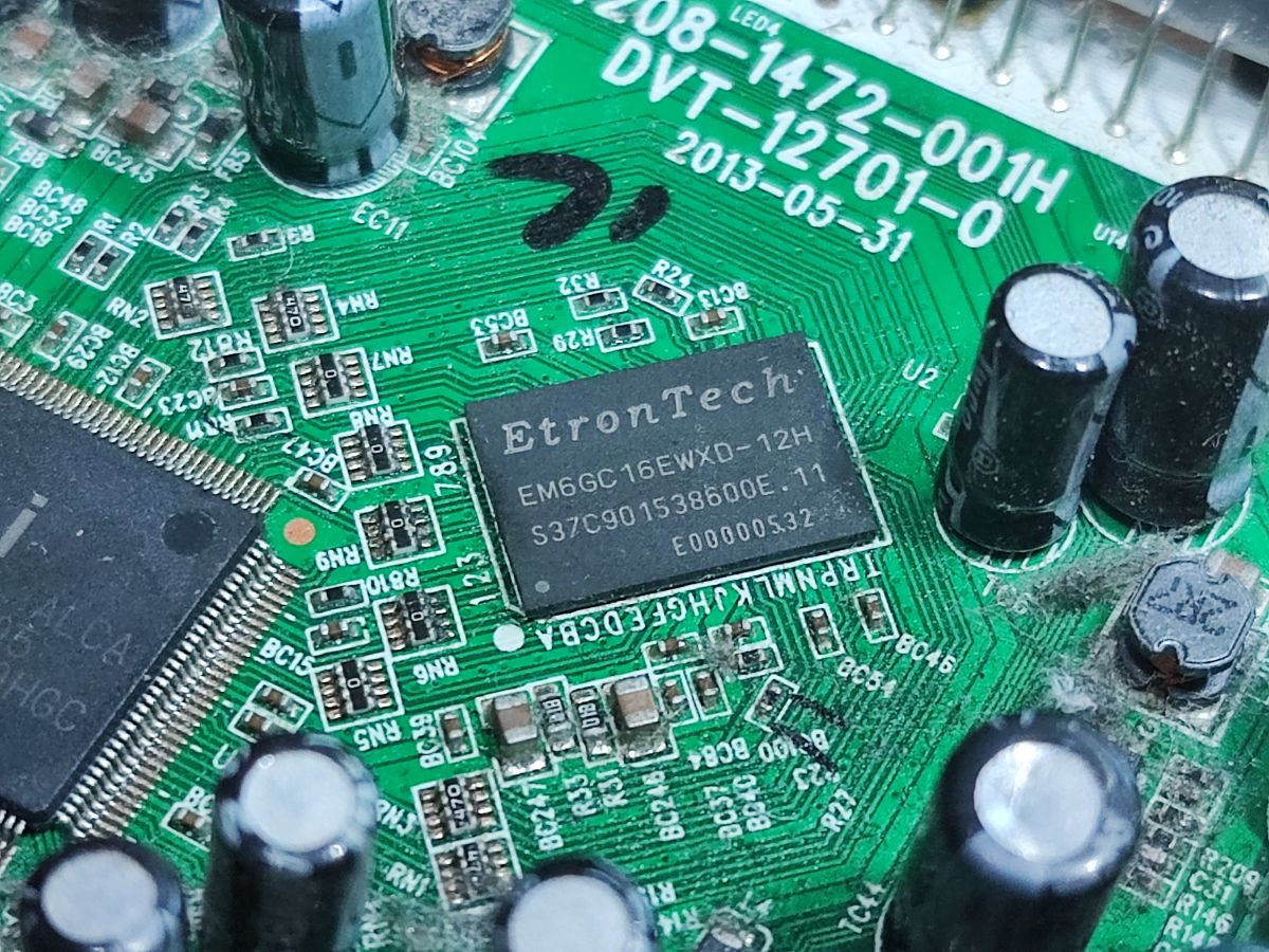

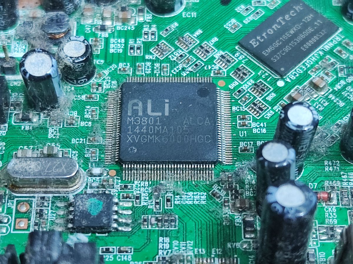

The display used (or rather the displays, as I first carried out the project on one board and after a break started on a second, similar one) are from an old tuner:
Interior of a DVB decoder with visible mainboard, power supply, and capacitors. Interior of an old tuner with visible ports and electronics. .
Inside there is usually the main CPU, Flash memory, RAM, separately the head, and, well, the keyboard/display chip that interests me:
Close-up of a printed circuit board with integrated circuits. Close-up of a circuit board with an EtronTech processor. Close-up of an electronic circuit board with various components. Circuit board with various electronic components on a wooden background. .

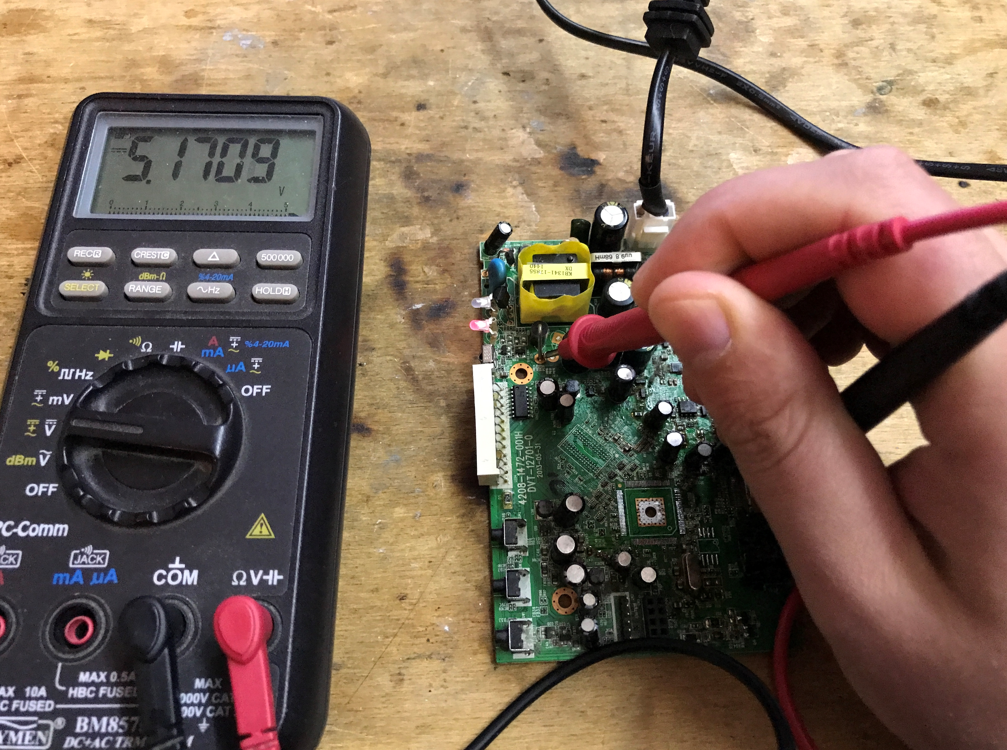

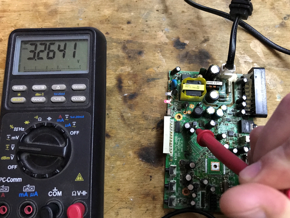

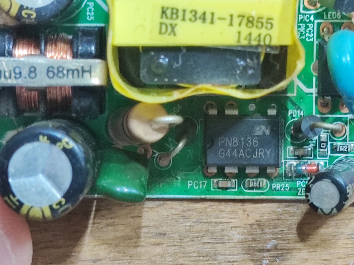

One advantage of using such equipment is a free power supply with an output voltage of generally 5V, although 3.3V on the board (after the step-down converter) will also be found:
Person measuring voltage on a motherboard with a multimeter. Multimeter and electronic circuit board with voltage measurement .
In this case the power supply is based on the PN8136:
Close-up of PN8136 integrated circuit and other electronic components .

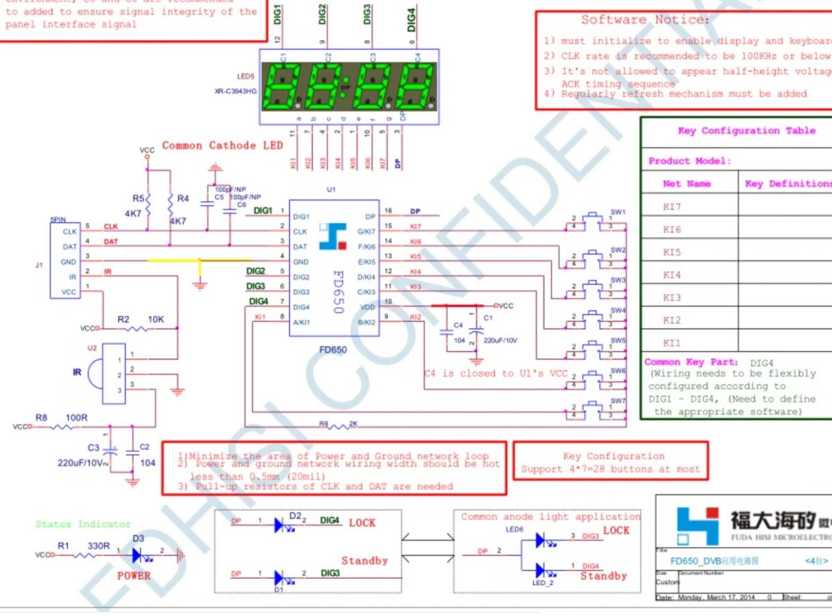

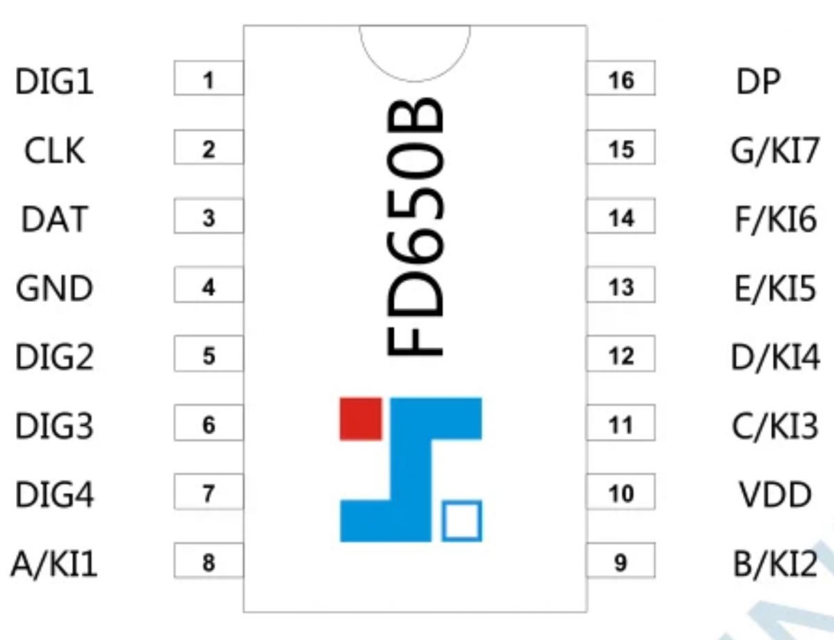

A second plus is the display often found in such products with control based on an I2C-like protocol (but generally without chip addresses?):
Pinout diagram of FD650B chip in DIP16 package. LED display connection schematic with control unit .
Communication with the chip here is over two lines only - SDA and SCL, data and clock. Communication is bi-directional, the SDA is capable of both sending data and reading it. So, it's time to connect the SDA and SCL to the two selected legs of the PIC and start the adventure....

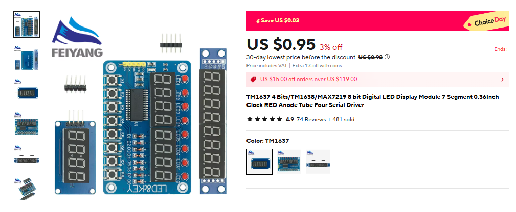

However, if you want to buy such a display, interesting modules can be found on the web:
Set of digital display and key modules. .

The FD650 is not compliant with the I2C standard, as it does not have its own address separately, but instead directly "exposes" registers to the bus. These exposed registers are several, so an I2C scan will see it as several devices. In addition, this means that you won't connect two FD650Bs on one I2C bus, as you can with e.g. the MCP23017 if you set them to different addresses....
By the way, it resembles very strongly the popular TM1650/HD2015/CH455H which I have already discussed. I refer you to the following topics for details :
Running the HD2015 display/button controller after reverse engineering, comparison with TM1637itd .
Read the datasheet note and write the CH455H 7-segment LED display driver in Arduino .
7-segment displays on TM1637 - 4 and 6 digits - Arduino, protocol .
The register addresses match. Based on the above topics, we have:

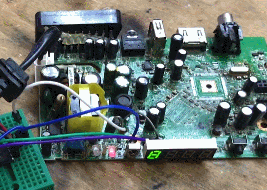

It works, the segments of the first digit flash.
Electronic board with connected wires and LED display .

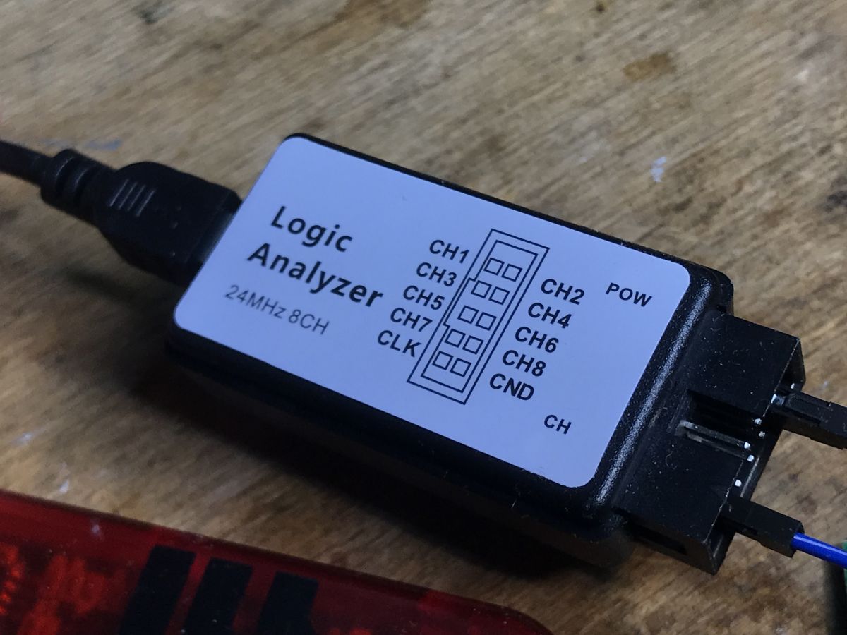

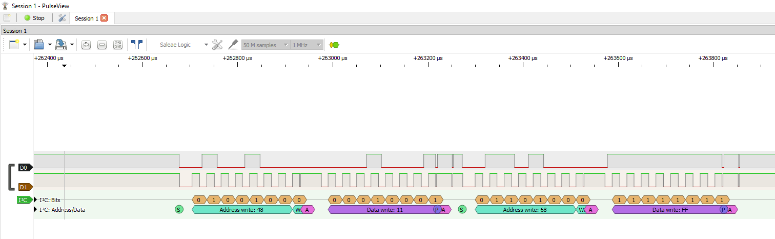

In order to validate the code I suspected the whole thing on a logic analyser from the subject Salae 24MHz logic state analyser for PLN40 - analysis of unknown LED display protocol :
Screenshot from PulseView logic analyzer showing I2C signal waveforms. .

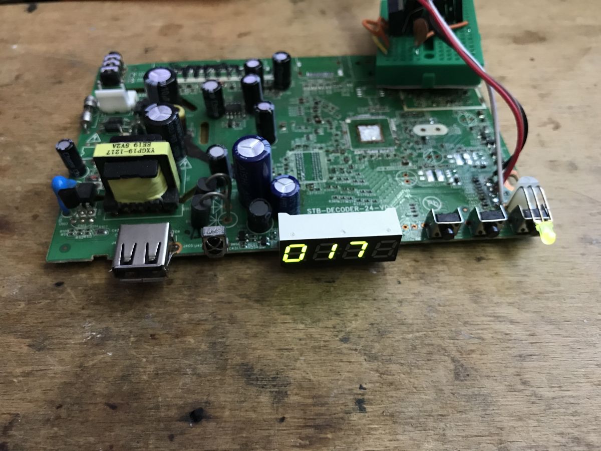

To start with, I fired up the simplest "countdown":
Code: C / C++
The result:

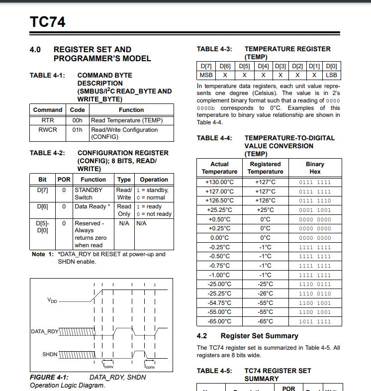

The TC74 is very simple to use, the temperature is as an 8-bit, one byte number, read from a register at address 0x00:
Register and temperature conversion table for TC74 .
We first send the register address, here 0x00, preceded by the thermometer address with the W bit (youngest bit turned off) to the thermometer, and then send the byte read, also preceded by the thermometer address, but with the R bit (youngest bit turned on):

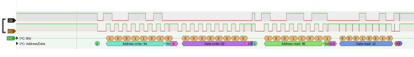

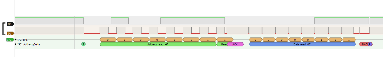

Verified with Salae logic state analyser :
I2C signal diagram showing data read process. .

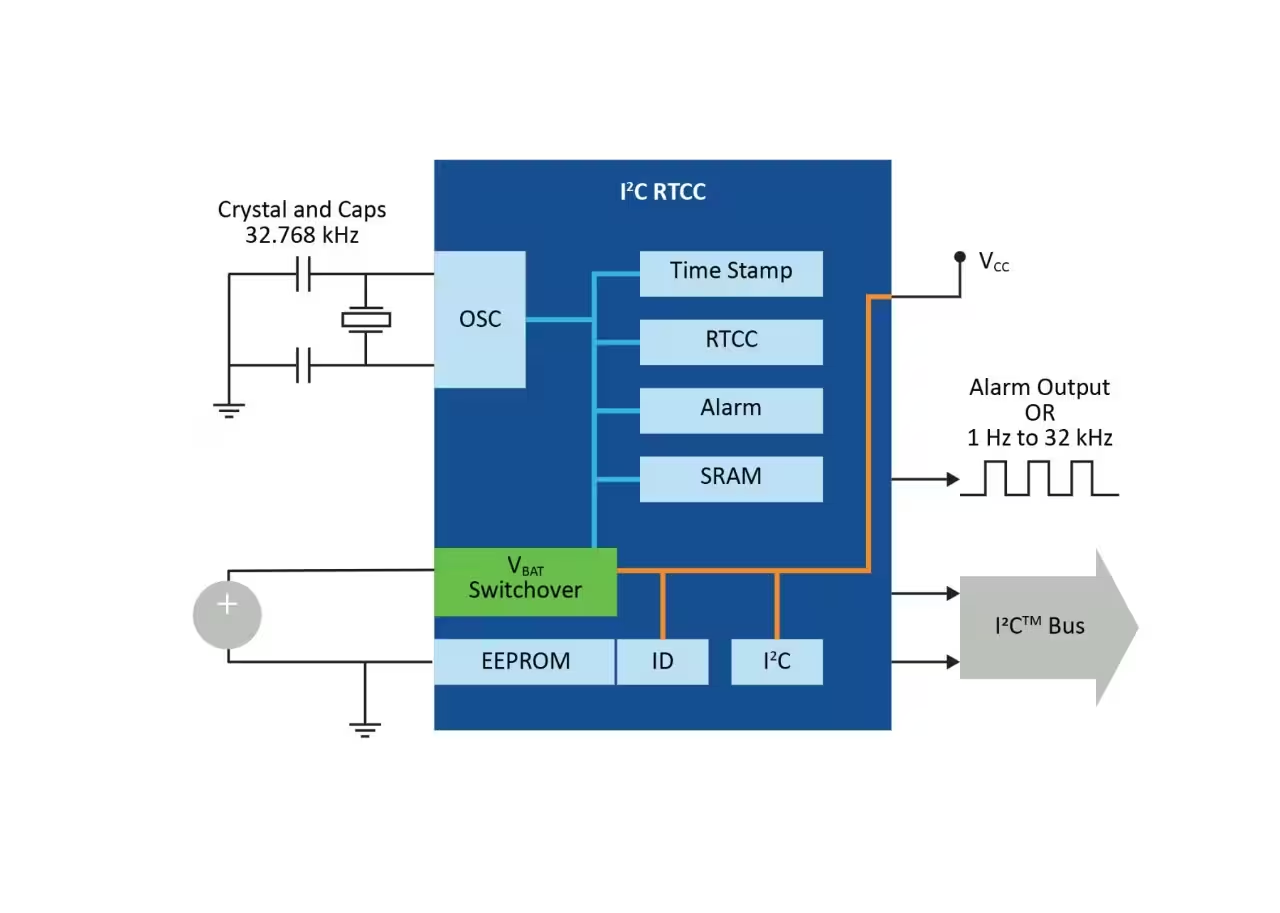

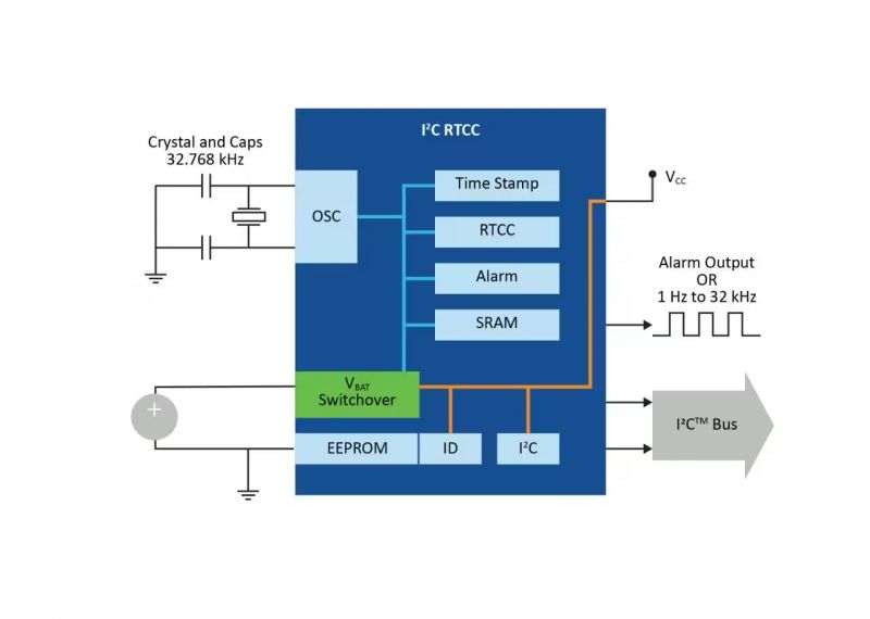

Countdown time is a little more difficult than it might seem. It would be best to use an external RTCC (Real-Time Clock/Calendar) chip for this, such as the MCP7940N:
Block diagram of I²C RTCC with oscillator components and connections. .
The advantage of such a solution is that the time is kept even after a loss of power. A small battery or cell is often used for this. Newer PICs also have RTCC built in.

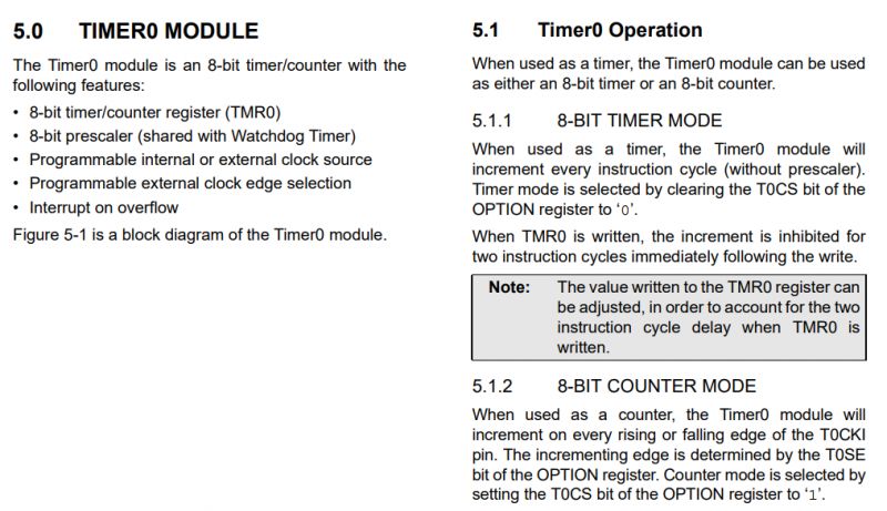

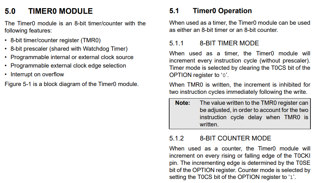

Here, however, in order to simplify things, I will try timekeeping with a timer:
Tutorial PIC18F2550 + SDCC - Part 4 - Timers, interrupts .

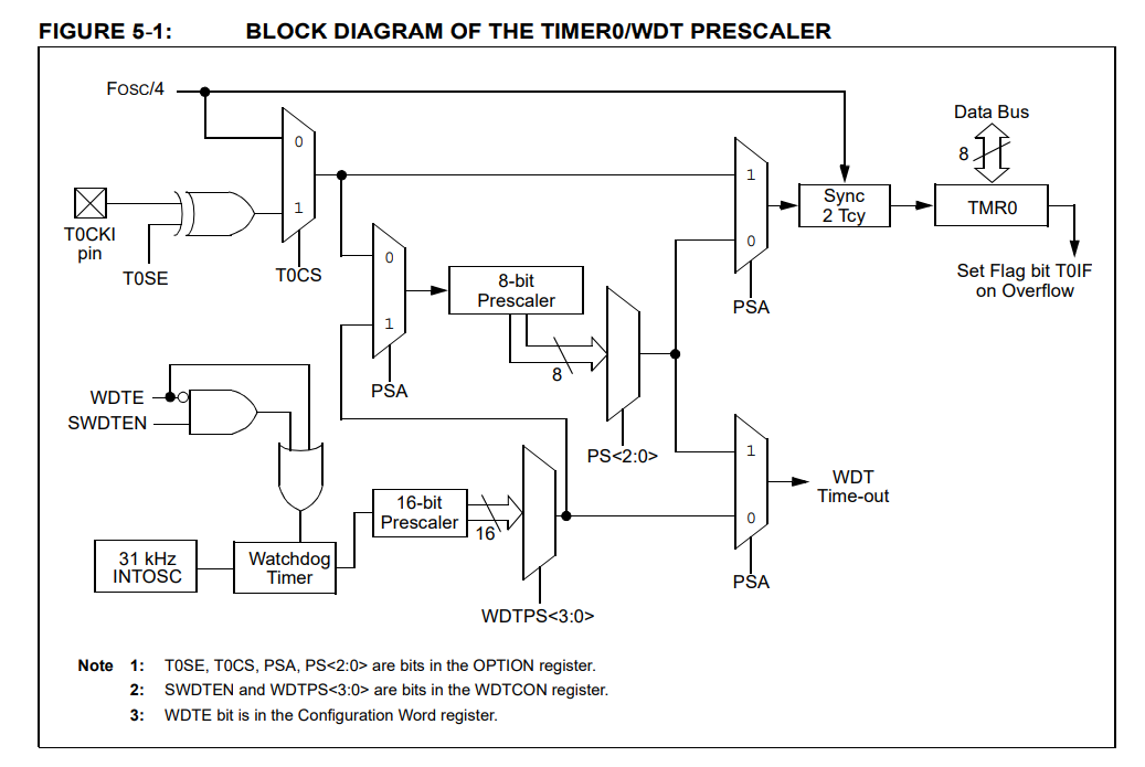

Let's take Timer 0 as an example:
Document snippet detailing Timer0 module functionality in a microcontroller. .
Block diagram of the TIMER0/WDT prescaler .

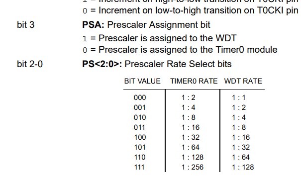

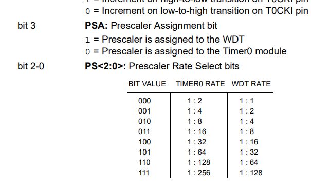

I set the internal oscillator earlier to 4MHz, so Fosc/4 is 1MHz.
The prescaler can now be selected in OPTION_REG:
Timer0 and WDT prescaler configuration table .
I chose 1:256, so the timer incrementation will occur not at 1MHz, but at 3.90625 kHz, so the period is 0.256ms.

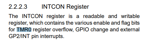

Now you still need to set from which value the timer will increment:
Excerpt from documentation describing the INTCON register and its functions. .
The interrupt is called when the value of TMR0 overflows (exceeds 255, because it's an 8-bit register), so setting TMR0 to 0 will cause the interrupt to call every 256 timer cycles. Since we know that the timer period is 0.256ms, the period of 256 cycles will be 65.53600 ms....

Effect at the moment .
The clock alternately displays the current time and temperature. The time can be set, although the buttons do not distinguish between when the key is pressed and when the key is held down continuously:
Summary .
Probably the most interesting conclusion from all the fun is that even with these Chinese inventions like TM1650, TM1637 etc., where normal I2C-compatible addressing is missing, it is still possible to give several devices on one bus. I don't mean two TM1650s, of course, as this would be impossible due to the same register addresses, but e.g. TM1650 + TC74 can be made to work.
The clock in its current form works, it works properly on the power supply from the board used, and 5V additionally can also be taken from it.
Of course a lot could still be developed and improved, so in the next part I plan to:
- an attempt to connect and program some RTCC so that the time is counted outside the PIC and additionally is supported by a 3V battery when I disconnect the clock from the mains (or reset the PIC, each upload of a new firmware resets it)
- an attempt to think about and introduce some form of alarm, maybe with a buzzer, also with saving the settings in EEPROM memory, the PIC used has 256 bytes of it
- an attempt to connect some kind of port expander on I2C, if the addresses allow...
- reorganising the code, especially the control and refreshment, to make it more sensible
That's it for now. In the next part we will see how much more Flash memory there is and to what extent I will be able to develop this project further. I am counting on at least these RTCCs... .

All nice, but how to get rid of the unnecessary load, i.e. SoC and RAM, from the board of such an STB? This is probably the most difficult step, because you have to precisely solder out the dense chips... [Read more]
p.kaczmarek2 11 Nov 2024 00:07
As I understand it, you are asking about using hot air for the discharge so that there are no short circuits? I remove short circuits with a braid, in addition I use flux. The braid allows you to effectively... [Read more]
XJ_ 20 Nov 2024 17:21
Wau, pretty old skool wrx. Kłaniam się, proszę pana !!! Added after 3 [minutes]: Like I do... If blinking, everything gona be alright ;-) [Read more]
