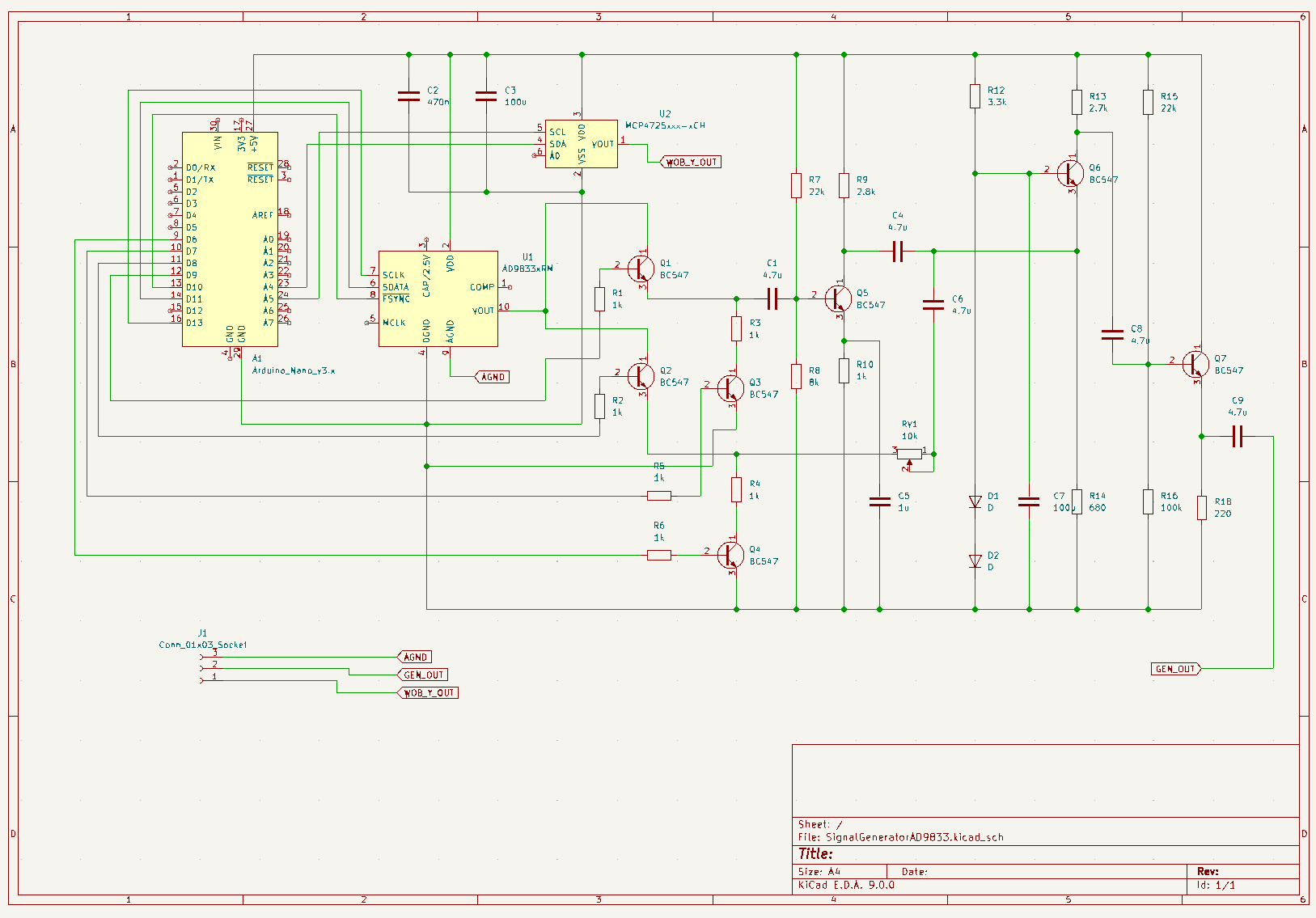

Edit: 03-10-2025:
I have corrected the circuit diagram for normalising the output signals, and refined the buffer (emitter secondary) which was causing some problems.

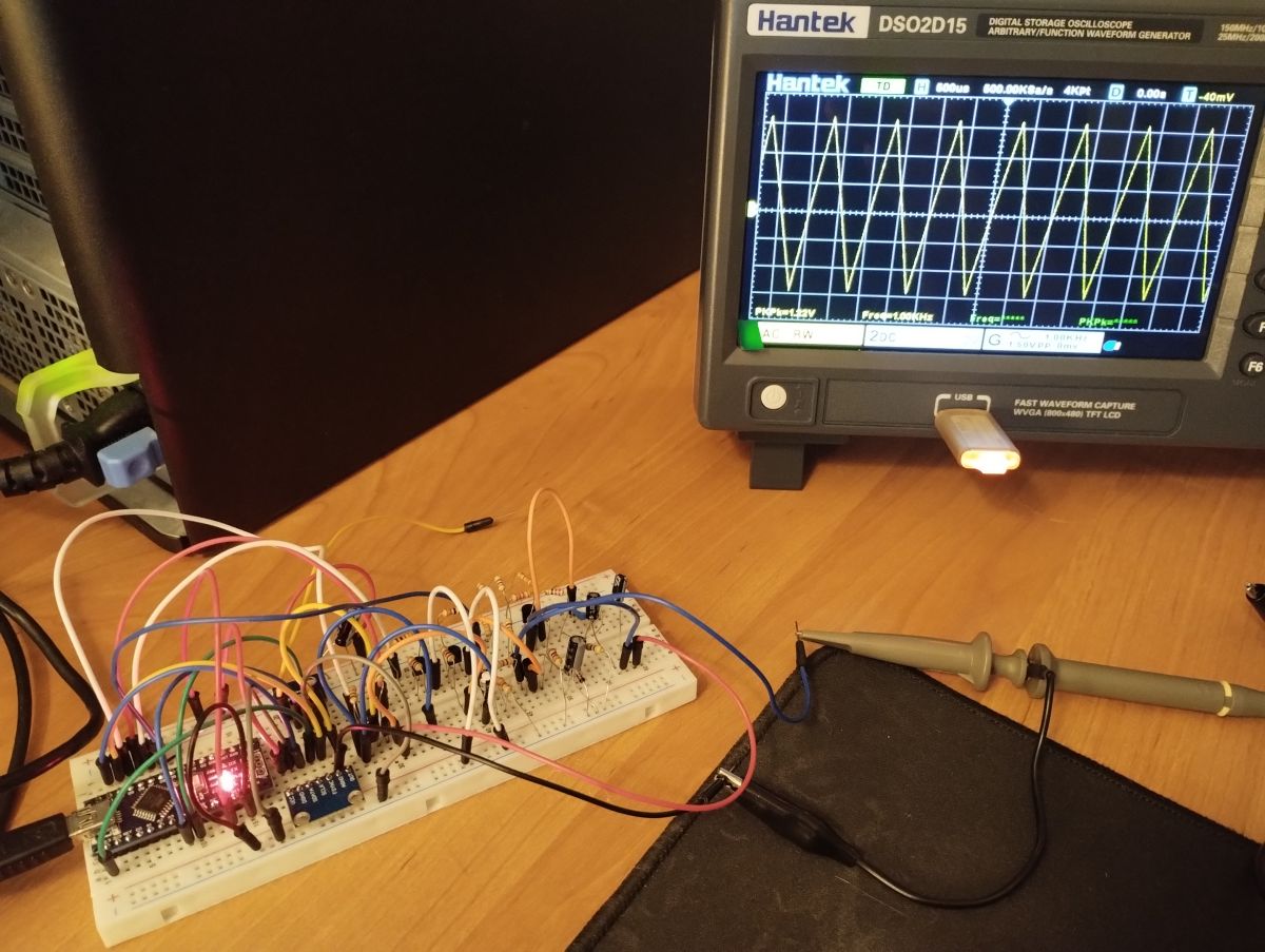

Just for fun, I committed a function generator, sine, triangle and rectangle based on the AD9833 programmable generator (SPI).

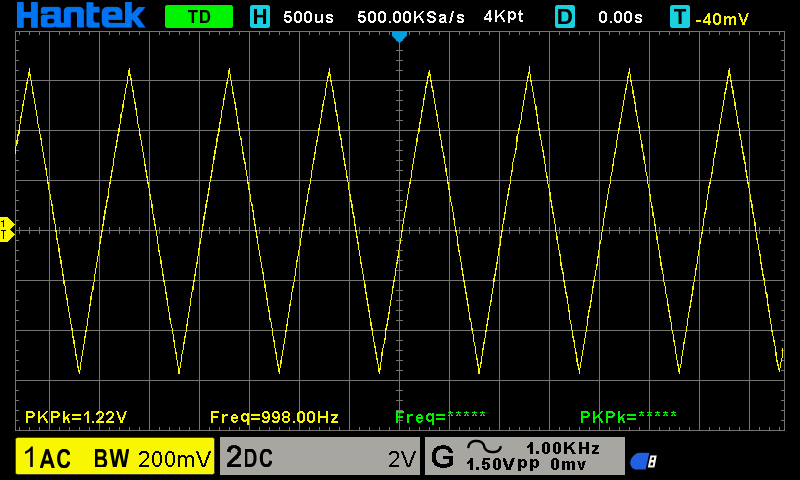

Oscilloscope screen displaying a yellow triangular wave with a frequency of 998 Hz and a peak amplitude of 1.22 V. .

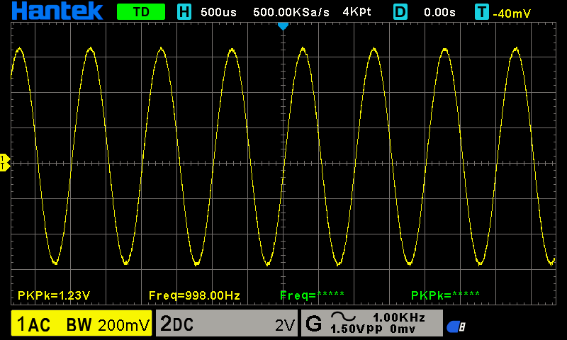

Oscilloscope screen displaying a sine wave signal with a frequency of 998 Hz and peak value of 1.23 V. .

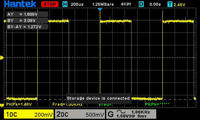

Oscilloscope waveform displaying a square wave on a Hantek screen. .

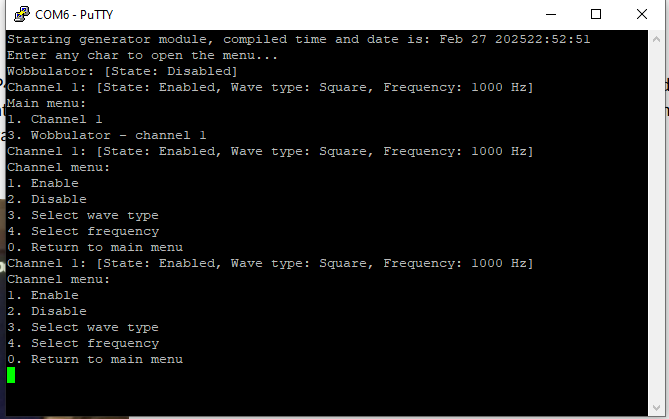

The project uses a choice of Arduino UNO/ NANO or ESP32 in Wemos D1 R32 (or suitable clones) as the generator controller.
In addition, the CPU of course implements the operator interface, in this case the simplest possible in the form of a serial port character console.
It is possible to select the type of signal, frequency, enable or disable a given channel (maximum 2).
View of PuTTY console with text interface of the signal generator. .
For now, I only have it in prototype form plugged into a contact board:
Functional generator prototype with oscilloscope Hantek. .

The problem with the AD9833 circuit is the difference in amplitude of the generated signal, for the sine and triangle it is 600mV p-p, and for the rectangle it is practically rail to rail.
I wondered how to solve this elegantly to have the same amplitude regardless of the type of signal chosen. My first idea was to use an electronic potentiometer controlled from the procec (X9C103S). It varied the attenuation of the signal (equalised downwards) depending on the selected waveform type.
In the end, I chose a slightly more complex solution involving the design of an analogue circuit that creates two signal paths.
On one of these paths is an amplifier with a common emitter (for sine and triangle). On the other path, a resistor (mounting potenciometer) suppresses the rectangle before entering the signal mixer. Then there is already an output emitter secondary. In general the circuit may be so-so, my experience in electronics is to have read the electronics course from EP :) .
Electronic schematic of a function generator based on the AD9833. .
Obviously, inserting this number of transistors in the output worsened the parameters of the maximum frequency achieved by the generator.
The power supply to the analogue part is drawn directly from the CPU board, which is certainly not the most optimal solution.
That is, we power the generator from the same PC on the USB port with which we chat via the character console.
I would welcome suggestions on how to improve.
In the current edition of the schematic with the corrected secondary, the output signal is set to be a nice 1V p-p.
