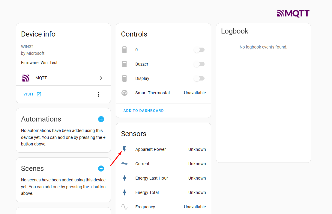

The easiest way in Home Assistant is to change the icon for an already paired device. It can be added earlier through Home Assistant Discovery. Click on its icon:

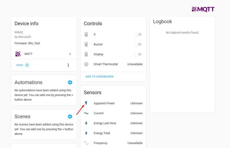

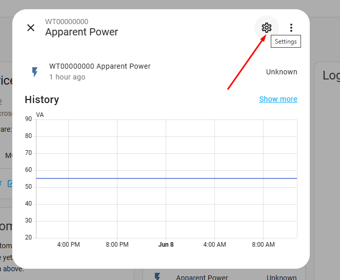

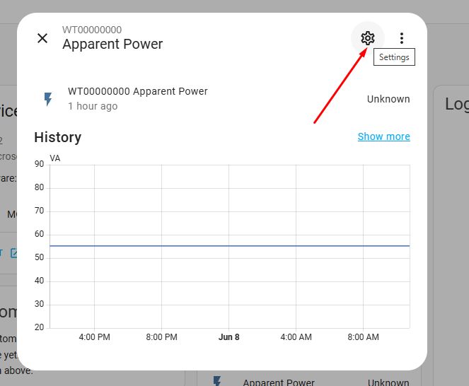

Then we enter the settings:
Screenshot of a Home Assistant entity card showing a graph and the settings button highlighted. .

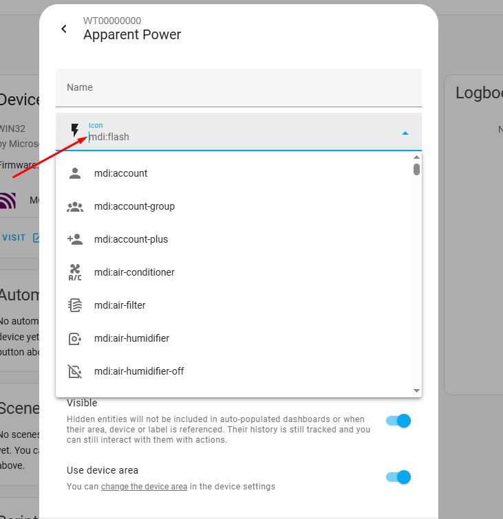

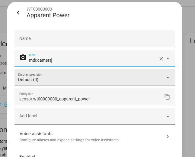

We select the icon from the drop down list:
A fragment of the Home Assistant interface showing the entity icon selection window with the MDI icon list displayed. .
The icon has been selected:
Entity settings window Apparent Power in Home Assistant with the mdi:camera icon selected. .

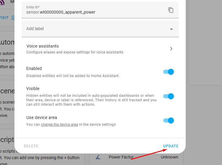

Click update:
Entity settings editing window in Home Assistant with the UPDATE button highlighted in the bottom right corner. .

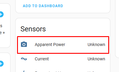

From now on the icon is changed:
Screenshot of the Home Assistant panel showing the Sensors section, with the Apparent Power sensor using a camera icon and status Unknown. .

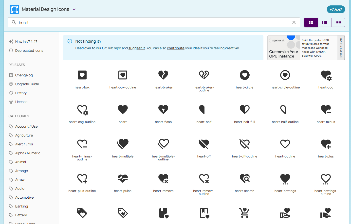

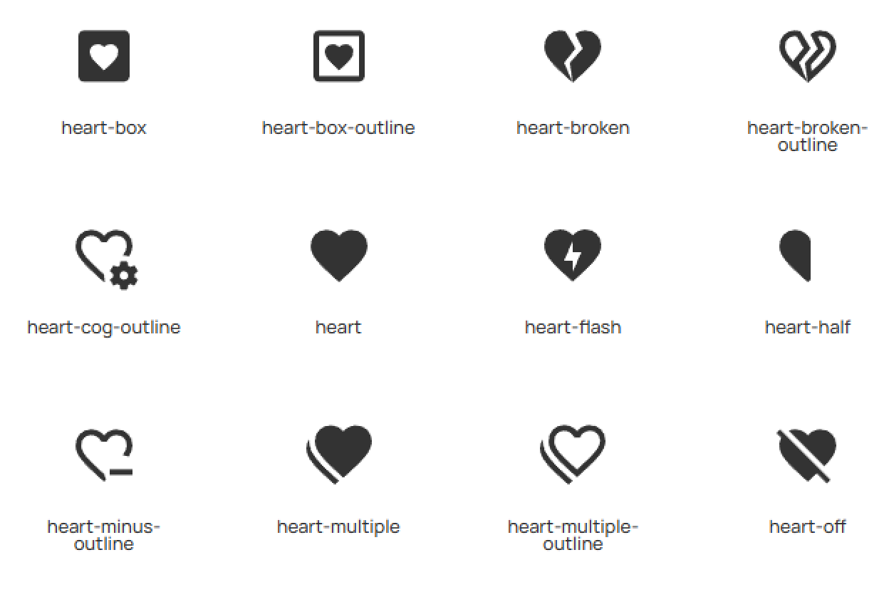

For easier browsing of the icons, I recommend visiting the icon library:
https://pictogrammers.com/library/mdi/
The search engine there is much more readable than what HA offers:
Material Design Icons search results for heart, showing various heart-related icon variants. .

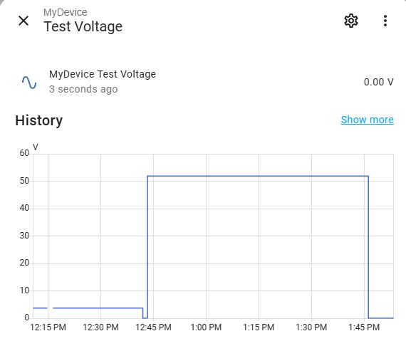

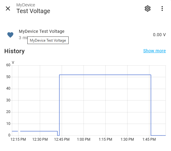

Home Assistant then takes the default icon for the voltage:
Voltage history graph from the Test Voltage sensor in Home Assistant. .

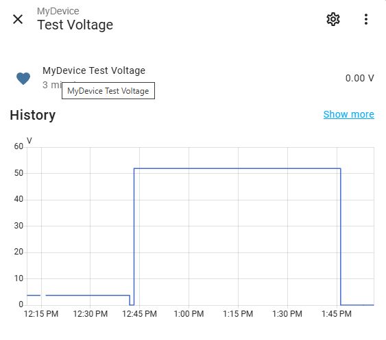

Conversely, if we add our own setting to the JSON:
Then we get:
Voltage chart of MyDevice in Home Assistant interface with a heart icon next to the name. .
In this way, the icon can be changed from not the Home Assistant itself, but from the source device performing HASS Discovery.
