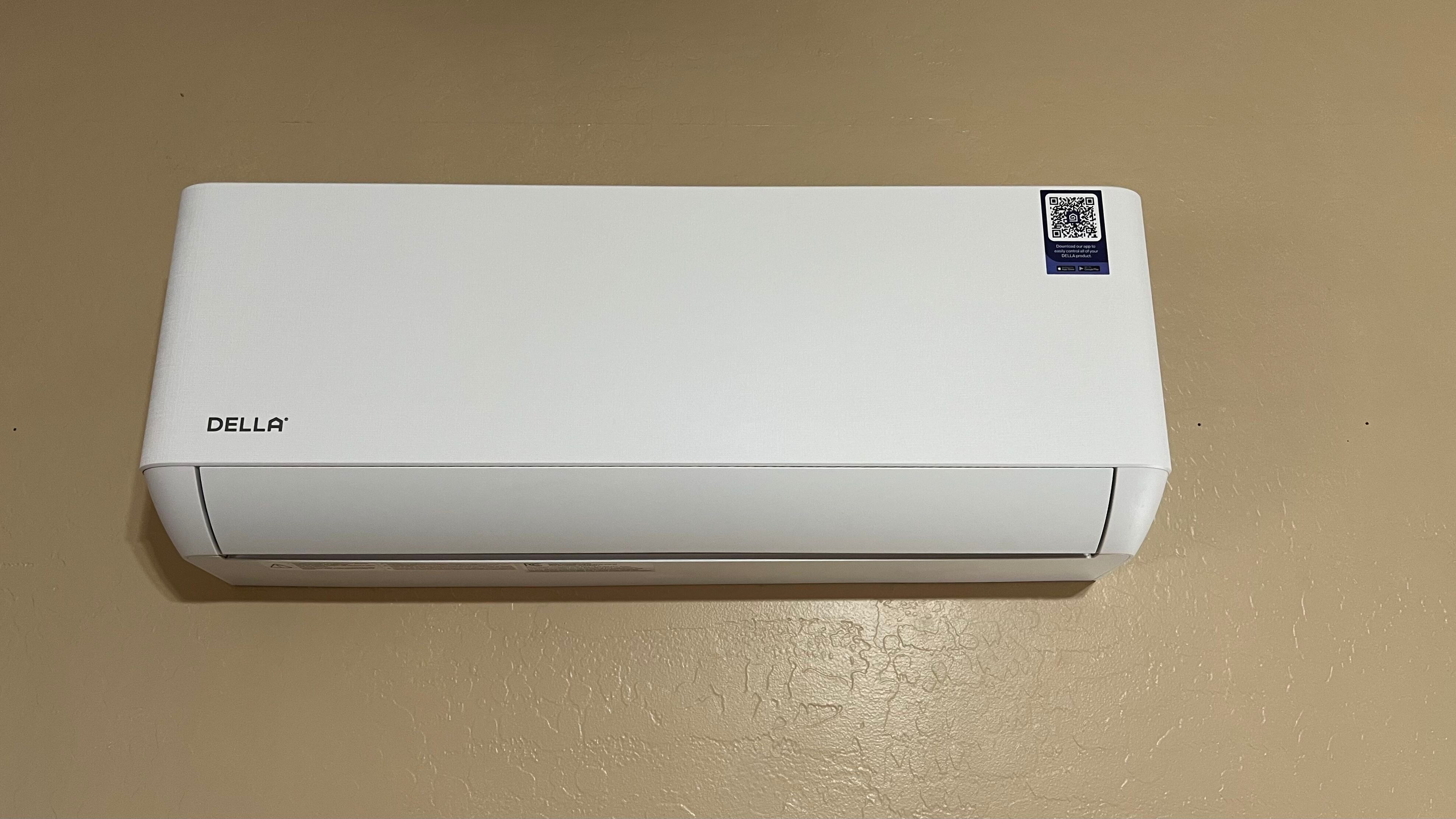

Unit Identification
The Della Optima Series Mini Split is a high-efficiency, wall-mounted ductless HVAC system designed for both residential and light commercial applications. It offers versatile climate control with smart connectivity features.
Manufacturer: Align, Inc. (sold under the Della brand)
Indoor Unit Model: 048-TP-9K2V-23S-IN
Outdoor Unit Model: 048-TP-9K2V-23S-OUT
SEER2 Rating: 23
Cooling Capacity: 9,000 BTU
Heating Capacity: 9,000 BTU
Power Supply: 115V, 60Hz
Features: Wi-Fi control, Bluetooth capabilities, Energy Star rated, Inverter technology
Installation Type: Wall-mounted (Indoor), Outdoor unit with condenser coil
Current Equivalent Model (as of May 12, 2025): Link
The system operates on a 115V power supply and is designed to provide effective cooling and heating in spaces up to 400 square feet. The unit features Energy Star certification, ensuring energy-efficient operation and potential cost savings on energy bills.
The Main Control Board of the system is the TCWBRCU1, which interfaces with the indoor and outdoor units, controlling temperature regulation, fan speed, and other essential functions. The control board also communicates with the WBR3 module, which provides Wi-Fi connectivity for remote access and integration with smart home platforms.
The WBR3 module is based on the Realtek RTL8710BN chipset, a member of the RTL87X0C family, which is commonly used in IoT devices for its low power consumption and robust wireless capabilities. This module is key to enabling the Wi-Fi and Bluetooth features of the mini split, allowing for remote control and automation integration.

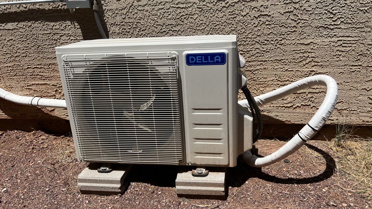

Images of 048-TP-9K2V-23S-IN
(Click to enlarge)
Images of 048-TP-9K2V-23S-OUT
(Click to enlarge)

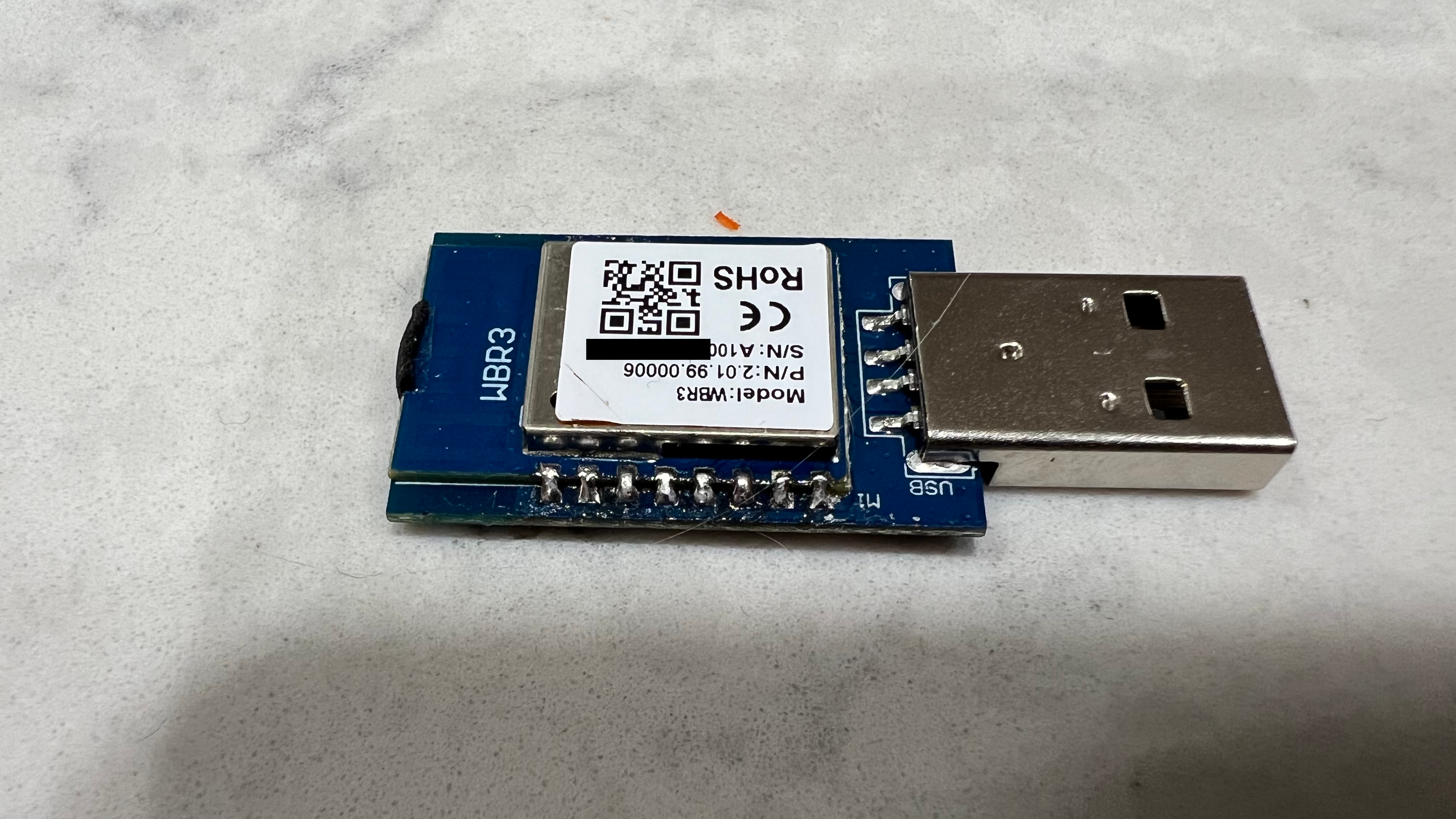

Module Details – WBR3
The WBR3 module is the Wi-Fi and Bluetooth communication module used in the Della Optima Series Mini Split. This module provides the functionality for remote control via Wi-Fi and Bluetooth, allowing the mini split to be integrated with mobile apps and smart home platforms.
Key Features:
•Wi-Fi and Bluetooth Connectivity: The WBR3 enables wireless control and communication with the mini split system, allowing for remote operation through a mobile app or smart home system.
•Chipset: The module is powered by the Realtek RTL8710BN chipset, a low-power, dual-mode Wi-Fi and Bluetooth solution designed for efficient wireless communication.
•Energy Efficient: The WBR3 is designed for low power consumption, ensuring reliable wireless performance without significantly draining power.
Physical Description:
The WBR3 is a small, compact module mounted onto the mini split’s main control board. It is typically connected to the control board via a ribbon cable or a set of pins.
Disassembly Notes & Chip Identification:
While it’s not necessary to remove the RF shield to identify the components in the WBR3 module, I did so during my teardown for further inspection. However, please note that I had already lifted too many solder pads on the chip, rendering it unusable for future flashing. If you're attempting this yourself, I recommend skipping the RF shield removal to avoid unnecessary risks.
If you do choose to remove it, use a heat gun and fine-tipped pliers, or tweezers, with care. Even heat application will help prevent damage to nearby components.

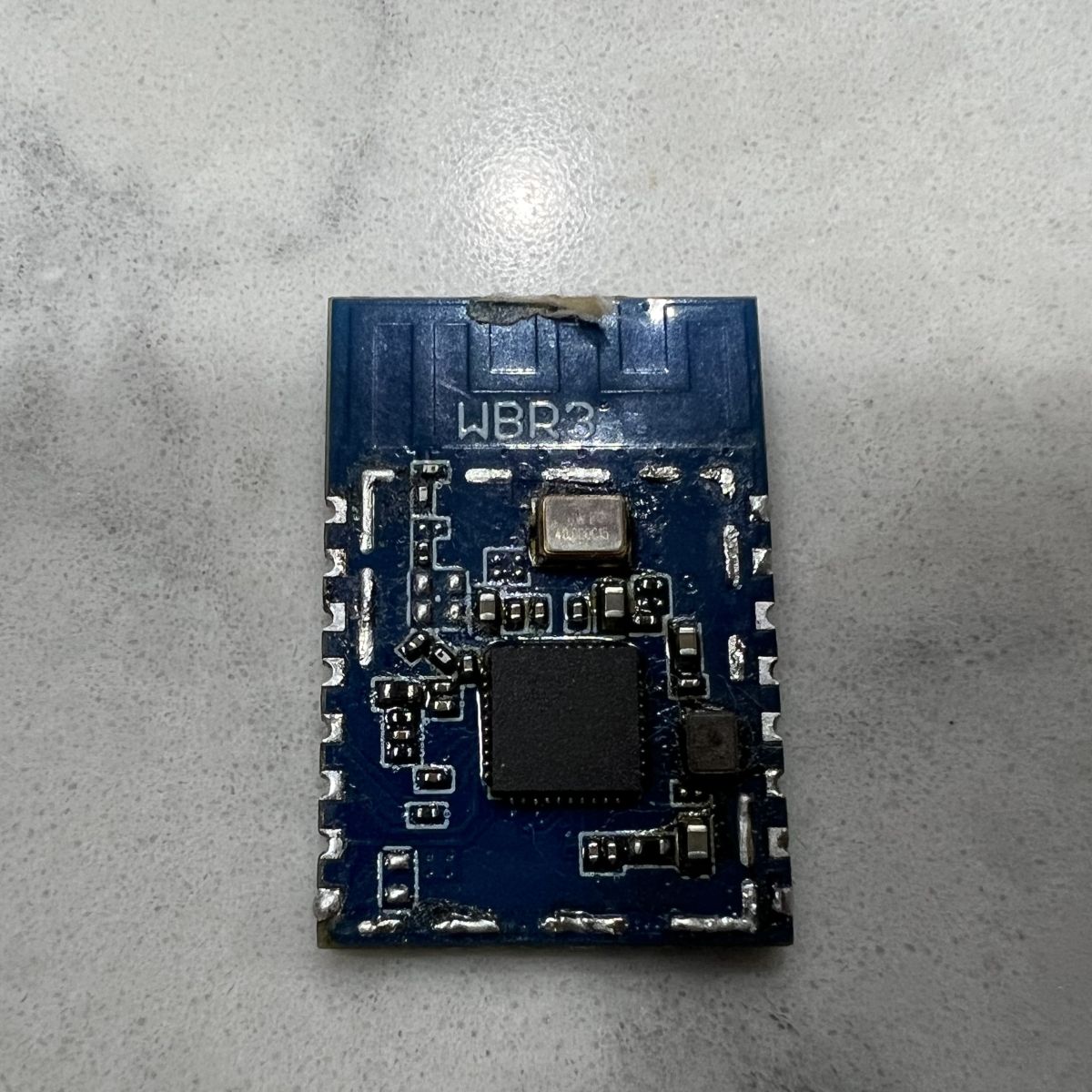

After removing the shield, the following chip markings were visible:
• Chipset marking: W701 N9C91P3 GN37A2 — consistent with the Beken BK7231N SoC
• Flash marking: Not identified in this teardown. However, many WBR3 modules commonly include an 8Mb SPI NOR flash such as the XTX XT25F08B, though exact part numbers may vary by batch.

Images of WBR3 Module
Damaged WBR3 with the shield removed.
(Click to enlarge)

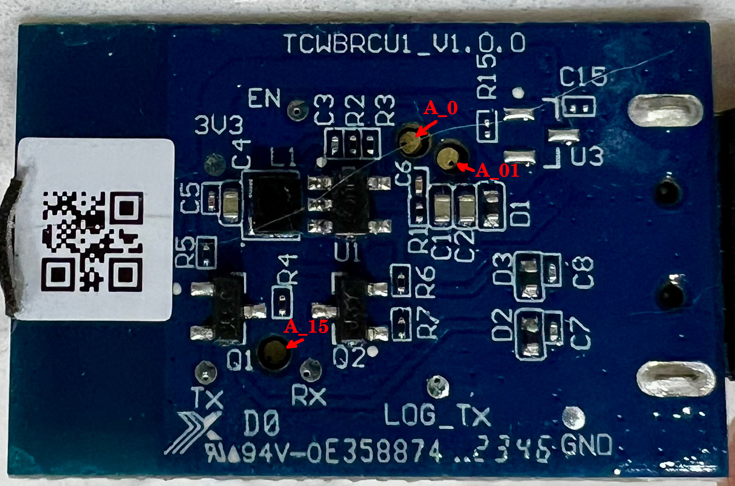

Module Components and Pinout:
The TCWBRCU1 module is integrated into the mini-split system with various key components. The module connects to the control board and provides a bridge for wireless communication. Below are the main components and pins of the TCWBRCU1:
• Wi-Fi/Bluetooth Chips:
The TCWBRCU1 uses chips such as the RTL8710BN (for Wi-Fi) to handle wireless communication. This chip allows the module to interface with wireless networks and Bluetooth devices.
• Pins for External Connections:
The module has pins for power (VCC), ground (GND), and communication (RXD, TXD, EN, etc.) that can be accessed for various use cases, including firmware flashing and further customization.
• Passthrough Holes:
The TCWBRCU1 is designed with passthrough holes that allow for probing or connecting wires without needing to desolder the module. This feature is useful for testing or when you want to interface with the module without physically modifying it.
Connectivity Options:
• Wi-Fi: The module supports Wi-Fi communication, allowing users to connect their mini-split systems to home networks for remote control and integration with other smart devices.
• Bluetooth: Bluetooth connectivity allows direct pairing with smartphones or other devices for easy control without relying on Wi-Fi.
Solder Pads & Pinout Overview:
The TCWBRCU1 has a series of solder pads for power and communication connections, including:
• VCC – Power supply input
• GND – Ground connection
• RXD – Serial data reception (RX)
• TXD – Serial data transmission (TX)
• EN – Enable pin for module functionality
• GPIO Pins – General-purpose I/O pins, including A_0, A_15, and A_16, useful for analog inputs.
Physical Design:
• Form Factor: The TCWBRCU1 is a small, compact module designed to fit easily within the mini-split system, typically mounted on or near the main control board (TCWBRCU1).
• Mounting: The module is generally mounted using either a soldered connection or via a female USB-A connector, depending on the specific unit configuration.
• Accessibility: The module is designed for easy accessibility for maintenance, replacement, or upgrades.

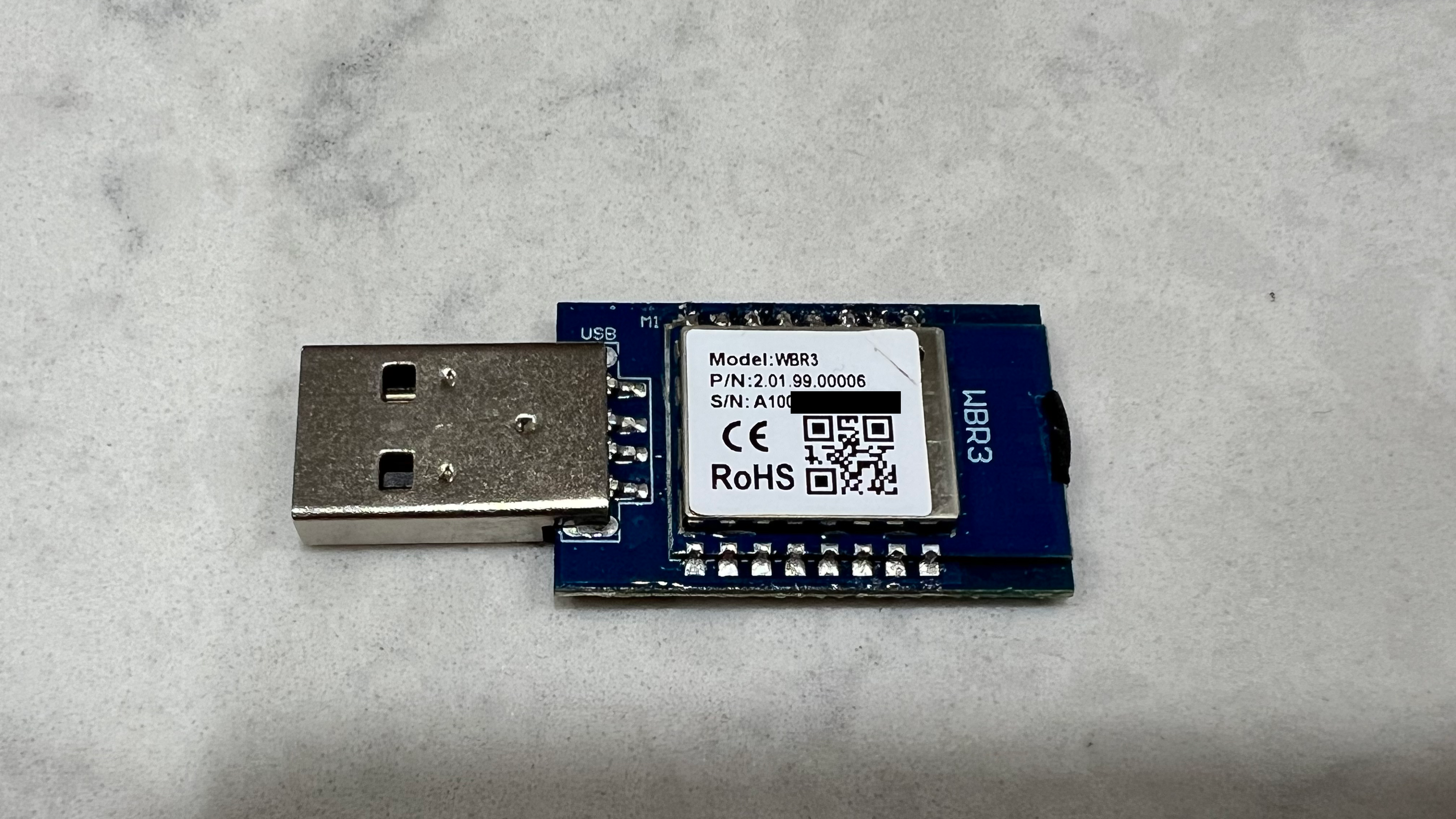

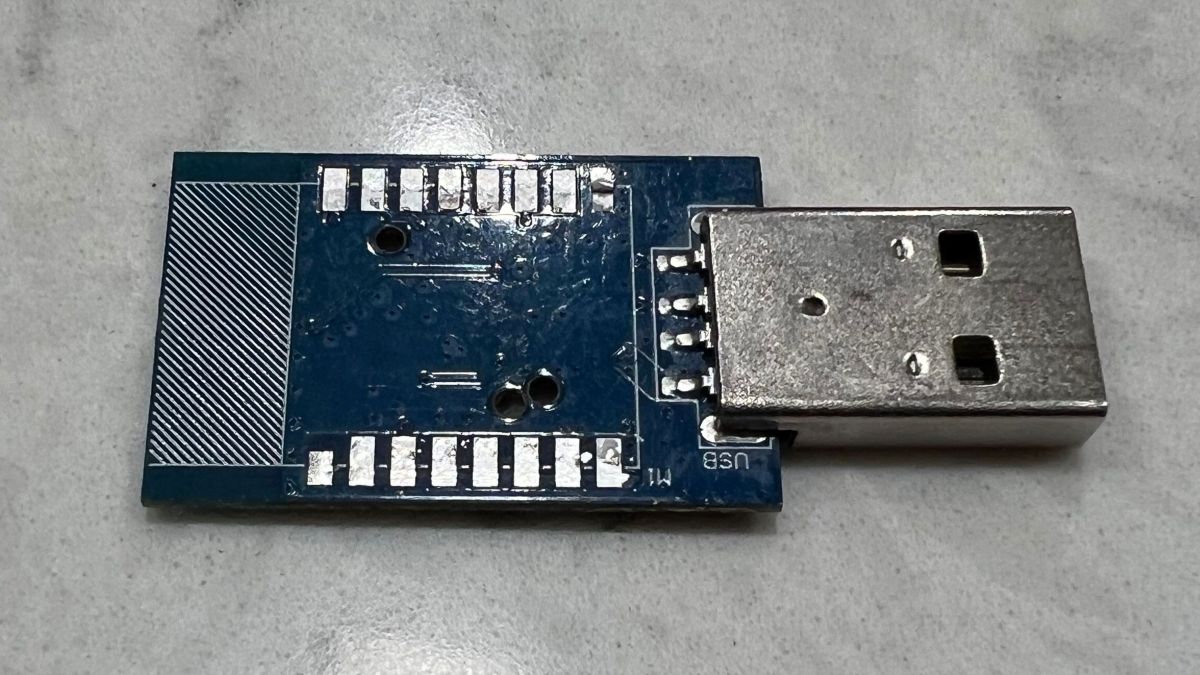

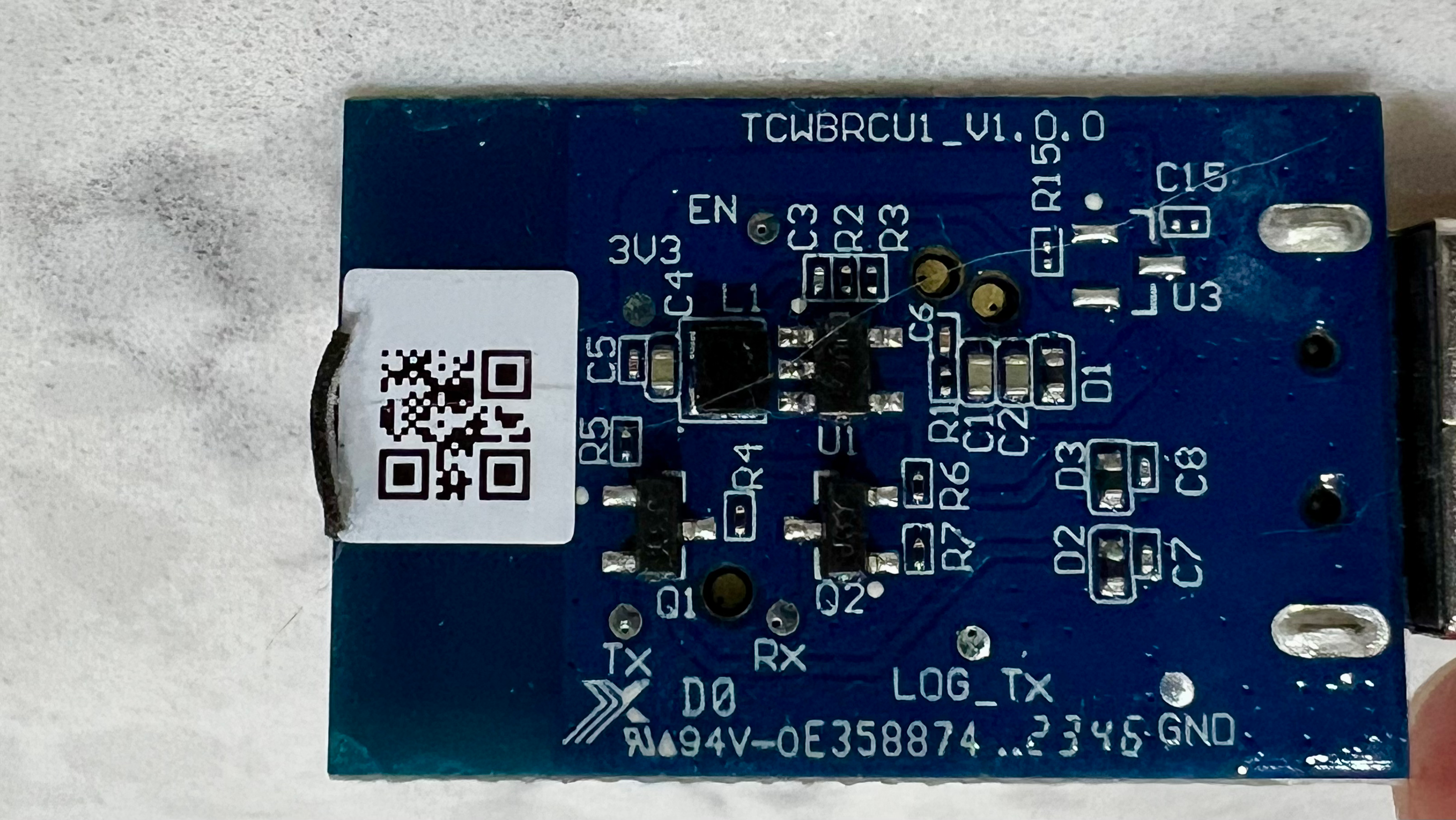

TCWBRCU1_V1.0.0 Images
Top view of the left WBR3 pins while still soldered to TCWBRCU1.
(Click to enlarge)
Top view of the right WNR3 pins while still soldered to the TCWBRCU1.
(Click to enlarge)
Bottom view of the TCWBRCU1 while WBR3 is still soldered.
(Click to enlarge)
Closer image of the bottom view. I am fairly certain these are pass through holes to the WBR3 flashing pins. According to the datasheet, these should be pins A_0, A_1 and A_15.
(Click to enlarge)
View of the TCWBRCU1 with the WBR3 removed.
(Click to enlarge)

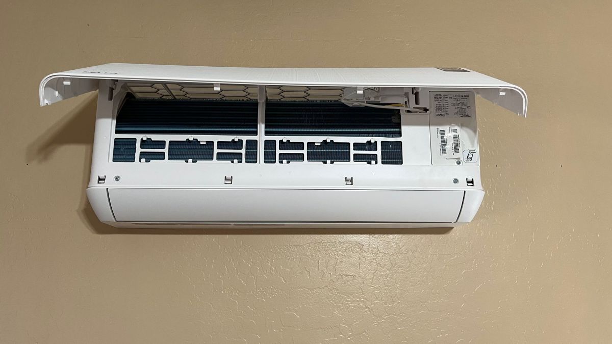

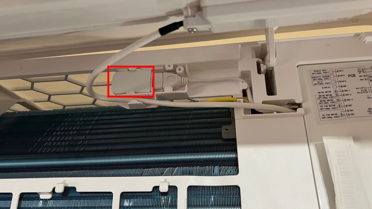

• Open the Front Cover: Start by opening the front cover of the indoor unit to expose the evaporator coil. The evaporator coil is the part with metal fins that helps with heat exchange.
(Click to enlarge)
(Click to enlarge)

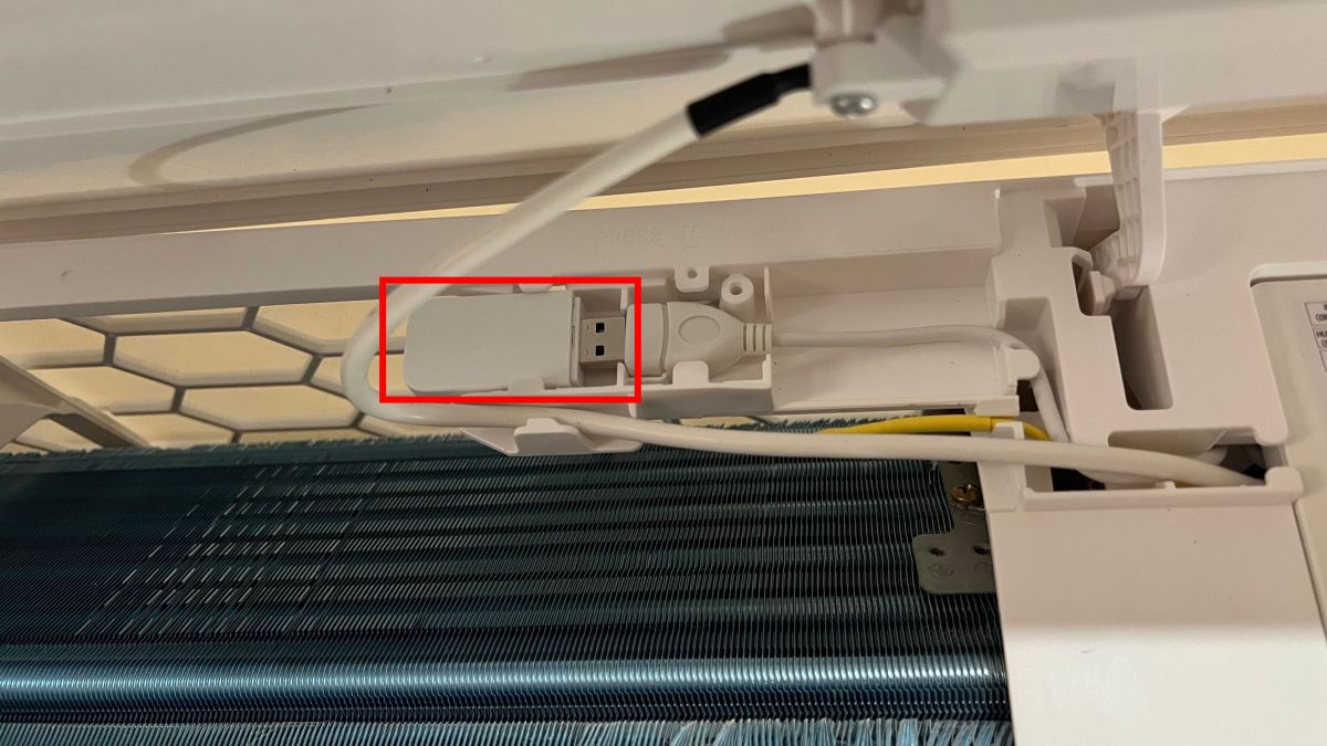

• Locate the Cable: Above the evaporator coil, you will notice a cable running from behind an access panel. Follow this cable to the left.
(Click to enlarge)

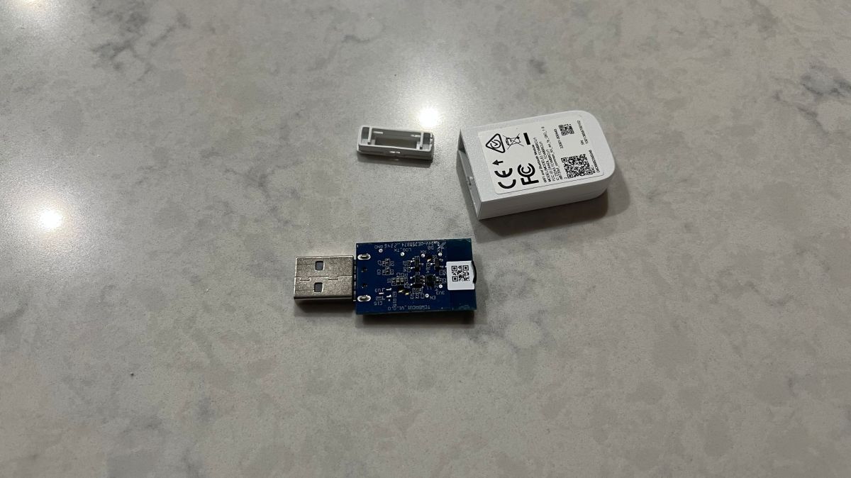

• Identify the TCWBRCU1 Module: The cable leads to a female USB-A connector with a dongle attached. This dongle houses the TCWBRCU1 Wi-Fi/Bluetooth module.
(Click to enlarge)
• Remove the Module: Carefully pull the module out of the cable.
(Click to enlarge)

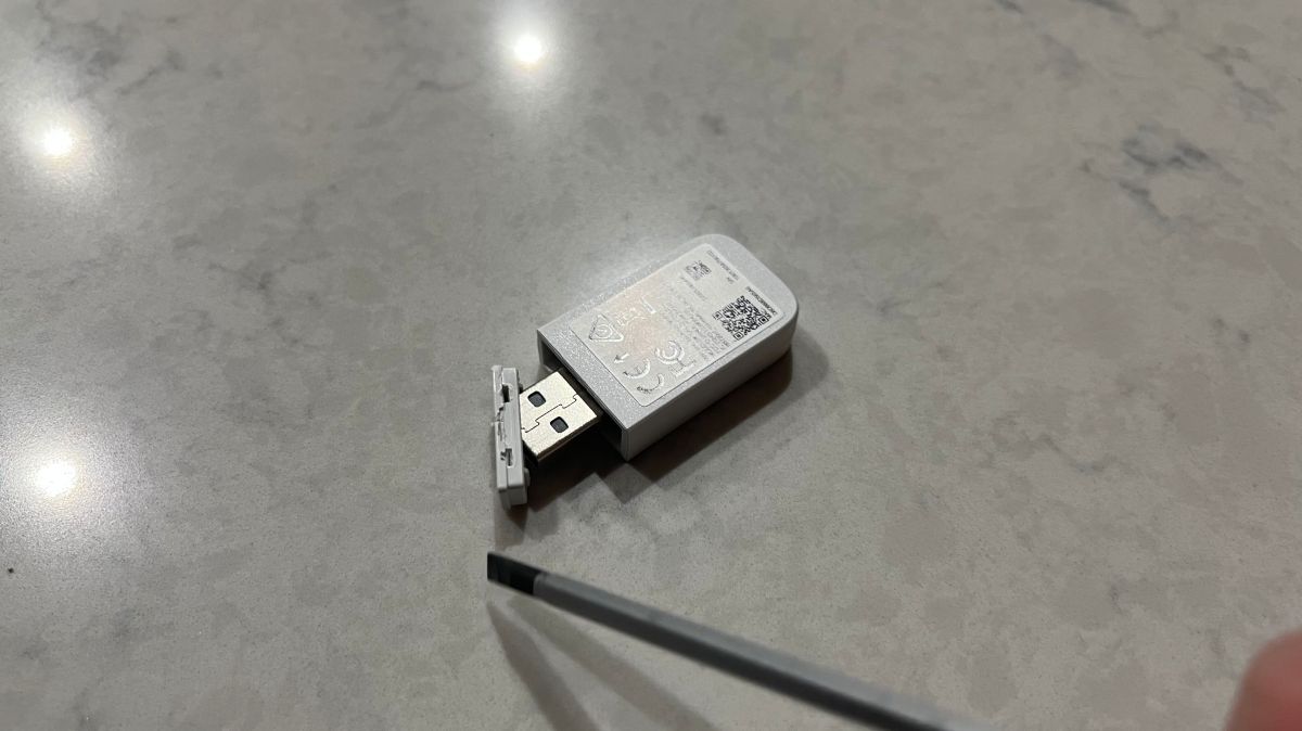

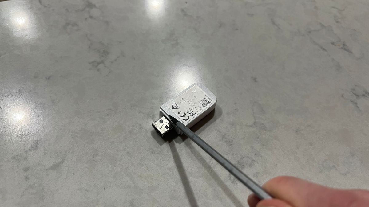

• Open the Dongle Housing: Use a small spudger, pry tool, or small slotted/flat-head screwdriver to gently pry open the dongle’s plastic housing.
(Click to enlarge)
(Click to enlarge)
• Slide the Module Out: Once the housing is open, the TCWBRCU1 module should slide out easily.
(Click to enlarge)

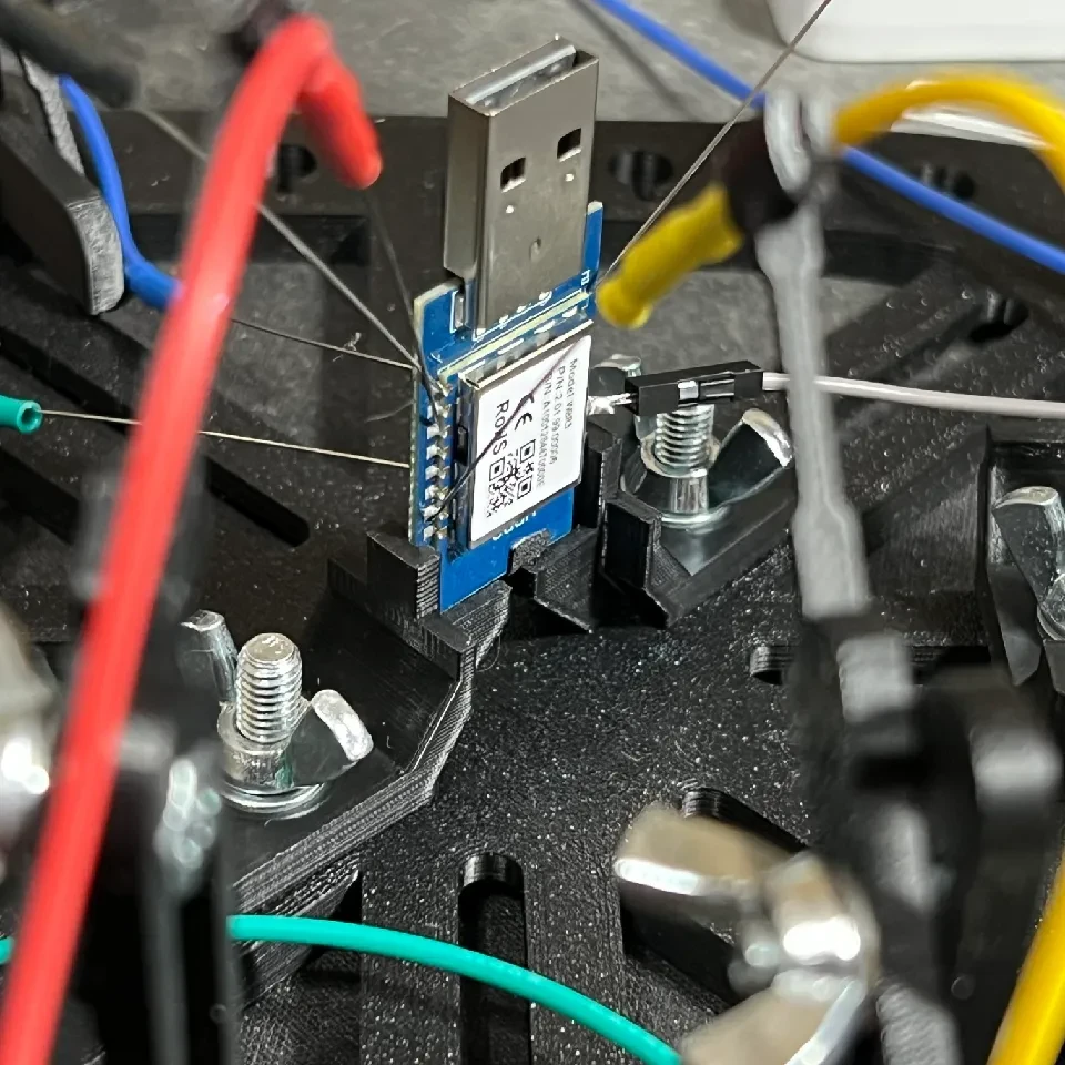

Alternative to Soldering: Using a Probe Setup (optional):
If you’d prefer not to solder the wires to the WBR3 module, there is an alternative approach using a probe setup. The TCWBRCU1 module has passthrough holes, so you can use a setup like the one linked below to probe the pads without desoldering the WBR3:
• 3D-Printed Nano Probes:
I attempted to use a 3D-printed probe setup like the one from this link, which allows for non-invasive probing of the WBR3’s pins. However, I ran into an issue because I was using the incorrect software, which led me to desolder the module before I figured out the mistake.
If you want to go this route, you can try this 3D-printed probe setup, and it may work well for your needs if you’re not comfortable with soldering.
• Remix for Vertical Clamping:
Additionally, I remixed one of the creator’s clamps to hold the TCWBRCU1 vertically, making both the top and bottom of the module accessible. This remix can be found HERE. This modification might be useful if you decide to use probes, as it provides easy access to all the necessary pins.
(Click to enlarge)

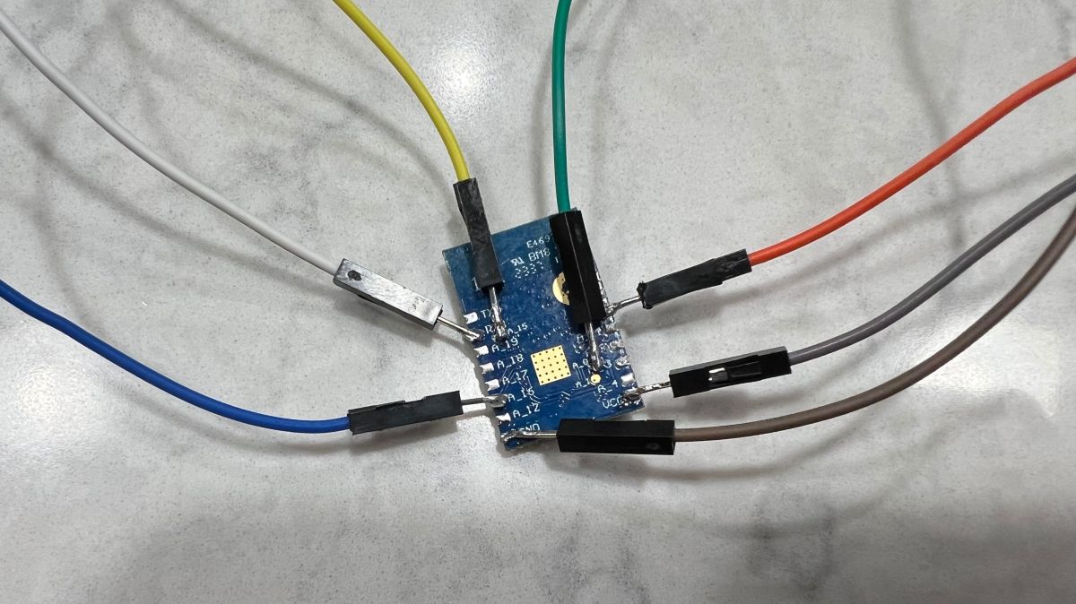

Solder the Necessary Wires:
To work with the WBR3, you’ll need to solder Dupont wires to the following pads:
*A_15 (LOG_RXD) is located on the underside of the WBR3 module.
Use fine soldering wire and a soldering iron to attach Dupont wires to the correct pads on the WBR3 module. Be careful not to apply too much heat, as you could damage the module.
(Click to enlarge)

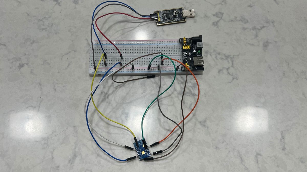

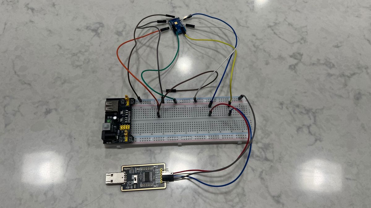

Connect to a Breadboard
Once the necessary wires are soldered, carefully place the WBR3 module onto a breadboard. Ensure that the module is securely seated and that all connections are stable.

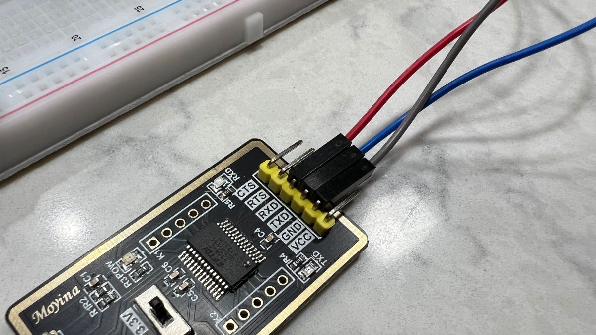

Power Supply and UART Adapter:
Once the necessary wires are soldered to the WBR3, connect the module to the power supply and UART adapter via Dupont cables as follows:
Connection Setup Examples
Note: The images below show the correct wiring connections. Your setup should look similar to these photos. In these images, the brown Dupont cable that is not connected is used for shorting the EN pin to GND during flashing to enter bootloader mode.
Overview of All Connections
(Click to enlarge)
Same Setup from Another Angle
(Click to enlarge)
Close-up of UART Connections
(Click to enlarge)
Close-up of WBR3 Connections
(Click to enlarge)
(Click to enlarge)
(Click to enlarge)
(Click to enlarge)
(Click to enlarge)
(Click to enlarge)
(Click to enlarge)
(Click to enlarge)
(Click to enlarge)
(Click to enlarge)
(Click to enlarge)
(Click to enlarge)
(Click to enlarge)
(Click to enlarge)
(Click to enlarge)
(Click to enlarge)
(Click to enlarge)
(Click to enlarge)
| WBR3 Pin | VCC | GND | A_16 (LOG_TXD) | A_15 (LOG_RXD)* | RXD | A_0 | EN |
(Click to enlarge)
| WBR3 | UART | Description | Purpose | A_16 | UART RX | Connect to USB UART RX | Receives data from WBR3 for communication/debugging | A_15 | UART TX | Connect to USB UART TX | Sends data/commands to WBR3 | A_0 | — | Connect to 3.3 V power supply | Enables bootloader mode during flashing | RXD | — | Connect to 3.3 V power supply | Enables bootloader mode during flashing | VCC | — | Connect to breadboard 3.3 V power supply | Powers the WBR3 module | GND | — | Connect to breadboard ground (GND) | Completes electrical circuit and common ground reference | — | GND | Connect to breadboard ground (GND) | Common ground reference between UART and WBR3 |
(Click to enlarge)
(Click to enlarge)
(Click to enlarge)
(Click to enlarge)
