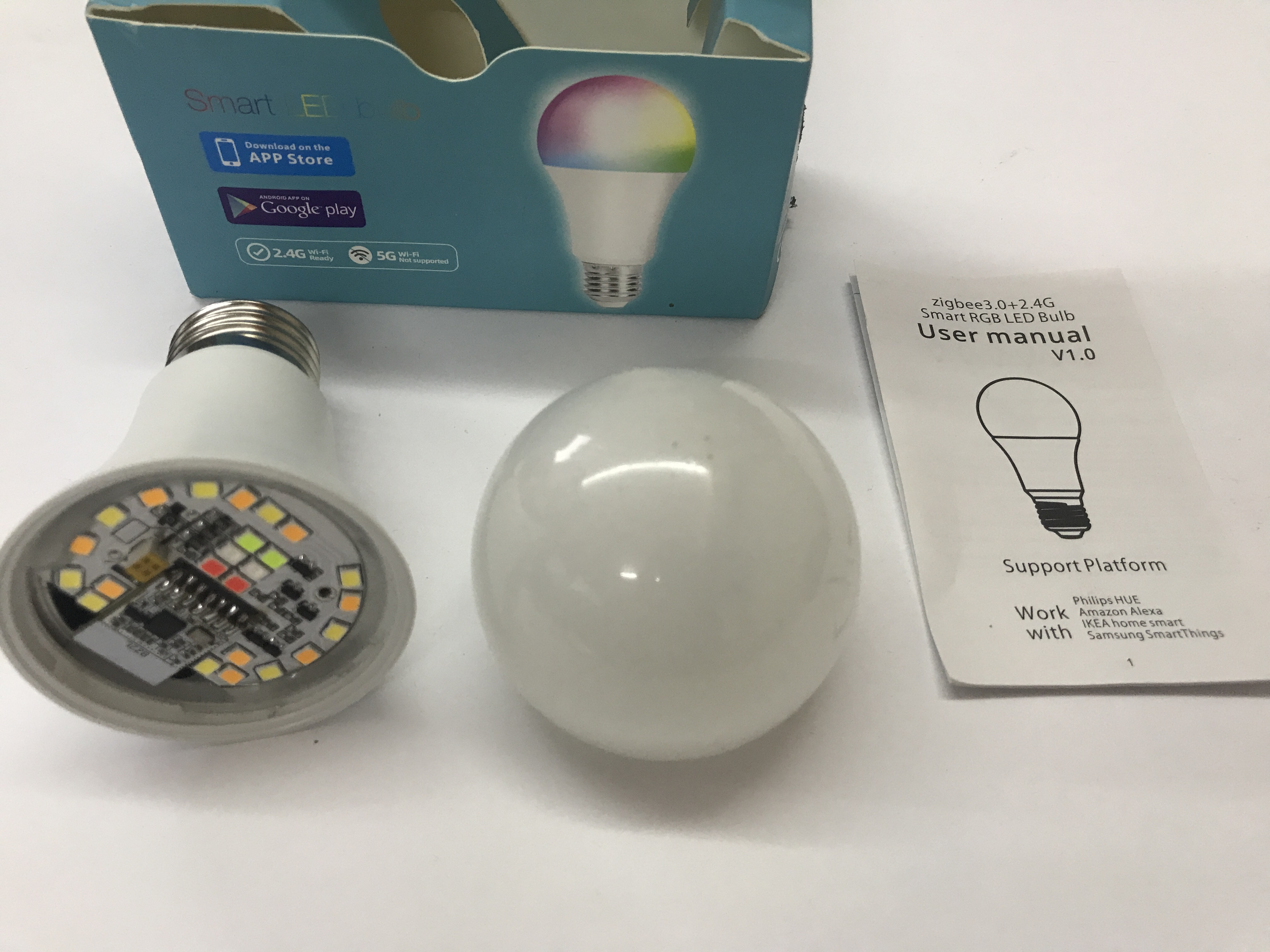

I purchased the LED bulb, also incorrectly known as the 'LED bulb', from a Chinese portal with free shipping for around PLN20. After two weeks, I received such a box:
The packaging is very generic and designed for different versions of the product. Only you can see that the employee marks in squares which version we have inside.
The markings on the packaging are EZ-A60-18W=C. The A60 model is very popular and also used in WiFi-controlled products.
There is also a manual inside. It tells us how to activate the pairing mode if it does not start up by itself. All you need to do is to do three on/off cycles, each transition with a second pause.

Finally, I checked the inside of the product.
For Zigbee-based devices this is not necessary for anything, I just did it out of curiosity. I removed the dome:
The whole assembly is based on the BZ2L module, or BL702. This module controls five transistors via PWM, one per channel. The module reminds me of the BW2L, or its equivalent on WiFi:
Instructions for flashing the eWeLink RGBCW lamp series - module leads BW2L, BL602 .
The Z in the name stands for Zigbee and the W stands for WiFi.
You can read and write its Flash memory using this method:
How to read and back up the flash memory of a BL602/BL702/etc device using BLDevCube?.
However, it needs to be soldered beforehand, as its programming pads are on its underside.
