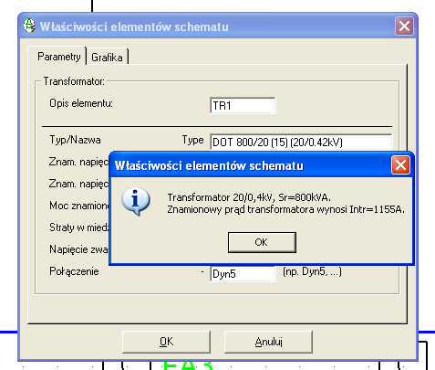

    I have two 15/0.4 kV transformers at work with a capacity of 800kVA each. During the last survey and measurements, it was recommended to hang plates in the transformers' compartments with the transformers' short-circuit power and with the cross-section of the earthing switches. On the RWN switchgear we have such a plate posted.
    I'm not sure if I'm counting this power correctly, so please have someone check it for me and if necessary help me calculate it.
    From the documentation of the transformer and the nameplate I read that:
    short-circuit voltage Uz = 5.74%
    nominal current In = 1155A
    I assumed, That since during a short circuit at Uz I have a current on the secondary side In then at full voltage on the primary side when the secondary side is shorted, the current will be Is = 100/Uz * In. This gives Iz = 34.843 kA and multiplying this by the voltage on the secondary side of 400V I would get Sz = 13.937 MVA or about 14MVA.
    Did I approach the subject correctly or should it be calculated in a different way?
    I'm counting on help
    Greetings

    You have a transformer with Pn=800kVA, which gives In=1155A.
    How did you come up with 2kA?
    Parallel operation?
    With the earthing switches on the two trays in place, it is unlikely that someone on medium would switch on two transformers at the same time. That they should not be attached is stated in health and safety regulations. Moving on. For parallel operation, you can assume a current of 2kA, but then you don't have the option of putting earthing switches on. It is the equipment that must be selected for such a short-circuit current, if the instructions provide for parallel operation of traf.
    Further.
    With one hit as already stated here, you have overestimated the short-circuit current twice. Further on, this is just the result of incorrectly assuming the output data. Reduce the transformer's znamian current and you'll have it all figured out.

    The short-circuit current of the 800kVA transformer is at a level barely exceeding 18kA, if we are talking about the instantaneous three-phase short-circuit current (rms value). The peak short-circuit current is about 2.5x higher. That's why I gave some cross sections, giving some food for thought.
    At medium voltage, the cross section of the grounding conductor is sufficient. It can handle even 25mm2. After all, the insert itself has the property of limiting short-circuit current.

    My calculations came up with a short-circuit current of a little over 20kA and short-circuit power of almost 14 MVA (and such I will write on the plate) while, as my colleague wrote earlier earthing conductor I will use 50mm2 (on the lower voltage side) a accountants should worry about where to get the money :)
