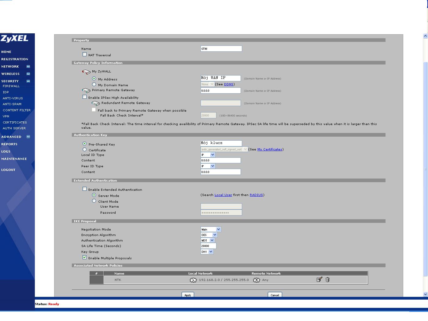

    I set up the router as in the attachments.
    Now, how do I set the options on my laptop to make it work.
    Because I've been trying for two days and it doesn't work; /
    I do it as follows.
    I create a new connection through the create connections wizard in windows 7. There is an option to create a VPN connection. I choose it and set it in the properties like this:
    Host name - My router's address (WAN address)
    Virtual private network type - automatic (I also tried other options but it also does not work. In the advanced settings, I enter the password that I set in the router)
    Data encryption - require encryption (other options I tried and didn't work either)
    Authentication - Second option (Allow the use of these protocols).
    And now when I give connect, I am prompted for a username and password.
    But I didn't set anything up in the zywall. If I give OK without typing anything, it seems to start to connect, but after a while an 800 error will appear that the remote connection cannot be established.
    In the firewall I have set it to pass traffic through VPN (In the router).
    I have nothing in the router logs about negotiating a VPN connection with my laptop.
    I have a laptop on my private network 192.168.137.0
    What am I doing wrong ???
    Because I have no idea what other options to change and where, i.e. on the router or laptop

  • #16 12586499
    bartekb24
    Posts: 420
    Rate: 27
    Nobody has any idea how to configure it?
  • #17 12586537
    Kostek7
    Posts: 1245
    Help: 92
    Rate: 61
    You have selected the server mode with authentication from the local router's access base, so as login and password as for the router.
  • #18 12586587
    marek1712
    Posts: 183
    Help: 16
    Kostek7 wrote:
    authentication
    WHAT !! ??
    AUTHENTICATION
    Back to the topic. I guess I mentioned that you are supposed to do this with a Shrew Soft client (not a Windows client). If I have a moment in the evening, I will try to write what and how.
