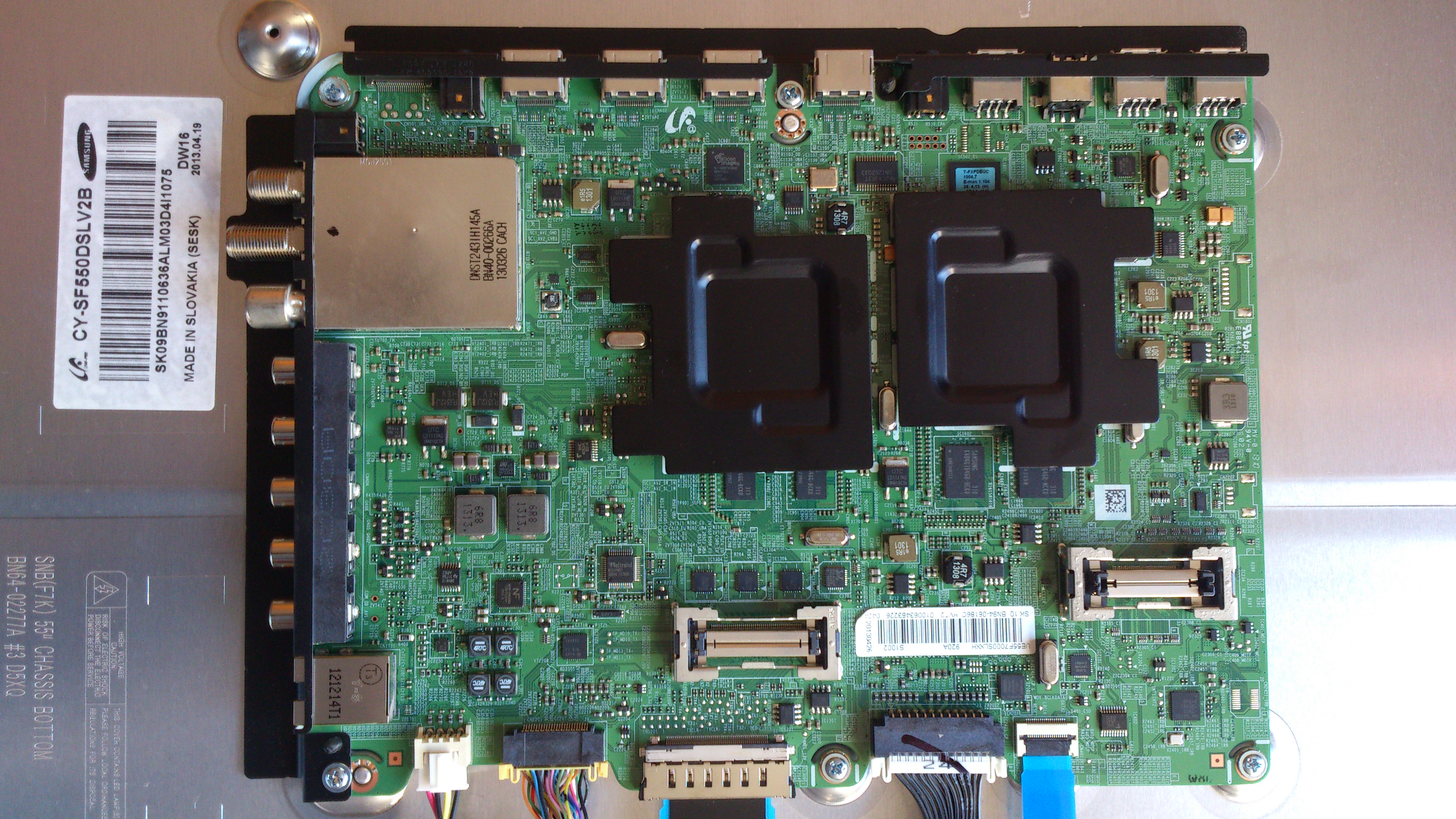

    Hello. Samsung UE55F7000SLXXH TV only switches on temporarily. "Smart TV" appears on the screen, then four icons and turn off. Then the sequence is repeated many times. I checked the CY-SF550DSLV2B matrix backlight, it is functional, as well as the BN44-00633B power supply. The remaining BN94-06186C motherboard and its software. I can not change it or reset it and I decided to replace the whole motherboard. The problem is the price of the "C" version because "A" is half cheaper and here the question - what do they differ? Maybe some of your colleagues have used?

    Samsung UE40F7000AT BN94-06186N (pcb: BN41-01973A) CY-SF400DSLV2L
    Samsung UE40F7090SL BN94-06186A
    Samsung UE55F7090 BN94-06186C (pcb: BN41-01973A)
    Visually the same, it can be
    - problem in matrix software?
    - 2D / i_or 3D support
    Is a T-con for UE55F7000SL XXN CY-SF550DSLV2B (pcb: BN41-01939A)
    price around Link
