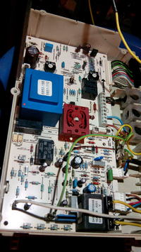

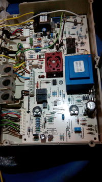

  • #8 16346155
    cynamonik
    Posts: 856
    Rate: 143
    I am attaching photos from inside the furnace control board housing. Anyone know where the air temperature sensor is?
    JUNKERS Euroline ZW / ZS 23 KE - single-function boiler, frost protection JUNKERS Euroline ZW / ZS 23 KE - single-function boiler, frost protection JUNKERS Euroline ZW / ZS 23 KE - single-function boiler, frost protection JUNKERS Euroline ZW / ZS 23 KE - single-function boiler, frost protection

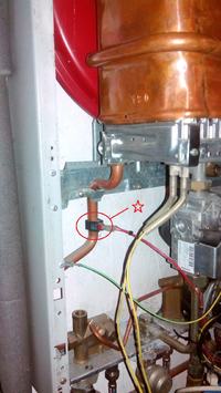

  • #9 16348001
    12B
    Level 21  
    Posts: 237
    Help: 55
    Rate: 139
    Frost protection is implemented on the "command" of the supply NTC sensor mounted on the supply pipe under the heater.
  • #10 16348233
    cynamonik
    Posts: 856
    Rate: 143
    12B,
    it will be the flow temperature sensor No. 36 from the diagram below and marked in the photo with a red circle with an asterisk?
    Perhaps the removed furnace housing causes faster cooling of the liquid in the tubes near the NTC sensor and thus faster switching on after the heating cycle. initially this symptom matched the air temperature as a reference.
    will insulate / cover with some non-flammable material (rock wool?) this section .. and see if the time to switch on will change.
