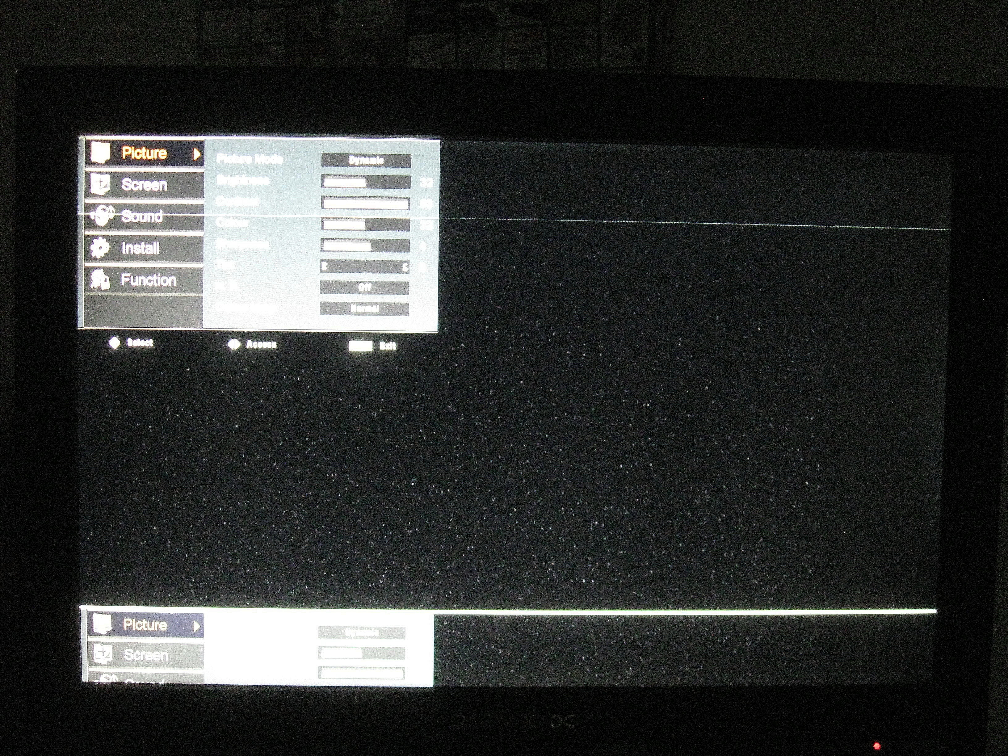

    Hello!
    I received on the DAEWOO DLP-22W4B LCD that will not start.
    However, I would like to restore this TV for usability.
    The main board has the inscription SL-150T, DLT-19W4.
    It is controlled by the FLi 30602H 9C827013 processor,
    and on her memories:
    - IC 504 24C32W6 (memory)
    - IC 505 25X16AVSIG (falsh memory)
    I see that there was already interference associated with memories, because there are traces of their ineffective soldering.
    I desoldered both memories again and on the programmer, eg IC 505 (25X16AVSIG)
    has only saved FF, FF .......
    I would ask you to send me the SL-150T chassis with all data; memory, flash etc.
    greetings

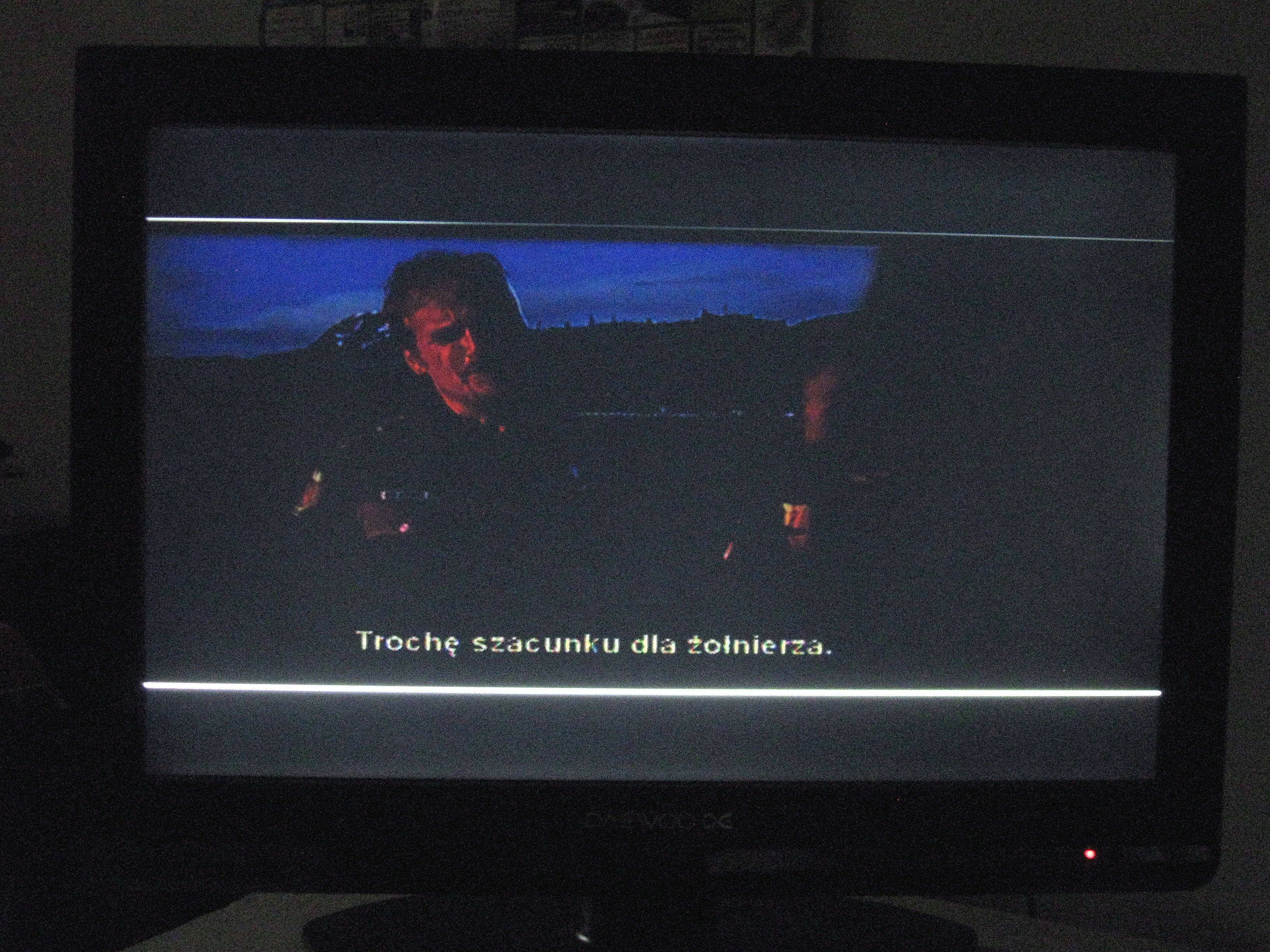

    Hello !
    I downloaded the electrode pads and programmed using "TL866A".
    And I still have a problem with the picture.
    I think you need a R-34SVC service for this TV model.
    I do not have such a pilot. Maybe someone from the forum, I could rent a service pilot for me.
    I am also asking for other suggestions regarding this repair.
    Greetings !
