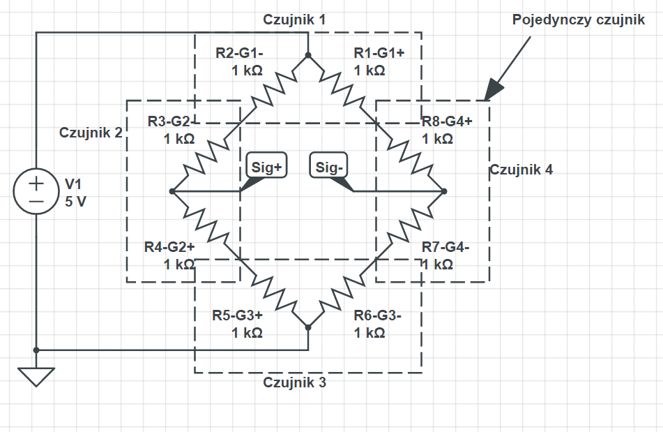

    To the point - I have a problem with understanding the operation of strain gauges.
    I use four sensors that can be found in virtually every electronic bathroom scale. They look like this:
    Understanding Strain Gauges Operation in Electronic Bathroom Scales: A Query
    I have drawn a diagram of such a weight:
    And now I have a question because I understand that it gets a variable voltage at the output depending on the pressure on the sensors, I know that.
    I also know how the Wheatstone bridge works, but I'm not sure what it looks like here ...
    As I figured it out, for each sensor there is one resistor (wire?) On which the resistance does not change and one on which changes occur and receives a different voltage at the output.
    Further, looking at my diagram, do I understand correctly that for this bridge R2, R3, R6 and R7, respectively, is variable and the rest is constant? I mean, as with the Wheatstone bridge? Then you can simplify R2 and R3 as sum etc. in pairs respectively and I get a normal Wheatstone bridge?
    Maybe a trivial question but I prefer to be sure :D
    Here a link from the English site - https://electronics.stackexchange.com/questio...e-bridges-from-a-bathroom-scale/199470#199470

    As a rule, 4 sensors are connected so that the opposite branches work in the same direction, and differently than adjacent (compression / stretching). it consisted of resistors working equally. The diagram looks ok.
