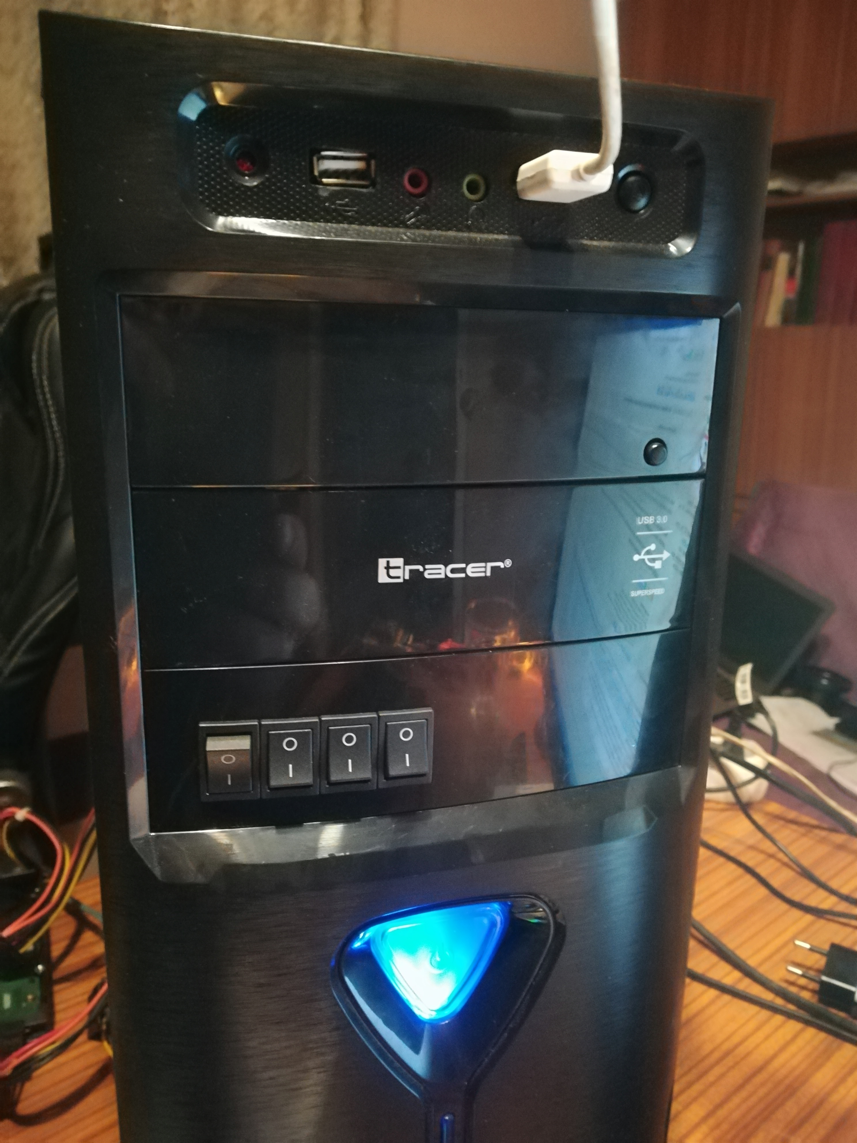

    So far I have used such a somewhat primitive solution, but it works :-D

    Dude Yogi009 ..... I saved the correct GRUB files and coped them to the right place after problems. Sometimes it helped, sometimes not. It goes without saying that GRUB has always worked fine with Windows and one Linux distribution, but GRUB has had different problems with two or more Linux systems. Backup and then restoration is time-consuming, so in my case it is not possible, especially since I backup on external USB drives.
    Added after 3 [minutes]:
    Besides, I never really focused on GRUB. I came to the conclusion that if I choose a distribution that will suit me one hundred percent, I will install one with Windows and it will stay that way :-D
