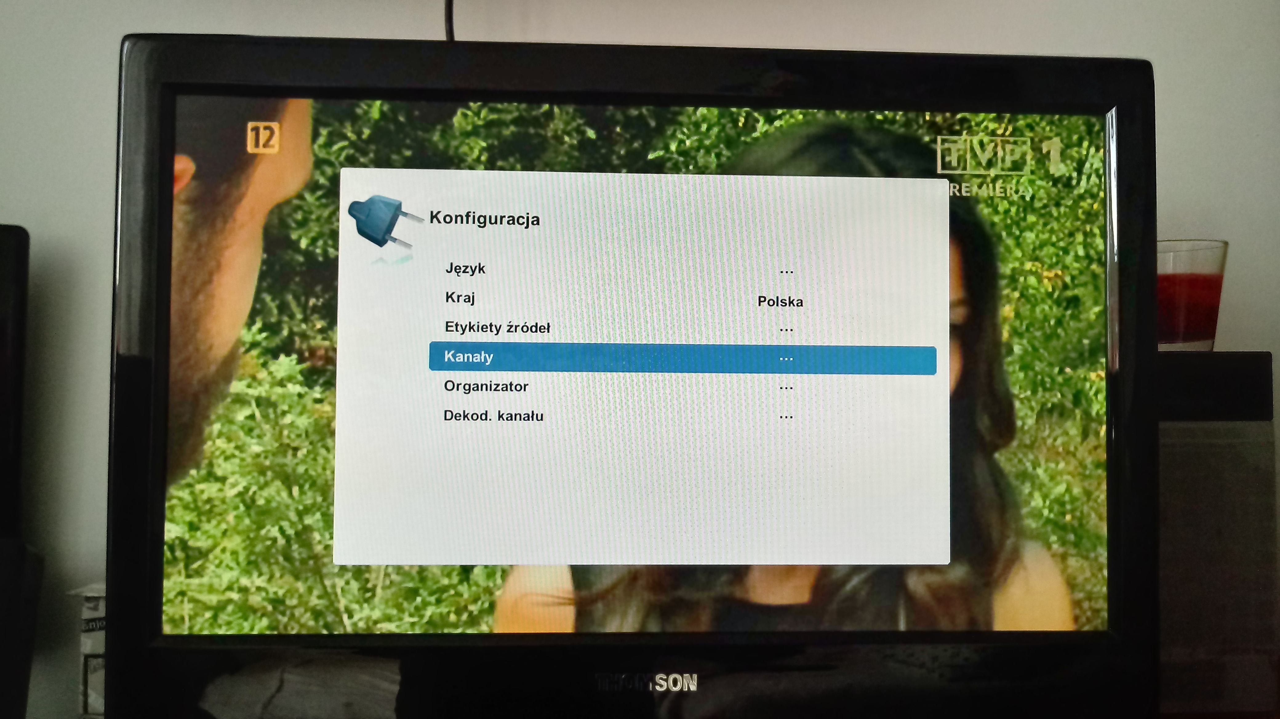

  • #8 17013052
    Borys523
    Posts: 29
    Rate: 13
    The options are Polish. Country Poland. Eastern Europe. The installation carried out automatic channel search as well as manual search only finds analogue channels. After connecting the decoder finds digital programs, without a decoder the antenna is directly connected to the tv. Only analogue channels. Does this tv have a DBV-T decoder for digital terrestrial television according to specification. Does anyone know this tv model.
    Best regards.

    I am speaking for the last time - you will be kind to show us the "Setup" menu of this TV, will we keep drinking like that for another week? ;)

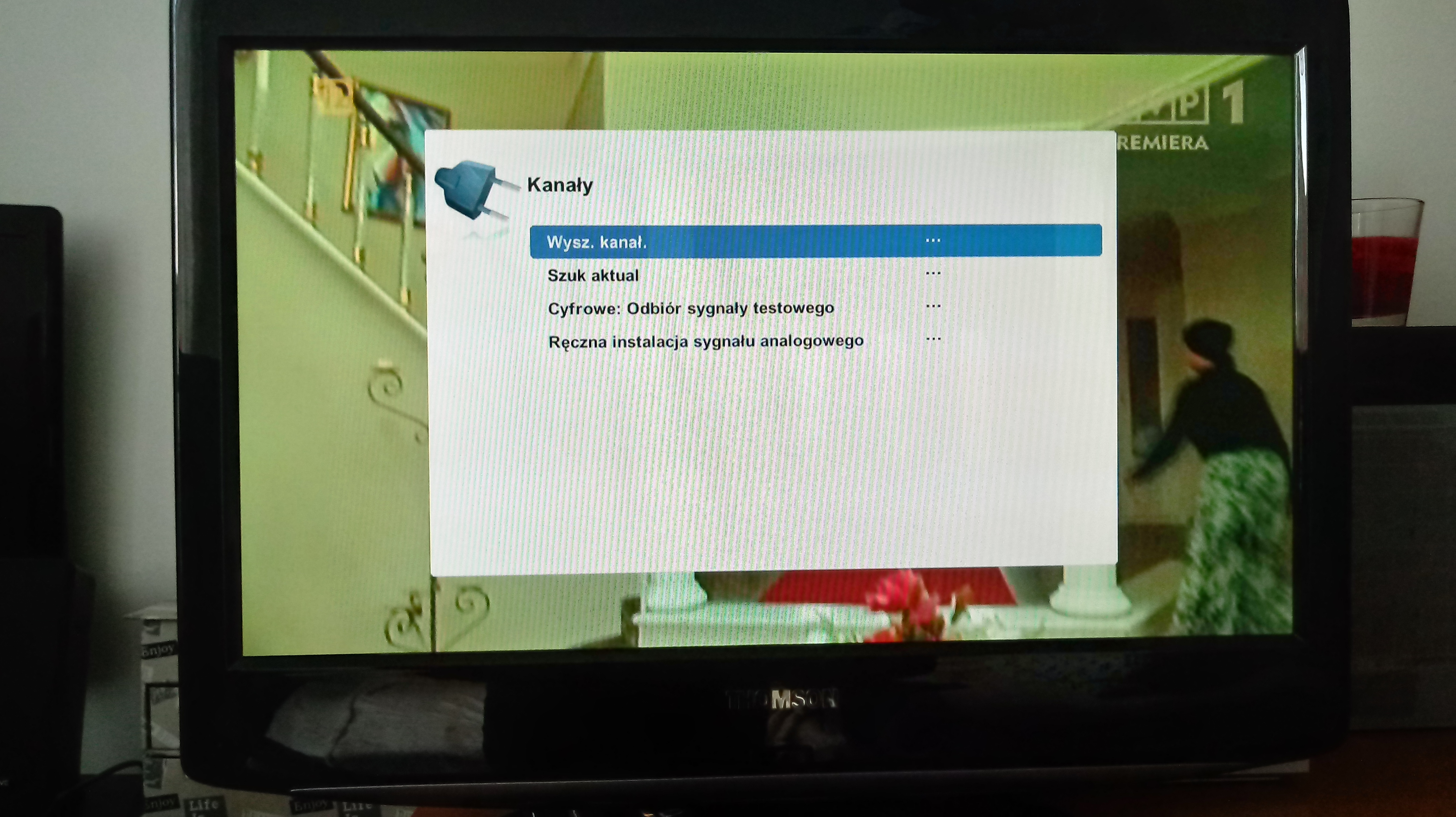

  • #10 17014857
    Borys523
    Posts: 29
    Rate: 13
    Menu dumps.
    After connecting another LG 32 KL 450 TV to the antenna
    the TV has digital channels. Hence my question is whether this Thomson TV has a built-in DBV-T tuner as they give the specification in the specification, because each time it finds only analogue.

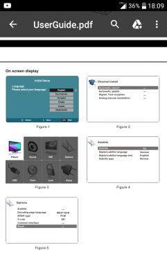

    Thomson wrote:
    Finding only analogue channels by the LCD search function can be caused by a weak DVB-T signal
    Borys523 wrote:
    Unfortunately, the reset option in the OPTIONS settings menu does not happen. Maybe someone has an idea how to reset this TV
    Did you do that ...?
    Thomson wrote:
    1. Press the button Menu on the remote control to select an option Options > reset (Options> Reset) (See fig. 5).
    2. Press the button OK / RIGHT to use the option.
    3. By buttons LEFT / RIGHT select an option OKAY and press the button OKAY to start zeroing
    http://www.thomsontv.pl/serwis/do-pobrania?serie=0&product=17
    http://www.thomsontv.pl/resources/Product/17/pl-PL/UserGuide.pdf
    http://www.thomsontv.pl/resources/Product/17/pl-PL/UserGuide2.pdf

    Borys523 wrote:
    Nothing happens just analog programs
    In what sense is nothing happening? Cannot do the initial configuration on tv or is it only analog after reset?
    Do you receive cable and terrestrial from the same installation?
    After selecting "Configuration" -> "Source Labels" -> TV, is it impossible to select eg "terrestrial tv" divided into digital and analogue?
    Is there a similar breakdown in the "Channel search" option?
    You should check if the TV is receiving a digital signal using the "Digital: Test signal reception" option after entering the appropriate frequencies that the antenna receives. Do you know these frequencies? If not, what transmitter should the antenna be positioned on?
