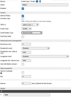

    peete1978
    Posts: 16
    I wanted to connect to the topic:
    I wanted to connect the lighting switch on the terrace with the domotic via WIFI and the MQTT protocol.
    I connected the usual bistable switch via sonoff mini (with the ESP Easy Mega v.20200328 soft loaded) according to the diagram.
    The problem is that it works from domotics, but the physical switch does not, how to fix it?
    In sonoff: I set GPIO 0 to the physical switch, and GPIO12 to the relay as below.

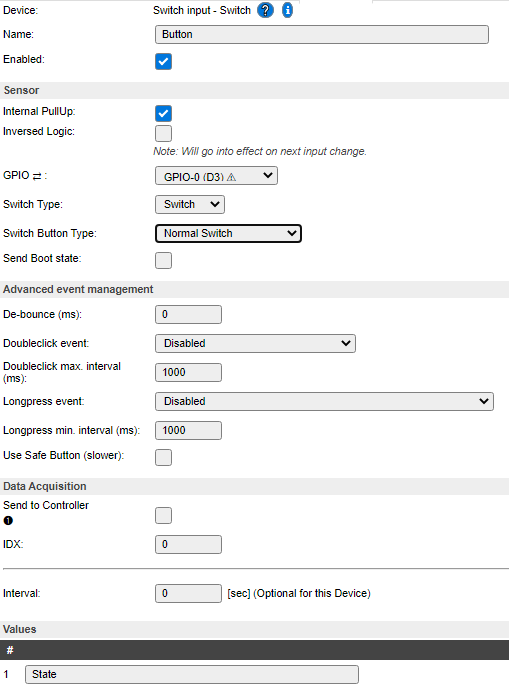

    BUTTON:
    Raspberry, domoticz physical and remote switches, and GPIO pin extension

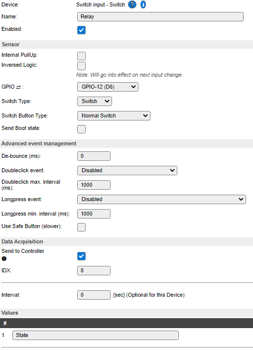

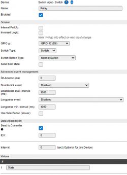

    RELAY:

  • #11 18762405
    starob
    Posts: 1088
    Help: 128
    Rate: 137
    Set BUTTON: IDX = 8 Send To Controler.
    With your settings, you send the switch state in vain.
    If that doesn't work, create a "dummy" switch and assign its index.
    Associate the "dummy" state with Taras
    The physical button should be "bell" because there will be times when you will have to switch it twice

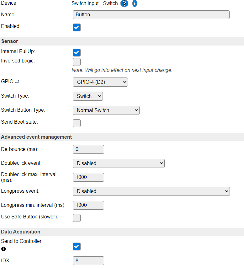

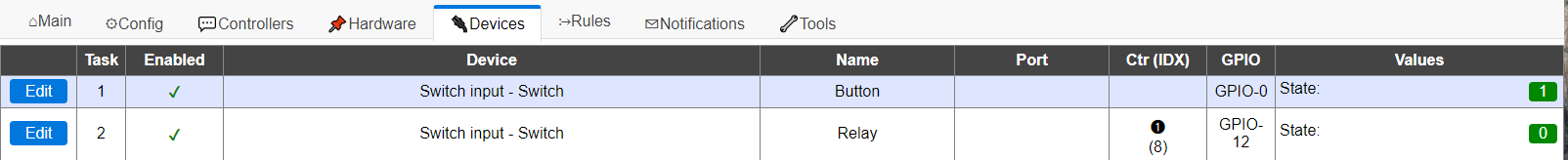

  • #12 18770011
    peete1978
    Posts: 16
    I made changes as posted but it didn't help.
    A friend helped me solve the mystery.
    The problem was the wrong assignment of the GPIO.
    After assigning the BUTTON to the GPIO4, the physical and domotic switch works.
    Thanks for the help.
