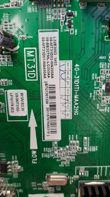

    I am looking for a memory load for:
    TCL L32E3003
    Main: 40-31D1TI-MAA2HG
    Matrix: LVW320NDCL SJ9W01 V6
    Thank you in advance.

  • #4 18402284
    billobirillo
    Posts: 1122
    Help: 336
    Rate: 780
    post a photo of these two labels
    TCL L32E3003 Memory Batch - Seeking for Main 40-31D1TI-MAA2HG & Matrix LVW320NDCL SJ9W01 V6
  • #5 18402325
    tomasz79
    Posts: 136
    Rate: 39

    TCL L32E3003 ,LVW320NDCL, SPI 25Q64,40-MT31TD-MAE2HG.
    • W25Q64_20161214_230741.BIN (8 MB) You must be logged in to download this attachment.

    Thanks for your willingness, but there will be no sound on this. Different audio chip.
    Unless it is possible to change the chip type in service mode. I just don't know the input combination.

    menu,picture,ok,contrast,ok ,9 ,7, 3 ,5 (Thomson ,MT31D, ).

    In service mode it cannot be changed, also the current one.

    Batch found
    • W25Q64BV_20190601_221555-thomson 32fw3323-mb-40-31D1TI-MAA2HG-panel-LVW320NDCL 8J9W01 V5-tuner-DT21WN-soud chip-TAS5707-ok.BIN (8 MB) You must be logged in to download this attachment.
