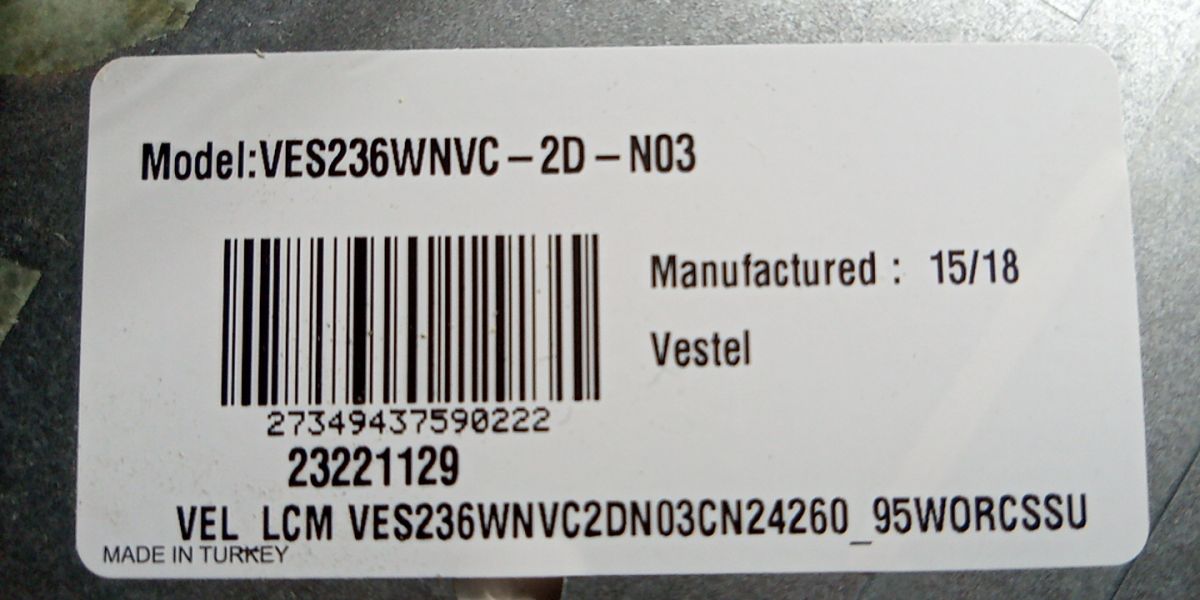

    LCD Screen/Panel (if exist):
    More informations: Cycle on and off
    You see the image for a moment and it turns off and on by itself

  • #4 19539197
    IMAXA
    Posts: 11
    With this file ok for telefunken 24 and sunstech
    17mb82s
    ves236wnvc-2d-n03
