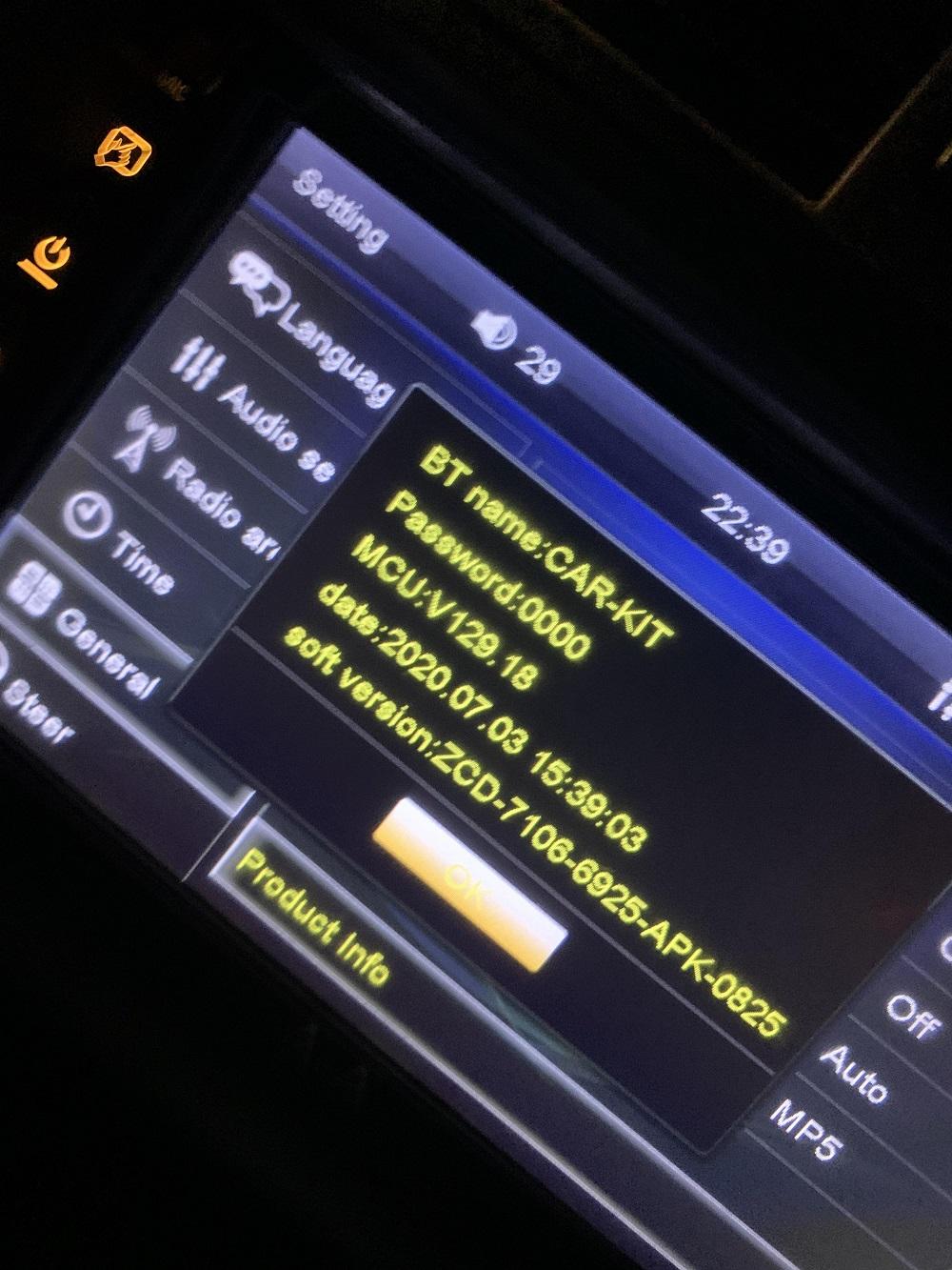

    I HAVE
    CAR-KIT
    MCU;V129.18
    SOFT VERSION ; zcd-7106-6925-apk-0825
    DATE 03-07-2020
    I WANT TO KNOW HOW CAN I FIND OFFICIAL WEBSITE OF THIS PRODUCT OR UPDATED SOFTWARE OR I CAN CHANGE IT TO ANDROID SYSTEM?

    Mine is CAR-KIT MCU:V129.49
    DATE : 2022.02.27
    soft version: ZCD7106-6925- V2.0
    Looking for the website to download the latest version, mirror link and everything is working but I want logo function. Can anyone help please?

    Initial assessment of what you have and what you’re asking
    From your posts (2022-08-09 → 2025-01-22) you have head units labeled “CAR‑KIT” with:
    - MCU V129.18 and V129.49
    - Software strings like zcd‑7106‑6925‑apk‑0825 and ZCD7106‑6925‑V2.0 (dates around 2020–2022)
    - You want: a source (“official website”), a safe update method, and a way to enable a “logo” function (boot logo).
    The key identifier is “ZCD7106‑6925”. In practice, this maps to an unbranded 2‑DIN platform whose mainboard is marked ZCD7106‑C200S‑MAIN and uses an Allwinner F1C200S application SoC. These units are not Android; they run a lightweight vendor UI on top of a small RTOS/Linux stack inside an 8‑MB SPI flash. That is why you won’t find a single official site; firmware circulates only via community/repair forums and seller shares. (test.remont-aud.net)
    Direct answers to your three recurring questions
    - Official website and “latest” files: there is no public, manufacturer‑run portal for the ZCD7106‑6925 platform. Dumps/updates appear on repair forums under the board code ZCD7106‑C200S‑MAIN (various revisions V1.x–V2.x) and as version tags like ZCD7106‑6925‑V2.0 (2021‑10‑16). Treat all such files as hardware‑specific. (remont-aud.net)
    - How to update: there are two distinct pieces of code and two update paths:
    1) The “main system” image in the SPI NOR (25Q64…), updated either from an “update.img” package (if your UI exposes an updater) or by external programming of the SPI flash when bricked. (repairalltv.com)
    2) The small “MCU” firmware (the V129.xx string) that handles radio/SWC; this is separate from the main image and, on some variants, can be updated from a factory menu. Cross‑flashing between close V129 builds can still break radio/touch due to board differences—don’t do it without a board‑exact match. (reddit.com)

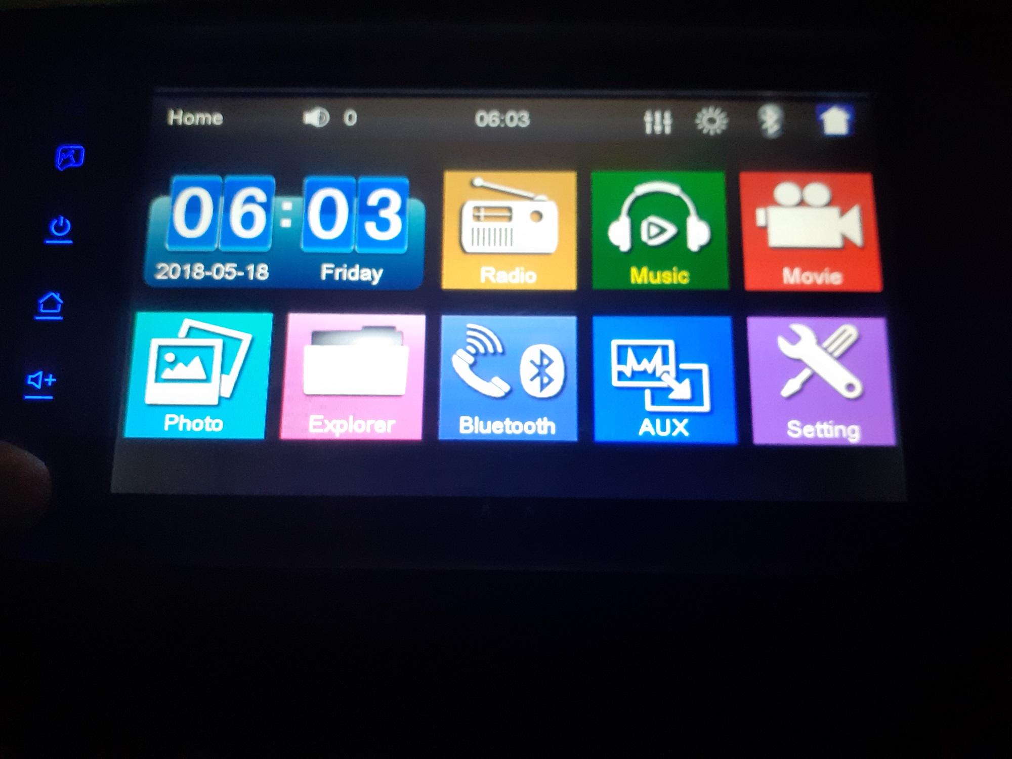

    - Logo function: it is normally in the factory menu. On ZCD7106‑C200S units the common password is 1617. From there select Boot/Car Logo (preloaded logos). Some firmwares also accept a custom image but only if the resolution matches your panel. (test.remont-aud.net)

    - If everything works and you only want a boot logo: use Factory password 1617 and change the logo there—no firmware update needed. (manuals.plus)
