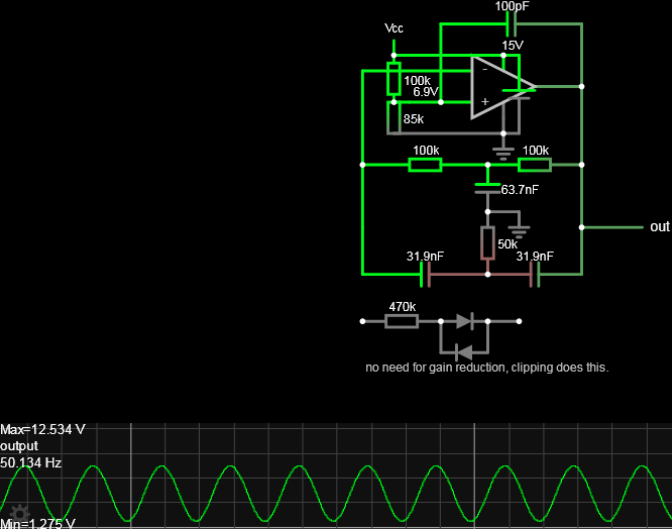

    [b][u]Falstad Simulation Resonant 50 Hz Sine Wave details[/b][/u]
    [attach]1202952[/attach] I know all the fundamentals of Colpitts Osc.
    Tell me the details that help me regulate critical features like distortion and amplitude [center]Simulation of an electrical circuit with a Colpitts oscillator showing a 50 Hz waveform.[/center] stability
    I have a browser simulation here http://tinyurl.com/ymqmbsh3 using Falstad's site and a LTspice model [attach]1202952[/attach]

    The Colpitts oscillator is a type of LC oscillator that uses a capacitor voltage divider as its resonant circuit. The circuit you have shared appears to be a variant of the Colpitts oscillator using an operational amplifier (op-amp) as the active element for amplification, which is not the traditional way of implementing a Colpitts oscillator but is a valid approach.
    In the schematic you provided, the oscillator seems to be designed for a resonant frequency around 50 Hz, as indicated by the values of the capacitors and the inductor (formed by the feedback network and the components associated with the op-amp).
    Let's discuss how you can regulate critical features like distortion and amplitude stability:
    1. Distortion:
    - Ensure that the op-amp is not driven into saturation or clipping. The feedback resistors and the supply voltage should be set such that the output waveform remains within the linear operating range of the op-amp.
    - High-quality capacitors (with low equivalent series resistance, ESR) should be used in the resonant circuit to minimize energy losses and ensure a cleaner sine wave.
    - Make sure the op-amp used has a sufficient gain-bandwidth product to handle the frequencies of interest without introducing distortion.
    2. Amplitude stability:
    - Automatic gain control (AGC) can be used to keep the amplitude of the oscillations stable. This often involves detecting the amplitude of the output signal and adjusting the gain of the op-amp accordingly.
    - Another approach is to use a limiter or a clipping circuit that prevents the amplitude from rising above a certain threshold.
    - A temperature-stable biasing network can help maintain consistent operating conditions for the op-amp, which affects amplitude stability.
    In your simulation, the statement "no need for gain reduction, clipping does this" suggests that the amplitude is being controlled by deliberately allowing the op-amp to clip the waveform at a certain voltage level. This will indeed control the amplitude but at the cost of introducing harmonic distortion due to clipping. If a sine wave with low distortion is desired, it’s preferable to use AGC or another method to control amplitude without clipping.
    To further help you, I would need to know more about your requirements and constraints. Are you looking to maintain a pure sine wave with minimal distortion, or is some level of distortion acceptable? What are the amplitude stability requirements for your application? Do you have any specific constraints regarding the op-amp or other components that must be considered?
