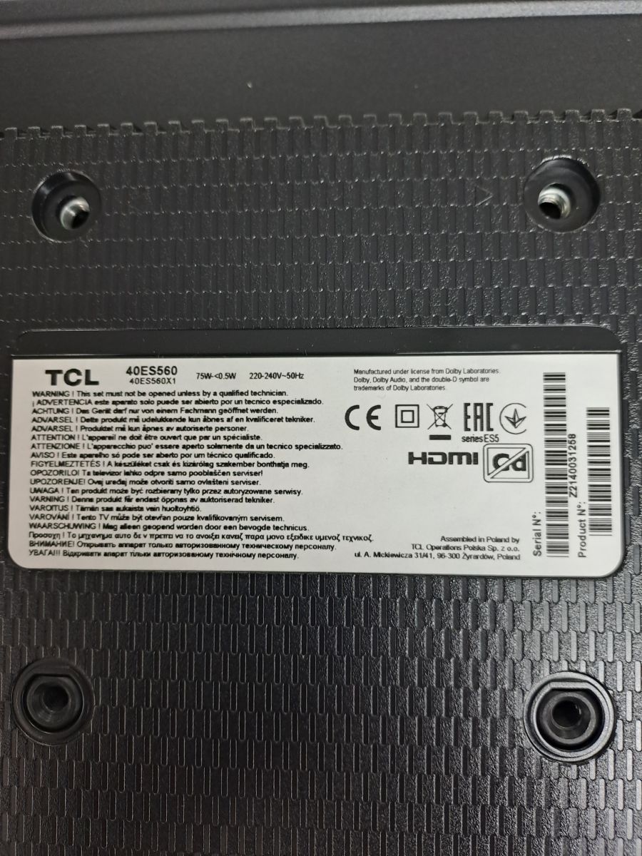

    Good evening, once again I come to ask for help; TV software TCL 40ES560X1 chassis V8-R41KT01-LF
    thanks

    Good afternoon, the 374 and 383 version blocks when it reaches 20% of the end and with this one the 391 gives an error at the beginning along with the photo of the back of the TV Nameplate of TCL TV model 40ES560.

    Good morning. My case: I had to replace the main board.
    Access mode service: Menu, Contrast, 6425
