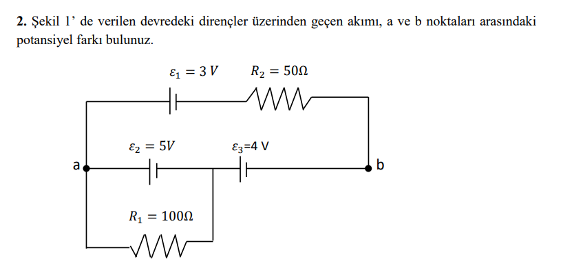

    soruyu çözermisin
    Initial assessment of available information
    The user finally provided the real problem statement:
    “Find (i) the currents through the resistors and (ii) the potential difference between points a and b for the circuit in Fig-1”, where
    • ε₁ = 3 V, ε₂ = 5 V, ε₃ = 4 V
    • R₁ = 100 Ω (between nodes a and the junction of ε₂–ε₃)
    • R₂ = 50 Ω (top branch, in series with ε₁)
    All sample answers simply asked the user to supply the question; none of them solved it.
    There is therefore no conflict between online/off-line answers that needs reconciliation. A complete technical solution is required.
    Direct answer to the question
    Assuming the batteries are oriented with their positive plates toward the right (i.e. each ε raises the potential as we move from left → right):
    1. Current through R₁
    I₁ = (E₂) ⁄ R₁ = 5 V ⁄ 100 Ω = 0.050 A (50 mA) flowing from the ε₂–ε₃ junction toward node a.
    2. Current through R₂
    I₂ = (E₂ + E₃ – E₁) ⁄ R₂ = (5 V + 4 V – 3 V) ⁄ 50 Ω = 6 V ⁄ 50 Ω = 0.12 A (120 mA) flowing from node b toward node a through R₂.
    3. Potential difference between a and b
    V_ab ≡ V(a) – V(b) = –(E₂ + E₃) = –9 V.
    Hence node b is 9 V higher than node a (|V_ba| = 9 V).
    Detailed problem analysis
    1. Node assignment
    • Node a: reference (V_a = 0 V)
    • Node 2: junction between ε₂ and ε₃ (V₂)
    • Node b: right-hand end of ε₃ and R₂ (V_b)
    • Node t: top of ε₁ / left of R₂ (V_t)
    2. Express node voltages from source orientations
    V₂ = V_a + ε₂ = 0 + 5 = 5 V
    V_b = V₂ + ε₃ = 5 + 4 = 9 V
    V_t = V_a + ε₁ = 0 + 3 = 3 V
    3. Currents (passive sign convention, positive from left to right or from the first-named node to the second):
    I₁ = (V_a – V₂) ⁄ R₁ = (0 – 5) ⁄ 100 = –0.05 A ⇒ 50 mA from node 2 to node a.
    I₂ = (V_t – V_b) ⁄ R₂ = (3 – 9) ⁄ 50 = –0.12 A ⇒ 120 mA from node b to node t to node a (opposite the assumed positive direction).
    4. Potential difference
    V_ab = V_a – V_b = 0 – 9 = –9 V.
    5. Power check (optional sanity-test)
    Total power delivered by sources equals total power dissipated in resistors:
    P_R1 = I₁²R₁ = (0.05)²·100 = 0.25 W
    P_R2 = I₂²R₂ = (0.12)²·50 ≈ 0.72 W
    ΣP_R ≈ 0.97 W.
    Source powers (taking delivery positive when supplying power):
    P_ε₁ = ε₁·(–I₂) = 3·0.12 = 0.36 W (absorbing)
    P_ε₂ = ε₂·I₁ = 5·0.05 = 0.25 W (delivering)
    P_ε₃ = ε₃·(–I₂) = 4·0.12 = 0.48 W (absorbing)
    ΣP_sources = –0.97 W (equal in magnitude to ΣP_R). The energy balance confirms the calculation.
