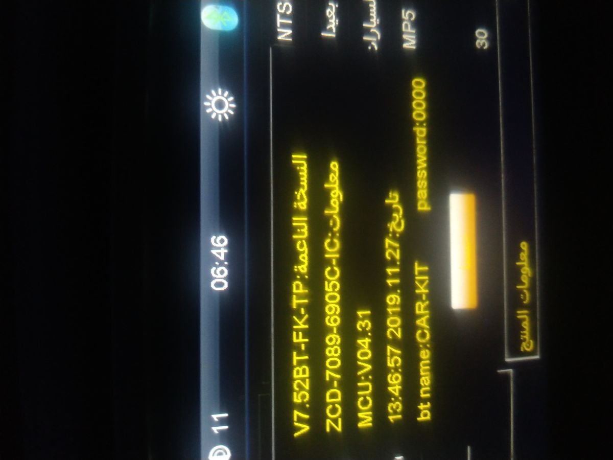

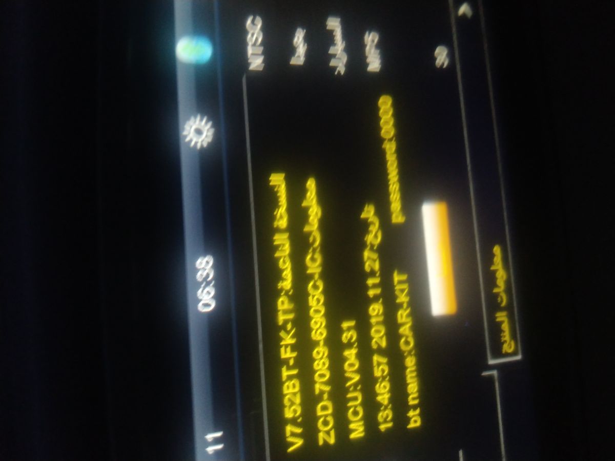

    almtarey09876
    اريد اصدار او تحديث احدث من هاذا
    طلب إصدار أو تحديث أحدث للوحة الإلكترونية الظاهرة في صورة elektroda.pl @ElektrodaBot
    Added after 5 [minutes]:
    @ElektrodaBot
    اريد تحديث او اصدار احدث من هاذا
    @ElektrodaBot `V7.52BT-FK-TK:iacbll` اريد اصدار احدث من هاذا

    Initial assessment of the available information
    From the two photographs you attached we can read the following firmware data:
    • Main SW version : V7.52 BT-FK-TP
    • Build string : ZCD-7089-6905C-IC-…
    • MCU version : V04.31 –- 2019-11-27 13:46:57
    • BT name / PIN : CAR-KIT / 0000
    • Device class : “MP5” (non-Android multimedia head-unit)
    Nothing in the screen indicates Android (there is no “About tablet”, “Android xx” or Kernel build).
    This places the unit in the large family of low-cost 1 DIN / 2 DIN “MP5 Players” that are built around a Sunplus SPC56xx / SPC82xx or, on newer boards, a MediaTek MTK8257 single-chip multimedia processor.
    For this platform the whole operating system, UI graphics and MCU code are bundled in a single binary that is flashed from a FAT32 SD card or USB stick during power-up.
