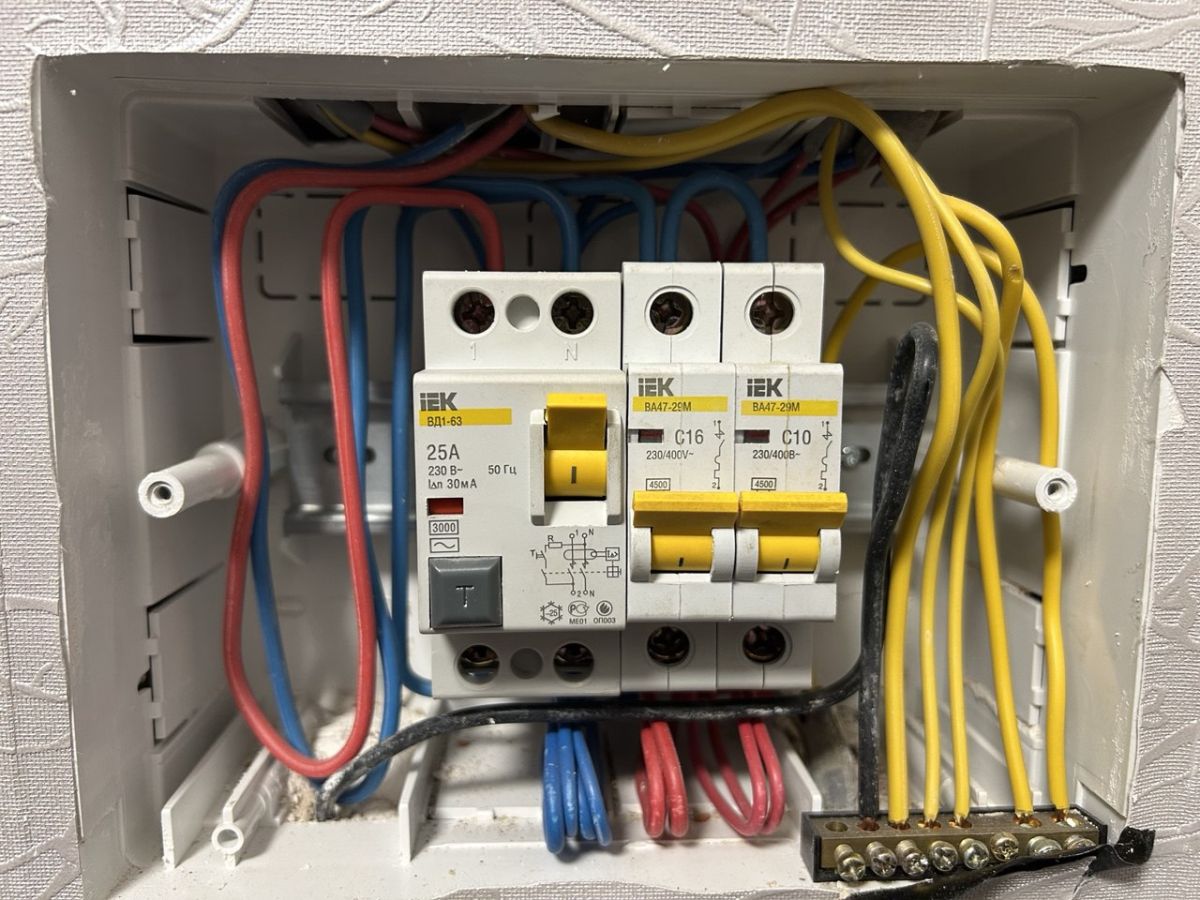

    Доброго дня. Як у цю щитову додати 3-х позиційне реле вводу резерва
    Electrical distribution box with IEK circuit breakers and wiring

    Initial assessment of available information
    - Your board (photo) is single‑phase, DIN‑mounted, with:
    - 1 two‑pole RCD (IEK, 25 A, 30 mA) as the incomer.
    - 2 single‑pole MCBs (C16 and C10) as outgoing feeders.
    - Separate busbars for neutral and (apparently) protective conductors.
    - You want to add a three‑position reserve input device (I–0–II), i.e., a manual transfer switch or motorized ATS, often called “реле вводу резерву / АВР”.
    Core point: in this layout the transfer device must be installed upstream of the RCD so that the RCD continues to protect all loads irrespective of the source.
    Direct answer to the question
    - Insert a 2‑pole, break‑before‑make, I–0–II transfer switch (manual or motorized) between the incoming sources (Grid and Reserve) and the existing RCD. Switch both Phase and Neutral; do not switch PE.
    - Minimum rating: 230 V AC, ≥40 A, utilization category AC‑22A (mixed resistive/inductive), with mechanical interlock inherent to I–0–II. Short‑circuit withstand must be compatible with your upstream protection.
    - Wiring (single‑phase):
    - Grid L,N → Switch “I” inputs.
    - Reserve L,N → Switch “II” inputs.
    - Switch common outputs Lout,Nout → RCD input.
    - RCD output → existing MCBs → loads.
    - All PE conductors from both sources remain permanently bonded to the PE bar.

    1. Why 2‑pole switching is mandatory
    - With a generator/inverter as Reserve, neutrals of Grid and Reserve must not be commoned. A 2‑pole device isolates both L and N and prevents neutral backfeed, RCD maloperation, and ground‑fault hazards. Leave PE unswitched and continuous.
    2. Device selection and ratings
    - Type: I–0–II changeover switch (manual) or motorized transfer switch (ATS). For small boards, modular DIN versions exist.
    - Current: Your incomer RCD is 25 A. Use a switch with ≥1.25× margin → 32–40 A minimum; 40 A is a pragmatic choice.
    - Category: AC‑22A or better (per IEC/EN 60947‑3), suitable for mixed loads.
    - Making/breaking: “Break‑before‑make” is mandatory; never parallel the sources.
    - Space: DIN modules typically 3–6M. Your enclosure looks tight; be prepared to add a small adjacent enclosure or replace the box with a wider one.

    8. Mechanical notes for your specific board
    - The current device row appears fully occupied. A 40 A I–0–II will likely not fit without:
    - Replacing the enclosure with a wider model, or
    - Adding a small adjacent box for the transfer switch and reserve MCB/inlet.
    - Keep wiring neat and segregated; maintain minimum bending radii and clearances around the RCD test button.

    - Color coding in your photo looks inconsistent (many yellow conductors). For clarity and safety, use standard colors: Brown/Black (L), Blue (N), Yellow‑Green (PE).
