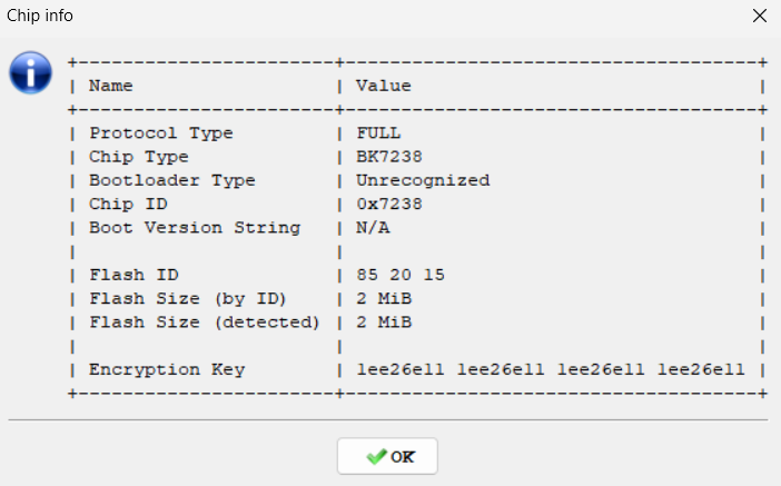

    Device https://openbekeniot.github.io/webapp/devices/Tuya_TOMZ_TOB9_63M.html
    Backup name has not been set, so output file will only contain flash type/date.
    Starting read backup and flash new!
    Now is: mercoledì 17 dicembre 2025 10:11:06.
    Flasher mode: BK7231N
    Going to open port: COM6.
    Serial port open!
    Getting bus success!
    Going to set baud rate setting (2000000)!
    Chip ID: 0x7238
    Flash MID loaded: 152085
    Flash def found! For: 152085
    Flash information: mid: 152085, icName: P25Q16HBK, manufacturer: Puya, szMem: 200000, szSR: 2, cwUnp: 0, cwEnp: 7, cwMsk: 407C, sb: 2, lb: 5, cwdRd: 05-35-FF-FF, cwdWr: 01-31-FF-FF
    Flash size is 2MB
    sr: 7c
    sr: 7c
    final sr: 7c
    msk: 407c
    cw: 0, sb: 2, lb: 5
    bfd: 0
    sr: 0
    sr: 0
    final sr: 0
    msk: 407c
    cw: 0, sb: 2, lb: 5
    bfd: 0
    Going to read encryption key...
    Encryption key read done!
    Encryption key: 1ee26e11 1ee26e11 1ee26e11 1ee26e11
    WARNING! Non-standard encryption key!
    If it's all zero, it may also mean that read is disabled.
    Please report to forum https://www.elektroda.com/rtvforum/forum51.html
    Or just try using BK7231M mode
    Going to start reading at offset 0x00...
    Reading 0x00... failed with serial.BytesToRead 0 (expected 4111)
    The beginning of buffer in UART contains  data.
    With itchiptool:
    Unknown bootloader CRC - 0xF42F8C32 - please report this on GitHub issues!
    Application window showing chip info for BK7238 with 2 MiB Flash memory
    Attachments: To view the material on this forum you must be logged in.
