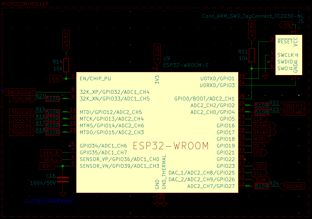

    The ESP32-WROOM-32E with a simple program works reliably when it has the serial monitor on, but when the device is running with the ESP-Prog programmer unplugged, then once in a while it stops working and resets after about 3 seconds coming back to life.
    This causes me to be unable to read the reason for the reset.
    How to approach such an issue?
    I have ruled out the power supply by substituting a workshop power supply as the source.
    The program sends 64 bits every second with one MOSI pin via SPI at 8MHz. It is not receiving anything.
    Doesn't help:
    -lowering fCLK
    -unplugging the pre and post transfer callback
    -replacing spi_device_polling_transmit() with spi_device_queue_trans()
    -addition of spi_device_acquire_bus() and spi_device_release_bus()
    -inserting a 1ms delay just before spi_send()
    Helps:
    -enabling serial monitor
    ESP32-WROOM-E schematic showing power, RESET, EN, and GPIO connections
