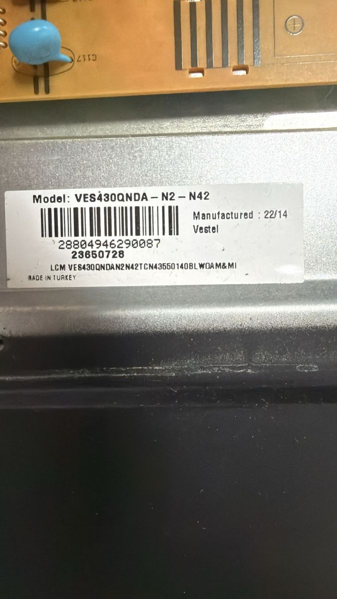

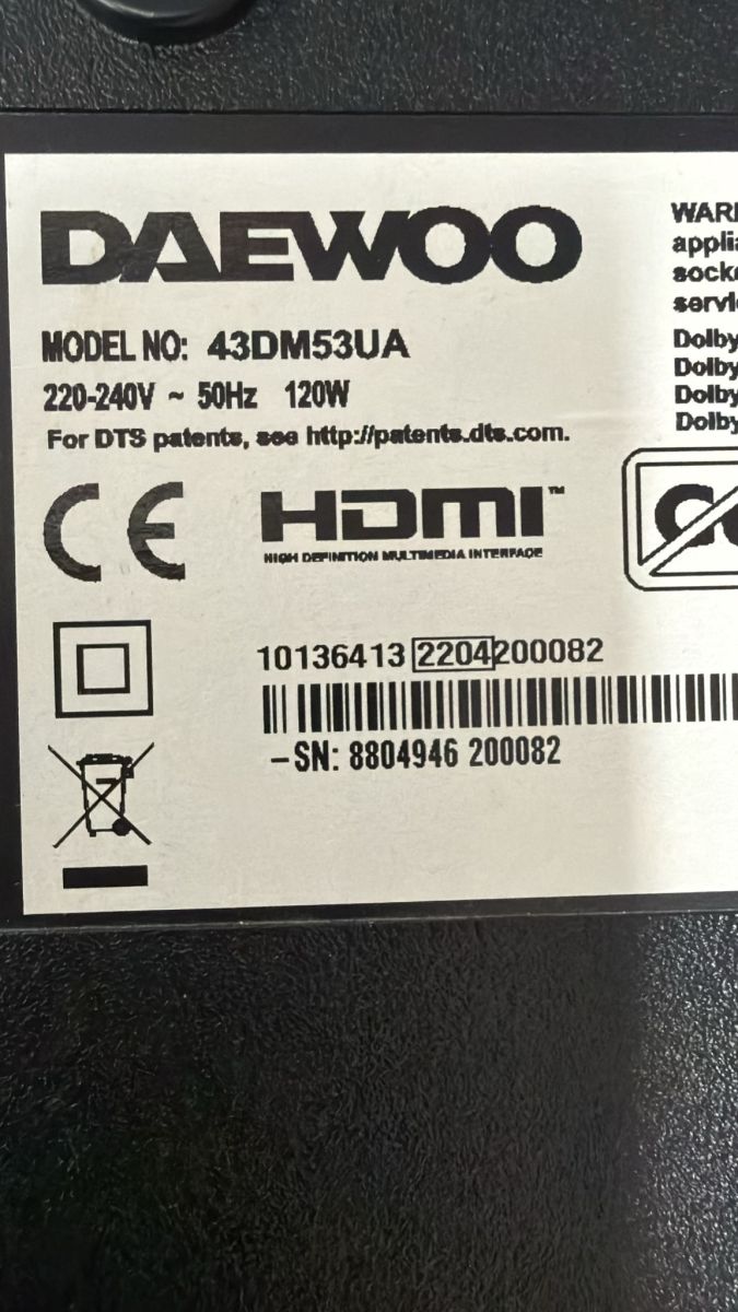

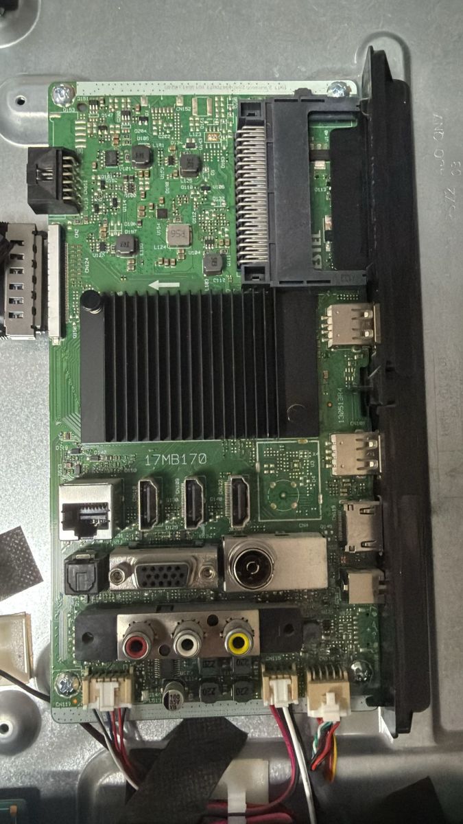

    photo of the sticker on the back: product code and serial number required
  • #3 21875191
    CHIKY
    text
    ok, te paso información con las etiquetas de la TV, gracias
    Barcode label on a metal housing showing model VES430QNDA‑N2‑N42 and Vestel.
    TV mainboard with heatsink and ports: HDMI, VGA, antenna, USB, and RCA connectors
    Daewoo TV label showing model 43DM53UA, power specs, compliance marks, and barcodes.

    After you posted the pictures, I noticed that it has a different type of panel: VES430QNDA-N2-N42. If my colleague billobirillo doesn't have what you need, I have this in my archive: 17MB170 panel VES430QNDA-N2-N42 F&U

    cause the software is from a Toshiba, it will work with only one difference: the bootlogo will change in Toshiba
    @yokoono51
    I also have the software from the F&U FLA4320UH (17MB170/VES430QNDA-N2-N42), but the tcon is different, T430QVN03.B instead of T430QVN03.B ALCW
    I tryed the software from the F&U on the Toshiba, but I had a splitted image, with this software the image is ok
    also the tcon is important, not only the panel code
