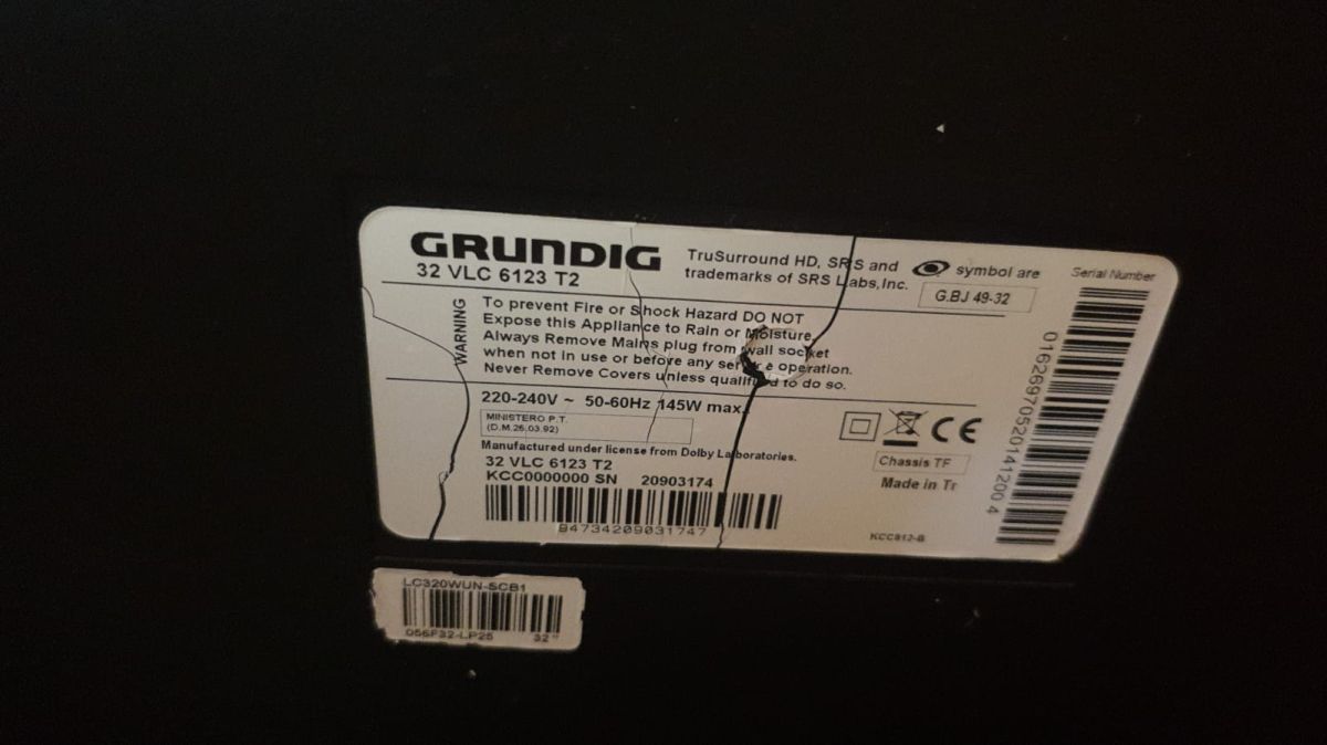

    I am looking for the latest firmware to flash/recover a Grundig TV via USB.
    The TV details from the back sticker label are as follows:
    Model: 32 VLC 6123 T2
    Product Code: G.BJ 49-32
    Chassis: Chassis TF (TF-1)
    Panel Sticker: LC320WUN-SCB1
    Panel Code: 056F32-LP25 32"
    If anyone has the correct software dump or USB install package (the Target folder/files) matching this specific product code and LG panel combination, could you please share it?
    Thank you in advance for your help!

    Please post a photo of the back label so that the serial number is visible.
    • Where to download Grundig 32 VLC 6123 T2 firmware USB for Chassis TF? large_item_503884_073e45ddda.JPG (397.71 KB) You must be logged in to download this attachment.

    >>21928489
    Product label on a Grundig TV, model 32 VLC 6123 T2, with barcodes on a black casing
    Here you go.
