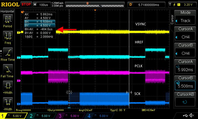

According to OV7670 camera documentation the module is powered by 3.3V, when connecting to Arduino 5V, take care of the conversion of voltage levels. The module has SIO_C, SIO_D pins, which are an SCCB bus with operation similar to I2C, a serial bus used in the camera configuration. The module responds to the I2C bus at the address 0x21. Inputs RESET (high state, camera operation) and PWDOWN (low state, normal operation). XCLK clock signal input and PCLK output for synchronous data download from the parallel 8-bit D7-D0 bus. HREF and VSYNC outputs synchronizing data download from the parallel bus (the appropriate configuration allows to resign from the HREF signal - line signal, using only VSYNC - frame synchronization).
The basis for starting the module is the appropriate configuration of registers via the SCCB bus. SCCB interface lines should be pulled up to + power supply with resistors 4.7-10kom. It is important that the camera module has a stable 3.3V power supply. For the bus to work properly, give a clock signal to the XCLK input, according to of the application note, the frequency of the input signal should be 10-48MHz (I checked experimentally that with the input frequency at XCLK = 4MHz the SCCB interface responds correctly). The code under test generated the clock frequency XCLK = 8MHz. The frequency of the PCLK signal clocking the data changes on the D7-D0 lines (data should be read on the rising edge) depends on the set dividers and PLL. In the case of the tested code, we get a clock with a frequency of 2MHz on PCLK.
The time interval between VSYNC pulses (interval between frames) is 100ms, i.e. we have ~ 10FPS:
The interval between HREF pulses (one line) is about 800us:
The transmission time of one line from OV7670 is ~ 156us, the transmission is accompanied by a high state on the HREF line and a clock signal on the PCLK line:
Between successive transmissions of the OV7670 line, the data is sent to the TFT display via the SPI bus, accompanied by a clock signal on the SCK line, the transmission lasts ~ 484us:
