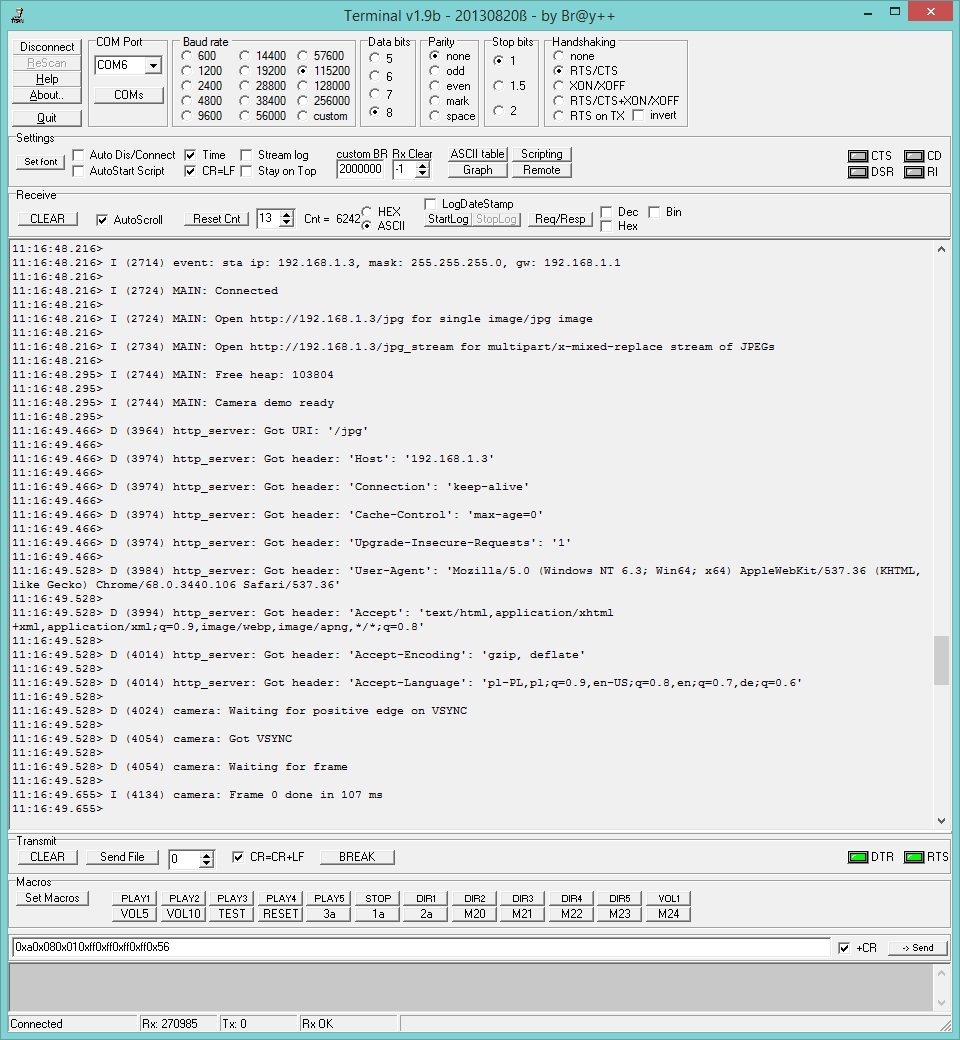

    It took me a while to get everything together (especially to find a working ESP program).
    After programming ESP32 in the command line, we get a message about the correct activation of the camera and connection to the network, which confirms the IP assignment and the ESP32 viewing links:
    OV7670 camera module, commissioning, tests with Arduino
    After copying the address and pasting into the browser, we get a photo and information about the connection and the frame reading time:
    OV7670 camera module, commissioning, tests with Arduino OV7670 camera module, commissioning, tests with Arduino
    When we copy the link with the stream, we get a fairly good image (unfortunately recorded with an external program because I do not remember exactly how I saved / played it). Film taken against the light because I have nowhere to point the camera. General mess and designs that I can't show. I just want to show what the movement in the camera looks like:
    [movie: 628932103b] https://filmy.elektroda.pl/35_1535189875.mp4 [/ movie: 628932103b]
    And frame rate in streaming:
