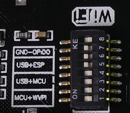

After setting the switches ESP8266 and ATmega328 can communicate using UART, similarly setting the jumpers allows you to connect the UART USB converter with the selected module for programming.
Connection of modules via UART - DIP 1 and 2 ON
USB UART connection with ATmega328 - DIP 3 and 4 ON
USB UART connection with ESP8266 - DIP 5 and 6 ON
USB UART connection with ESP8266 in programming mode (GPIO0-GND) - DIP 5 and 6 and 7 ON

It is inconvenient to switch miniature switches to change modes. It should be remembered about the difference in voltage levels between the pins of the ESP module and the Arduino.

for the duration of programming, switch to the "ON" position USB + MCU (switches 3 and 4),
for the time of cooperation between Arduino UNO and ESP8266, select the MCU + ESP (1,2) option.

for the programming time, set the switches 5,6,7 in the "ON" position,
for the duration of operation, set the switches 1,2 in the "ON" position,
if we want to observe messages on the serial terminal, in the "ON" position, set the switches 5,6 or 1,2,5,6.
