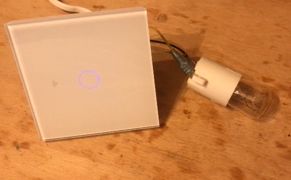

Purchase WiFi light switch SC3-01 .
I found this switch on the internet under 1/2/3 Gang WiFi Touch Switch Home Wall Light Control+ RF Touch Remote Smart Life :
It costs around $15, or just under PLN60.
It differs slightly from the switches I have previously tested - in addition to WiFi, it also offers RF433 communication:

The switch housing is made for the triple version, but in the single version only the middle relay is available:

Tasmota - relay and LED operation .
For a known device, you can simply use Tasmota's ready-made template (template). Here, however, I did not have this option. The SC3-01 from the topic does not yet have a template, so we have to configure it ourselves.
First you need to determine on which ESP pins the relay (or relays) are connected. I managed to do this experimentally - I simply set the pins one by one in Relay mode and checked which one works. Setting:
Testing:
Eventually I discovered that for the SC3-01, we have two pins available as outputs - GPIO15 and GPIO16. One is the relay and the other is the LED (which can be controlled independently of the relay, although the relay still has its own separate LED):
I show the result in the video:
Everything works, we can already control the relay and the LED, the operation of the touch button remains.
Tasmota - touch button operation .
To determine the pin on which the button is connected I used the same method as for the relay. I simply set the pins sequentially through the web panel and checked that the button responded:
I determined that the touch button was on the GPIO5 pin:
However, the device was not working as it should:
The lamp only lit up when the button was pressed. And it should be different - pressing the button should toggle the lamp state. This is because I used Switch1 instead of Button1, or actually Button1i (Button1 would result in the bulb state changing when you take your finger off the button, whereas Button1i results in the bulb state changing when the button is pressed)
After swapping this Switch setting to Button, the switch began to function fully correctly and as expected. .
