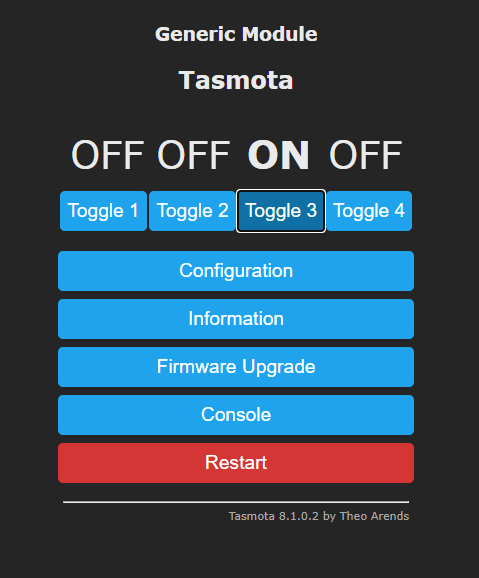

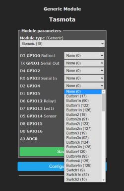

  • The switch boots Tasmota, creates a tasmota-xxxx access point, and the relay, LED, and touch button work after mapping GPIO15, GPIO16, and GPIO5.

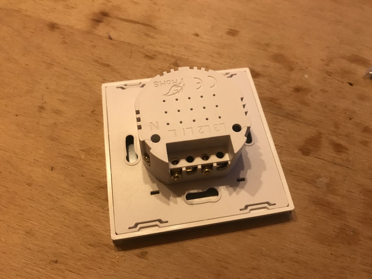

    The second plate three screws, is screwed into the socket housing:
    SC3-01 SmartLife switch and ESP firmware upload via WIFI (tuya-convert/OTA) .
    To remove it you also have to unscrew the screws from the wires:
    Then it can be removed from the inside. The whole set in parts:

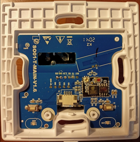

    Let's start with the front plate, the one with the touch and WiFi module:

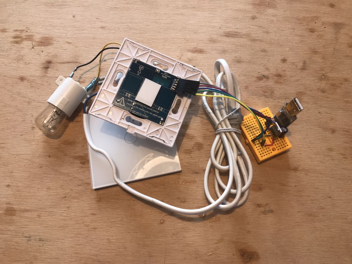

    You can see the GND, RX, TX, VCC and IO0 pins derived, which is what is needed to program the TYWE3S. This is a nice change, because with many products we have to get to these signals ourselves, whereas here you just solder 5 goldpins and you're done.
    You can of course also see the heart of the board, the TYWE3S module:

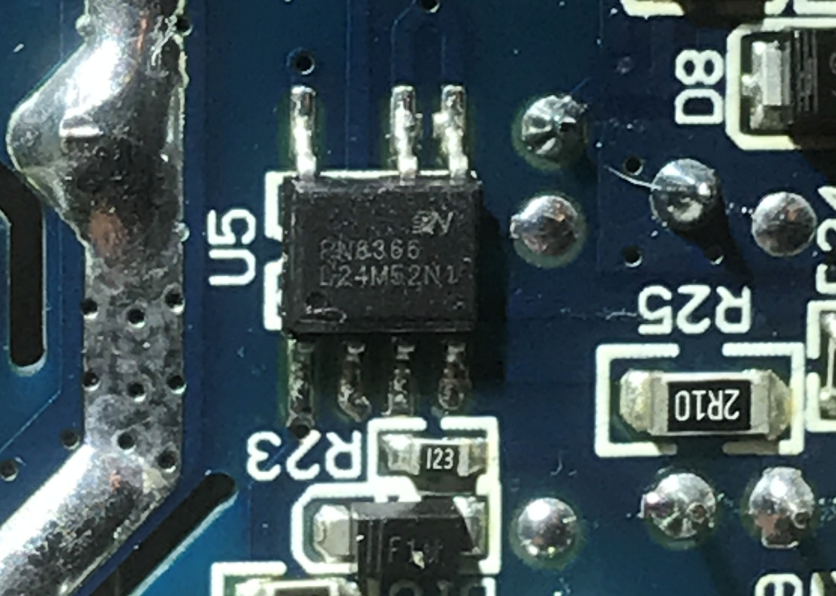

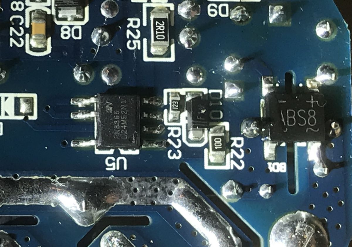

    On this board is a small switching power supply in flyback topology. It is based on the PN8366 chip:
    An example PN8366 application (the power supply here probably looks more or less like this):
    Right at the mains connection is an ABS8 rectifier bridge (800V, 0.8A):

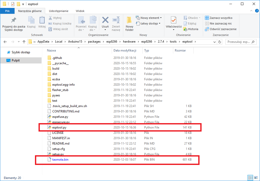

    Tuya Convert - introduction .
    Tuya Convert is a script (written in Python) that allows you to upload firmware over a WiFi network for a number of Tuya production devices, mostly based on the ESP8266.
    That is, with Tuya Convert, we don't even need to open the device's case, let alone solder anything. All we need to know is that the device is based on a Tuya module (otherwise it won't work).

    Tasmota - initial familiarisation with the web panel .
    Each Tasmota device has a web panel as shown in the image below:
    I will now tentatively discuss the options available in it.
    Information button shows us information about this device:
    This includes
    - information about the network to which the device is connected
    - information about the device itself (IP address, MAC address)
    - information about the ESP (memory size, Flash chip ID)
    - information about MQTT (I have not used it at this stage)
    - information about the Tasmota version (can also be updated via WiFi, without tuya-convert of course)
    - information on how long the device has been running since the last power-on (so-called uptime), the number of times it has been started (boot count) and even the reason for the last reboot

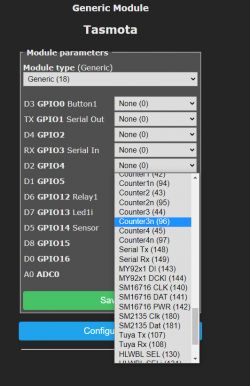

    The Configuration button allows us to configure Tasmota for our specific device. Here we specify exactly how many relays, buttons etc we have, and which ESP pins they are on:
    We can specify this ourselves or use a ready-made template. Tasmota templates are available, among others, here:
    https://templates.blakadder.com/
    The template is pasted in Configure Template:
    But developing the template yourself is not a problem either. We can freely configure pin roles on the Configure module tab :
    There are many different options to choose from, some more general and others more specialised:
    For example, Relay1 here is the first relay and Relay2 is the second relay. There are also options such as Relay1i and Relay2i, which are simply inverted outputs for the same relays. We can define for ourselves whether a high state means that the relay is switched on or off.

    For a known device, you can simply use Tasmota's ready-made template (template). Here, however, I did not have this option. The SC3-01 from the topic does not yet have a template, so we have to configure it ourselves.
    First you need to determine on which ESP pins the relay (or relays) are connected. I managed to do this experimentally - I simply set the pins one by one in Relay mode and checked which one works. Setting:
    Testing:
    Eventually I discovered that for the SC3-01, we have two pins available as outputs - GPIO15 and GPIO16. One is the relay and the other is the LED (which can be controlled independently of the relay, although the relay still has its own separate LED):
    I show the result in the video:
    Everything works, we can already control the relay and the LED, the operation of the touch button remains.

    To start, we add a goldpin connector to the pins already brought out on the front board:
    These pins are, in sequence:
    - GND (ground)
    - VCC (3.3V)
    - RX (it is connected in the case of this switch to TX from TYWE3S, so we connect RX from the adapter to it)
    - TX (this pin is connected to the RX from TYWE3S, so it is connected to the TX from the adapter)
    - IO0 (pin to enable programming mode)
    The RST pin is not brought out here, but it is not needed. We will simply replace the RESET pin with a power cut, but more on that later.

    Next you need to connect the 3.3V power supply and the USB<->UART converter. Here I used the cheapest USB TO TTL HW-597:
    I obtained the 3.3V from 5V via a TC1264 3.3V LDO regulator (but you can use any; just don't connect the TYWE3S directly to 5V from USB, it will damage it):
    I connected everything on the contact board. Additionally, I shorted the 3.3V and VDD pins on the UART converter (this means that we select the logic level at 3.3V). I connected the 5V pin from the USB UART converter to the 3.3V LDO (because 3.3V directly from the converter does not have enough current capacity). For the LDO regulator, I also connected 100nF capacitors to the input and output:
    SC3-01 SmartLife switch and ESP firmware upload via WIFI (tuya-convert/OTA) SC3-01 SmartLife switch and ESP firmware upload via WIFI (tuya-convert/OTA) .
    In this way I prepared myself a kit to upload the batch to TYWE3S:

    On the computer side, I used the esptool.py script that I installed with the ESP8266 support package for the Arduino IDE.
    https://github.com/esp8266/Arduino
    I installed the ESP8266 support in the Arduino IDE via the Boards Manager.
    After installation, esptool.py appeared in this location with me (but you guys probably have a different username):
    C:AppDataLocalArduino15.7.4 esptool .
    Esptool.py is used from the command line. We open the CMD, navigate to its location (command cd C:AppDataLocalArduino15packagesesp8266hardware2.7.4 esptools ) and then we can use it:

    Now I will still demonstrate how to upload the Tasmota firmware to it via this (I don't have to do it, but you will find it useful just in case).
    We download the latest version from:
    http://ota.tasmota.com/tasmota/release/
    We upload it loosely for convenience alongside esptool.py:
    And we do the ESP8266 programming, the procedure as I described for chip_id, but with the command esptool.py write_flash 0x0 tasmota.bin .
    Result:
    Unplug the power supply, plug it in again and thus we have a clean tasmota firmware uploaded again:
    And we're back to square one, we can now connect to the tasmota-xxxx network, set its information about our WiFi, etc. etc....

    keseszel wrote:
    Does the article say what uploading firmware gives us? Was it written to show the possibility of programming over Wi-Fi? Not to pick on you, but did you change anything by uploading the firmware? Well, and a well developed topic.
    This topic was mainly about showing the possibility of programming over WiFi and the inside of the device, but as much as changing the firmware gives us a lot, soon I want to describe how to make a more advanced system on Home Assistant, put MQTT. Some people are also interested in the topic because of the problem of privacy (if we use, for example, a Smart Life product with their application, we do not really know how much information flies to their servers and what they save) and compatibility (some devices from Blitzwolf, for example, are not compatible with Smart Life and vice versa, and after uploading their own firmware, the problem disappears).

    ...only here in turn this overlay has to be made anyway, printed, etc
    only when esp in such a module. Here it will no longer help:

  • Bonda switch uses same Tasmota GPIO settings
    #12 19198832
    oneblade
    Posts: 15
    For those looking for switches, I will share my first test purchase of the BONDA brand. I spent a long time looking for how to configure it after uploading tasmota and after two days of struggling managed to get everything working. A few minutes after commissioning I came across this topic and I see that switch clones are a dime a dozen. My model works exactly as presented in this topic, exactly the same gpio settings and that beeping for rf remote programming. I also confirm that the SwitchMode 3 setting works better than the button. Unfortunately I don't know if uploading via wifi would work because I will already use the typical soldering of cables. I made the purchase exactly here:
    Link .
    And the switch presents itself as follows:
    SC3-01 SmartLife switch and ESP firmware upload via WIFI (tuya-convert/OTA) SC3-01 SmartLife switch and ESP firmware upload via WIFI (tuya-convert/OTA) SC3-01 SmartLife switch and ESP firmware upload via WIFI (tuya-convert/OTA) SC3-01 SmartLife switch and ESP firmware upload via WIFI (tuya-convert/OTA) SC3-01 SmartLife switch and ESP firmware upload via WIFI (tuya-convert/OTA) SC3-01 SmartLife switch and ESP firmware upload via WIFI (tuya-convert/OTA) SC3-01 SmartLife switch and ESP firmware upload via WIFI (tuya-convert/OTA)
