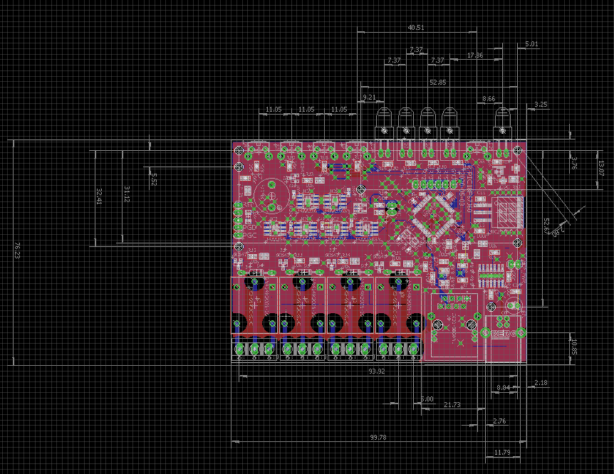

The design was done in Eagle, the dimensions are 10cm by 7.6cm. The 10cm limit is dictated by the prices in the tile mill (tiles up to 100mm by 100mm are the cheapest).
PCB Design:
(As for those strange jumpers on the board - they are given in case I want to easily connect, for example, a relay to another pin. The project was just done a bit at nights / weekends and I was not sure if everything was ok, I wanted to leave a gate for myself for easy modification)

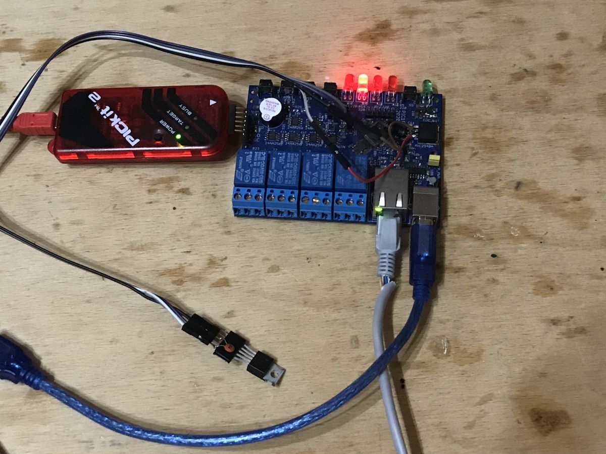

Soldering the PCB
I ordered the PCB itself in a tiling plant. I ordered 5 pieces, which is the cheapest option:
Blank PCB:
Beginning of soldering:
First functional chip - PIC, resonator, power supply, MCP2221, programming connector. At this stage, I have already checked if the PIC is working (I solder with a cheap soldering iron and I can see poorly, so I want to know at an early stage if everything is OK):
Ready Ethernet systems (communication is also already working), first relay:
Continuation of soldering (after a few months of break), delivery of KF300 3-pin connectors:
Already with a buzzer and an additional TC74A thermometer on a longer cable (one TC74A is in the SMD housing on the board, the other is in the TO220 housing on the cable):
Almost ready version, partially purged of flux:
Ready version, one phone with Tasmota Control, the other with WWW page from PIC:

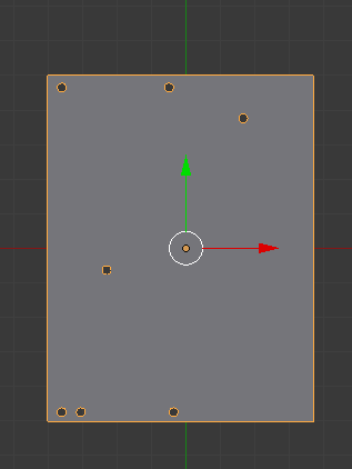

3d-printed case
I designed the housing in Blender and printed it from PLA filament on my Ender 3 PRO printer.
At the beginning, I have drawn up the more precise dimensions of the plate:
I transferred them to Blender.

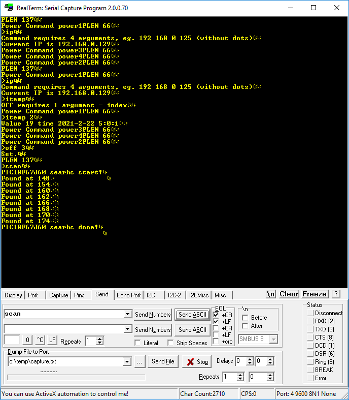

The USB UART converter MCP2221 provides the ability to configure everything without access to the LAN network and without a programmer.
After connecting to the computer with a USB cable, we get a virtual COM port:
Then it is enough to run only a UART terminal, e.g. RealTerm and you can receive logs from the device:
You can also send commands. Each command ends with CR LF characters:
Below is a shortened list of commands:
Command Arguments Short description
date / time / now lack displays the current time (regularly synchronized with the Internet via NTP)
temp lack displays the latest temperature measurements
state lack displays the status of relays
toggle index toggles the state of a given relay
off index turns off the relay
he index turns on a given relay
dhcp 0 or 1 enables or disables DHCP
ip IP address as ABCD sets static IP
ip lack displays the current IP
mask mask as ABCD sets the mask
dns IP as ABCD sets the DNS server IP
gw IP as ABCD sets the default gateway IP
mother MAC as ABCDEF sets the physical MAC address of the device
save lack saves settings in EEPROM memory
scan lack performs a scan of devices on the I2C bus and writes out their addresses
buzz lack forces a buzzer to sound for half a second
get alarm lack displays information about the set alarm (alarm clock)
EEPROM memory and I2C bus
There are 6 EEPROM chips on the board on one I2C bus.
The program automatically scans the I2C bus at system startup and lists the devices found. The memory handling code in my memory.c file supports writing and reading from these memories in two modes: single byte and full page (page read / page write). One of the memories is used to store the network configuration, alarm clock settings and the history of readings from sensors (date / time + measurement result).

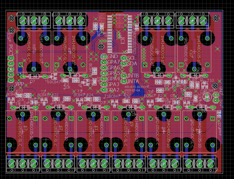

Expansion module support
An expansion module can be added to the base board (e.g. with further relays), which will be based on the I2C pin expander. Of course, this will require changing the housing, and I have not yet decided which PCB will be on the top and which on the bottom, but the PCB of the expansion module looks like this:

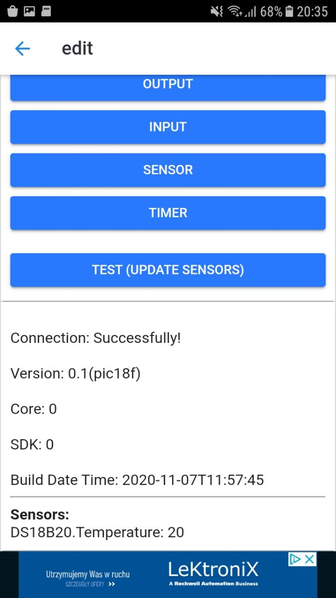

Compatibility with Tasmota Control
Since we support Tasmota HTTP, we have compatibility with the Tasmota Control application from Google Play:
In Tasmota Control, all you need to do is enter the device's bearing and the application detects it immediately:
The test passes (the way the device is identified, of course, I can specify in my code, "Build Date Time" is incorrect, entered hard, the DS18B20 is also not really DS, but TC74):

Function test (using TC74 on the PCB and soldering iron as heat source).
Before:
After:
Phone with Tasmota Control beside shown for visualization only (Tasmota Control frequently polls HA for status and HA frequently polls relay driver, so button color updates quickly).
