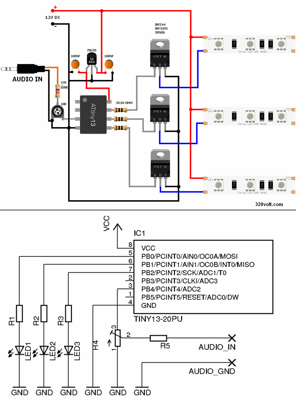

  • An ATtiny13-based music-reactive RGB LED strip syncs live music to lights with a separate microphone preamplifier.
  • A single ADC channel captures the audio signal, and DSP separates three frequency bands in real time to drive the LEDs.
  • The design proves real-time DFT on an ATtiny13 with just 64B of RAM and 1024B of FLASH memory.
  • The LEDs dance in sync with the music in the demo video.
This experimental project shows how to use ATtiny13 to sync live music and lights with just a few extra components. The design uses a single ADC (analog-to-digital converter) channel for signal acquisition and some DSP (digital signal processing) calculations that separate the three frequency bands in real time and make the LEDs dance in sync with the music. This project also proves that real-time DFT (Discrete Fourier Transformation) is possible on a small MCU like the ATtiny13, which only offers 64B of RAM and 1024B of FLASH memory.

djfarad02 02 Apr 2021 12:53
I am puzzled by the overly simplified input circuit. The potentiometer is absurdly turned on, and besides, the microcontroller input works without any DC polarization - the negative halves of the audio... [Read more]
Justyniunia 02 Apr 2021 13:25
It is not known whether PB.4 is sometimes pulled up to the plus by software, and with the potentiometer they form a divider (hence the same and no other connection of the potentiometer). R5 prevents the... [Read more]
djfarad02 02 Apr 2021 14:14
I suspected the same, but I don't see any subsets in the code. [Read more]
398216 Usunięty 02 Apr 2021 16:47
To me, it looks like the result of the work of a programmer who is not completely familiar with electronics. The potentiometer is the other way around, there is no "rectifier" at the input (since this... [Read more]

Justyniunia 02 Apr 2021 17:22
Everything you write is correct, just ... The aim of Mr. Łukasz's project was to show that it is possible to cram (as such) a fully software colorophone in such a fragile uC as Tiny13 and nothing... [Read more]
djfarad02 02 Apr 2021 17:53
It is true that the rectifier is in quotation marks, but I hope you don't mean a peak detector or a full-wave rectifier? [Read more]
398216 Usunięty 02 Apr 2021 18:01
And it was enough to read what was in parentheses ... [Read more]
djfarad02 02 Apr 2021 18:09
I was reading, I was concerned that you want to give a half-rectified signal. [Read more]

Justyniunia 02 Apr 2021 20:05
I just mean don't throw things like that into DIY. Returning to the topic, a rectifier, a capacitor (not large) + a resistor to ground on each output and such a set only controls the transistor.... [Read more]

Justyniunia 02 Apr 2021 22:59
I am proposing a diode and a capacitor on leaving then the chaff will be a little smoother and the LED flashes smoother. [Read more]
