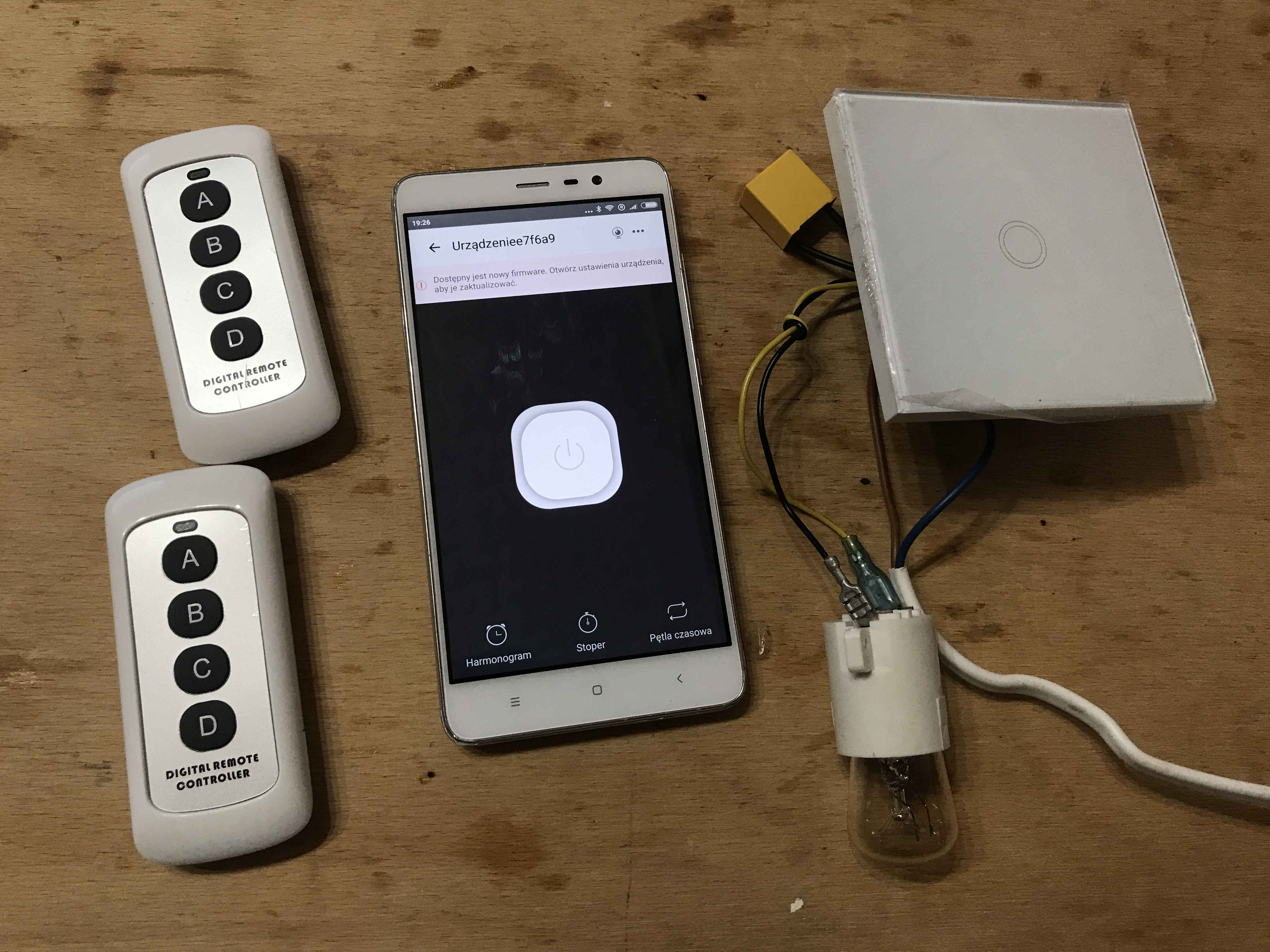

I will test and take apart here the qTouch WiFi/RF433 light switch, which is distinguished from other products of this type by the fact that it only plugs into the L wire, meaning that it will work even if we don't have an N led to the box.
I will test this switch with the eWeLink application, but then I will also upload Tasmota to it and show its pin configuration so that we can use it with our own software.
Finally, I will draw a diagram of it.

I connected everything as shown in the photo, the 'adapter' in parallel with the bulb.
("adapter" can be at the lamp near the ceiling, it does not have to be in the box next to the switch, anyway the whole idea of this switch is that if someone does not have N in the box they can use it)
The button reacts to touch:
Pairing with RF433 remote .
The RF remote control is a nice bonus quite independent of WiFi. The remote is programmable, it can learn the codes of four different switches.
You can of course also have two remotes paired to one switch, or one remote for each household member.
Pairing is very simple - hold down the touch button on the light switch until it beeps, then press the button on the remote control. Done.
A test of two remote controls:
Everything works, it's already comfortable, and we haven't started the WiFi topic yet.
