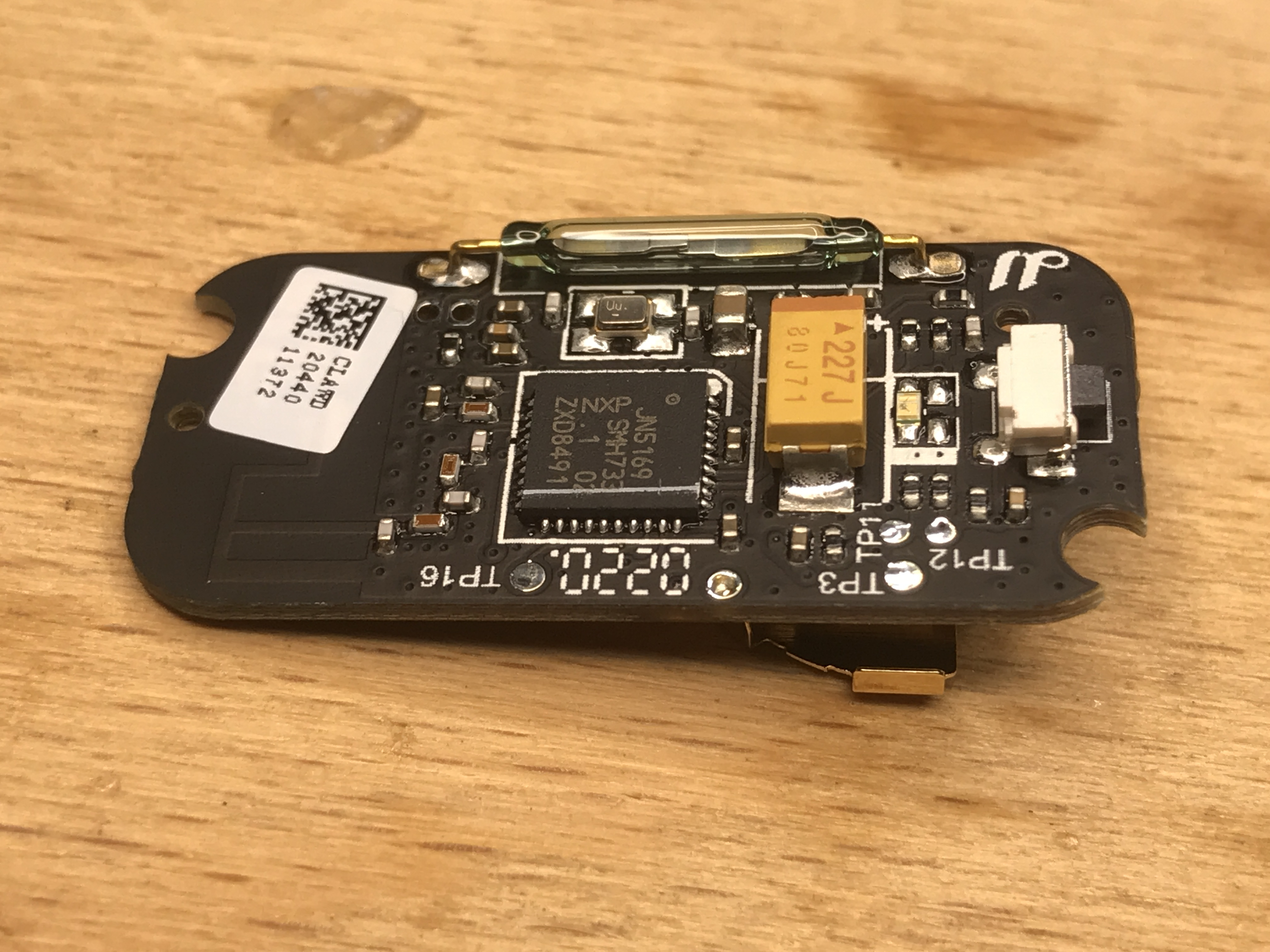

Removed PCBs:
Again, you can see a lot of test points (they probably check whether the sensor works after production, in other Aqara products I also saw them) and a programming connector.
The other side of the plate:

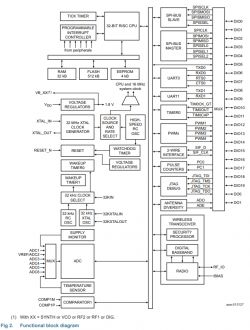

As with the rest of Aqara products, here sits JN5169 from NXP:
next to it there is also a large electrolytic capacitor with the code 227, ie 220 uF. There is also a button, there is an antenna on the board (from the path), a quartz resonator (or clock generator) for JN5169, and a characteristic sensor 'tube', which I also know from other door / window sensors:
(the photo above comes from the topic https://www.elektroda.pl/rtvforum/topic3771510.html#19211057)
