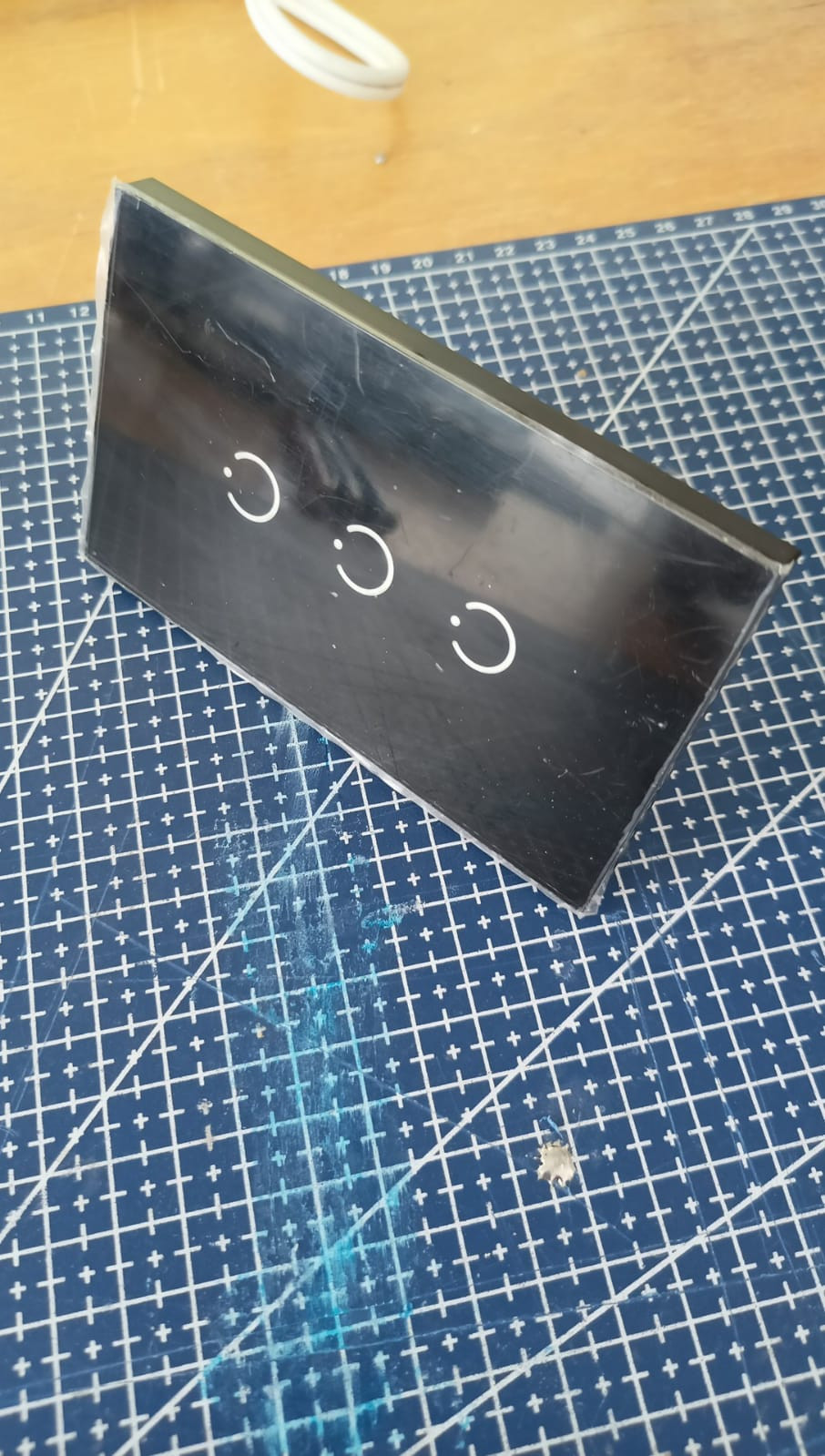

In this thread I'll explain how to re-flash this TuyaMCU smartswitch with OpenBeken and connect it to HomeAssistant. OpenBeken is an alternative, open source software for IoT devices, offering, among others independence from the manufacturer's cloud, compatibility with many ecosystems, configurability and support for various platforms, including BK7231T, BK7231N, XR809 and BL602.
For more information about OpenBK, please see: [BK7231T] My HTTP server, configurator, MQTT support from Home Assistant
For more information about BL602 support: Tasmota replacement for BL602, programming, pairing with Home Assistant.
Where to purchase the switch
The switch was bought from AliExpress by searching: ANDELI Tuya Smart Life Wifi Light Switch with Glass Panel US Standard Touch Sensor Wall Switches Voice Control Alexa Google Home However, other people refer to this switch as a MOES Switch so it's very likely that this is a dropship product and multiple brands will have the same internal components.
The voltage range of the device is 100-250V 50/60Hz and a max current of 10A. It connects to WiFi using a 2.4GHz signal.
The interior of the switch
Since it is designed to be mounted on a wall, the glass plate can be easily removed, allowing us to dissasemble it without any tools. The switch is composed of two boards, the main board: Where the TuyaMCU and the WB2S chips are located, and a daughter board, where the relays and power are located.
We are only interested on the main board.

Final test
